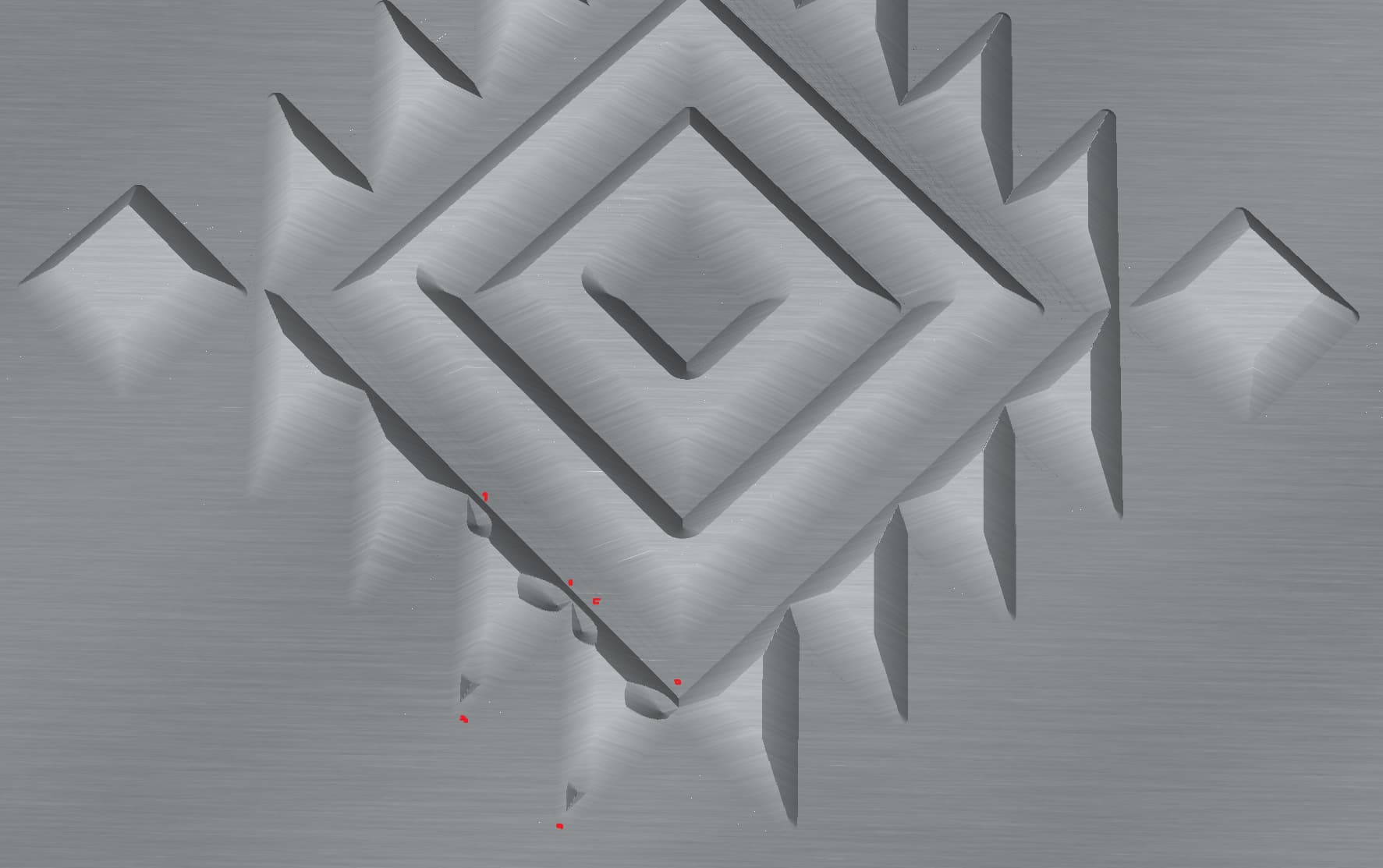

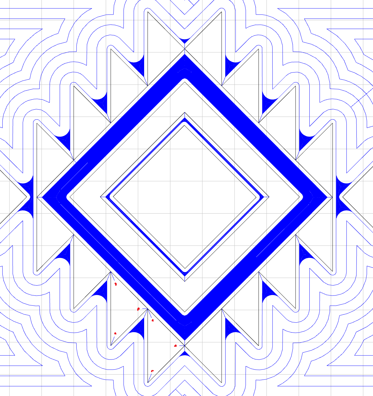

I have an inlay plug that is cutting a bit odd in a couple of places ( near red dots in images below). I did some measurements on each of the triangles that make up the design and the problem ones are slightly different than the ones that cut correctly.

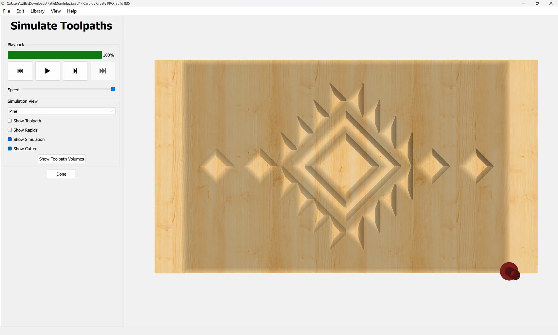

When I inspect the toolpath, I can see that there are several extra little cuts on those triangles.
Is there any way to just remove those extra little parts of the tool path?

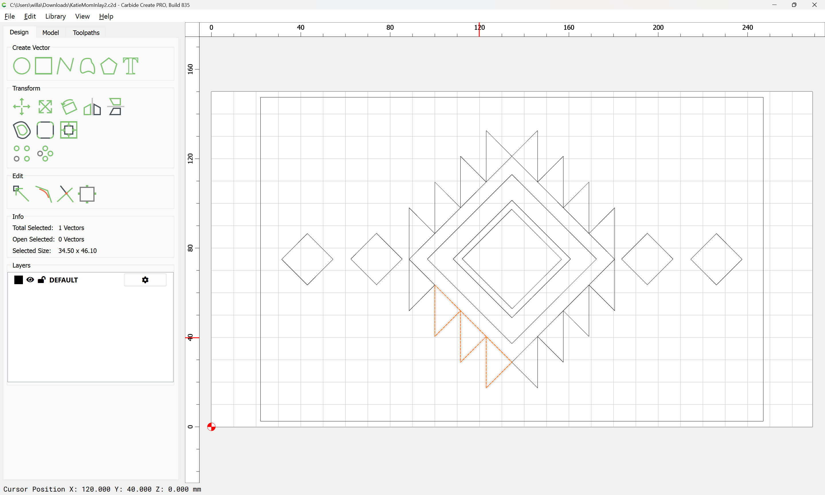

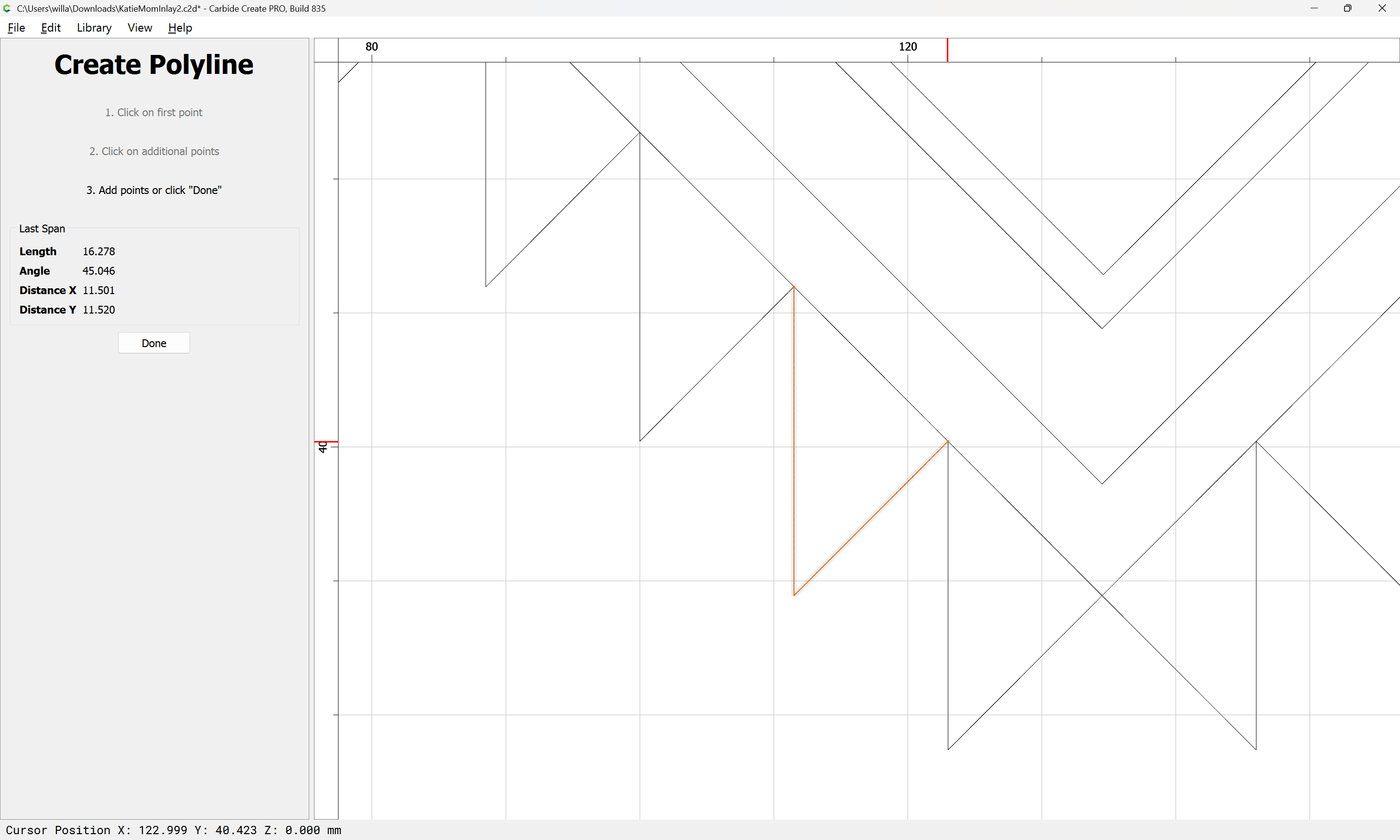

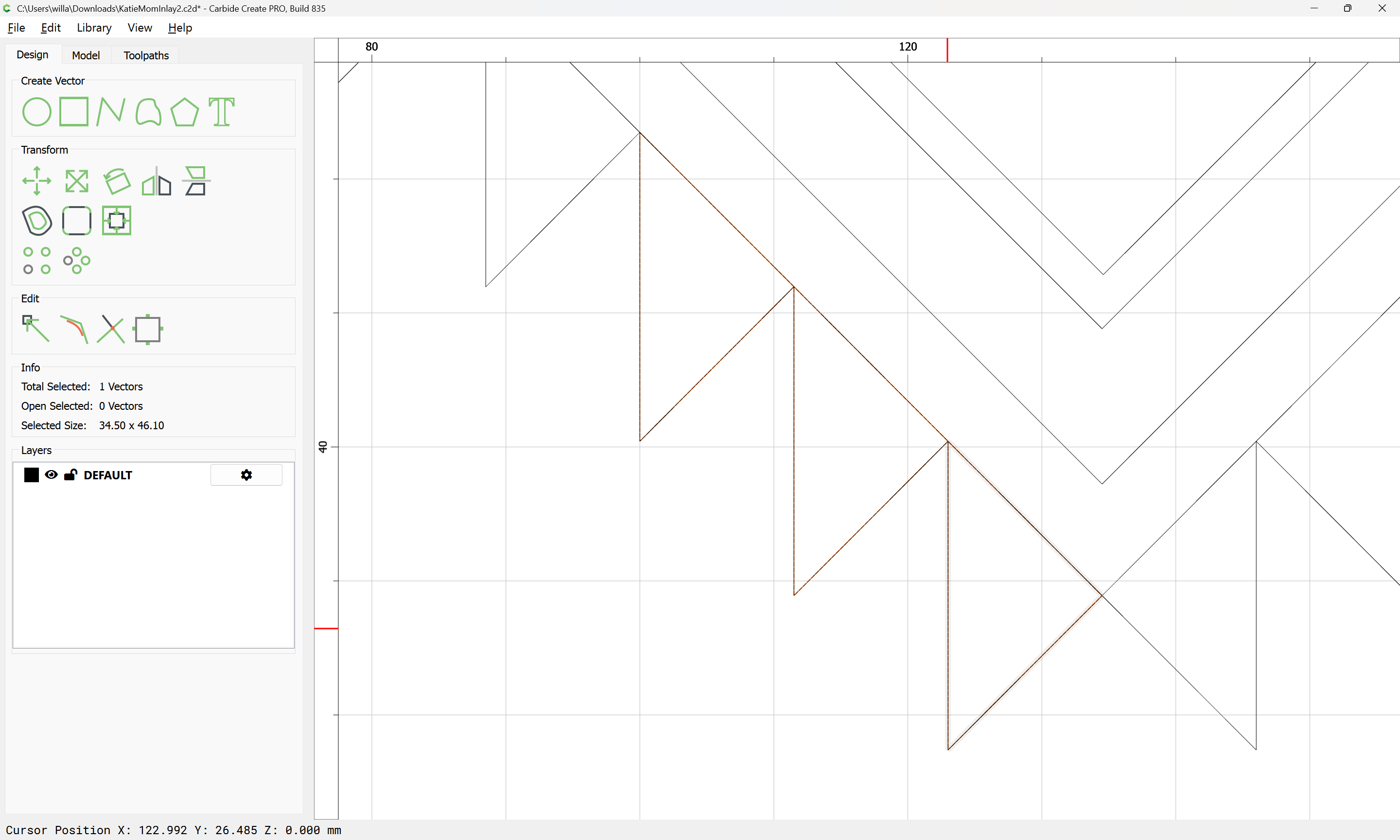

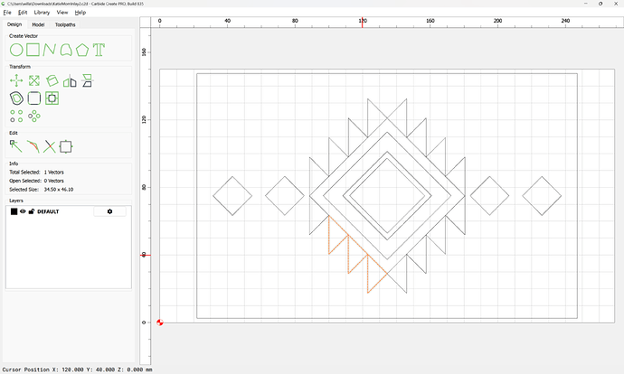

I believe the problem is the use of 1 piece of geometry:
to describe what should be 3 separate regions — re-drawing them:

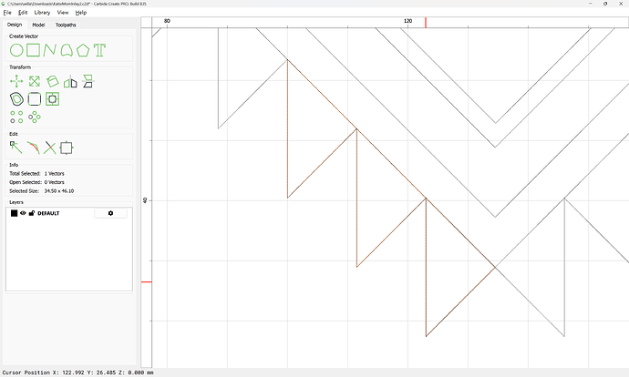

and deleting the original:
seems to address the problem:

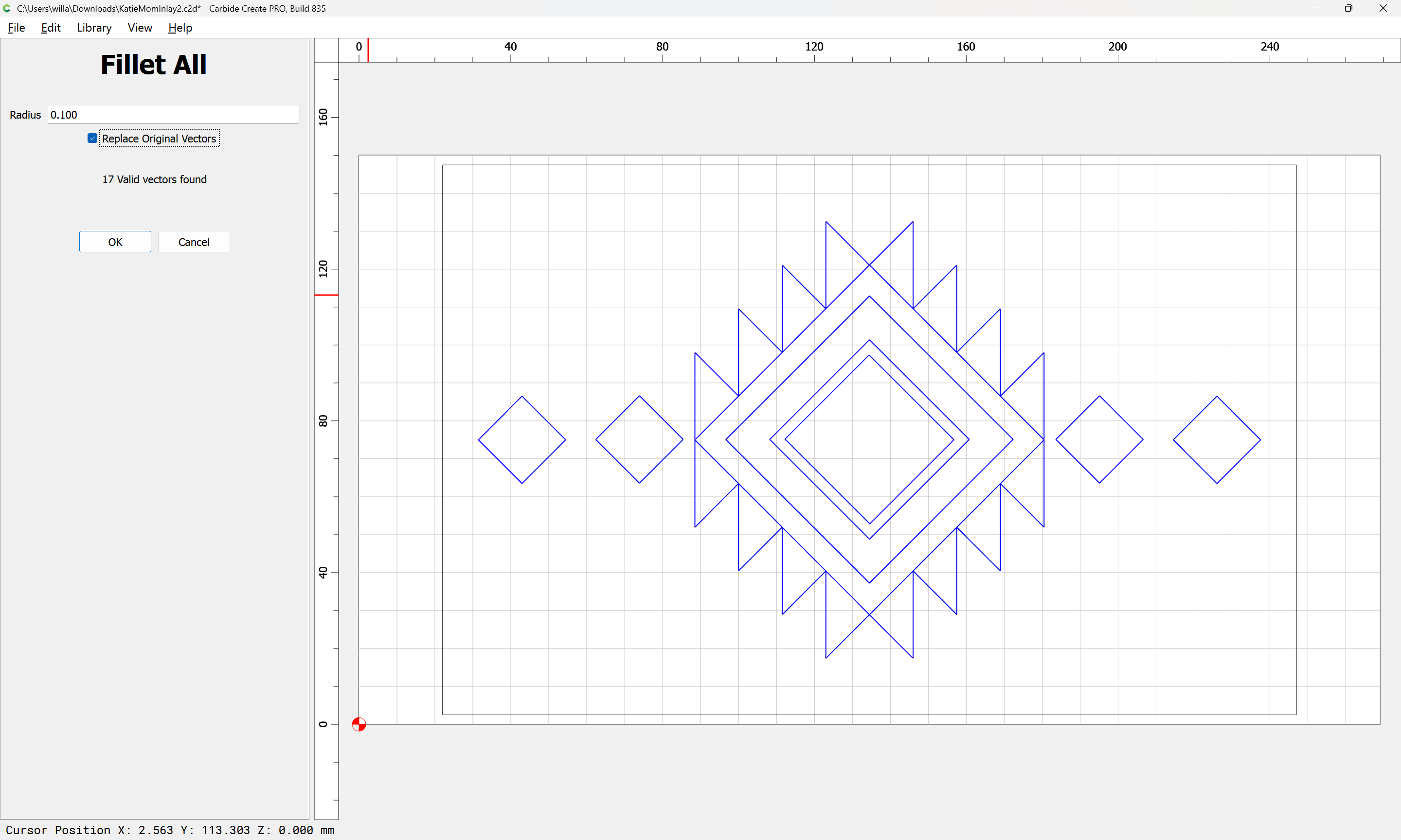

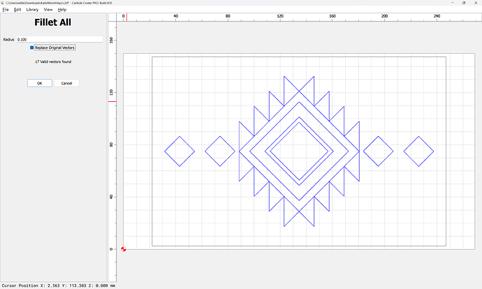

A thing to consider would be selecting everything and slightly rounding it off:
but that doesn’t seem to be necessary.

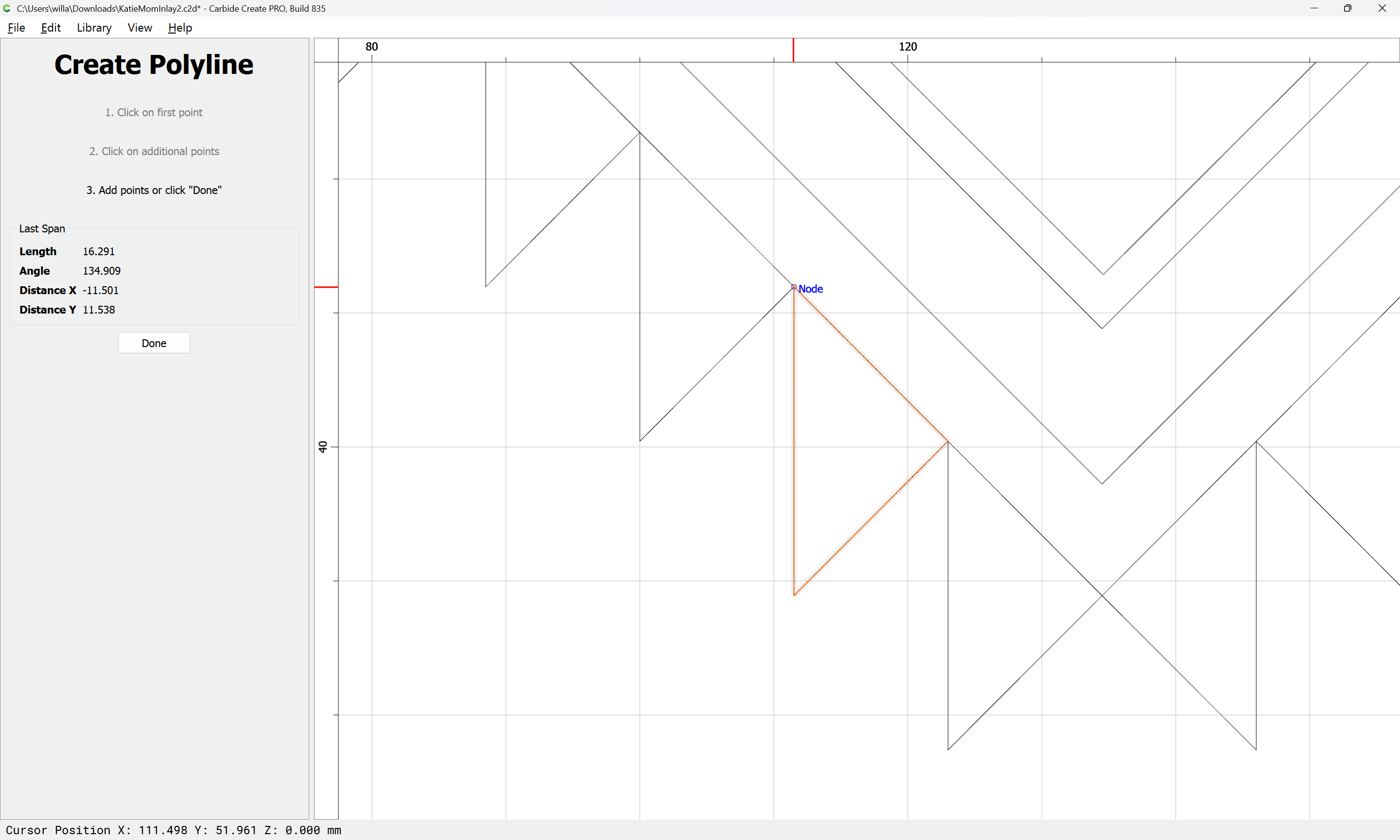

Thanks Will. I’ll try redrawing them. I’ve already cut the put for this inlay, so hopefully I can do this with out messing up the fit between the two parts.

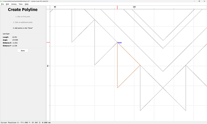

For future reference, in order to remove those extra cuts I could not simply trace those three triangles on a new layer and delete the original one piece shape. I had to ensure that when I traced them, I did not start and finish tracing them at the same node (clockwise from the top node for example). When I did that, some of the extra cuts were still there. If started my trace at a different node for each of them, it worked.
