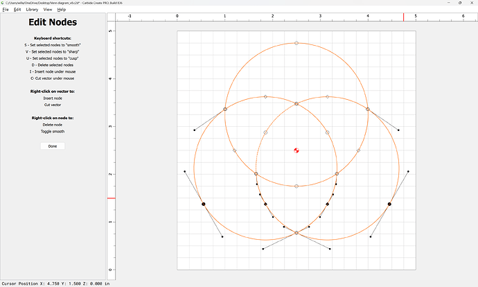

When Node Editing?
Use the shortcut d to delete the currently selected nodes as noted in the sidebar:
Folks who expect Carbide Create to function like a “normal” design program will probably be happier using a 3rd party tool such as Inkscape or Serif’s Affinity Designer (though that may depend on the announcement today), or Adobe Illustrator (for folks who can accept Adobe — I’ve been using Illustrator since v3.2 and have never found it pleasant to use), or some other vector editor.
