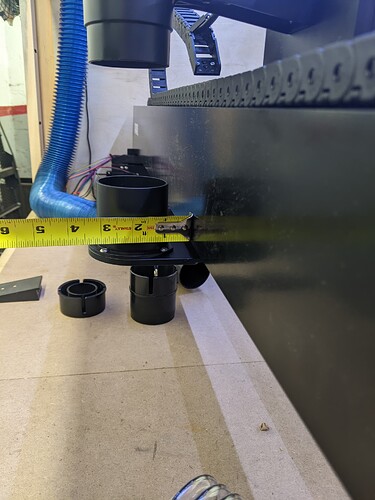

How far does the Sweepy Pro stick out from behind the gantry? I’m seriously considering one for my SO5Pro and I want to make sure I have the proper measurements for the enclosure design.
Do you think 6" behind the machine will provide suitable clearance?
My SO5 Pro Sweepy Pro just shipped today, so I should know soon. :slight_smile:
If you to take a measurement after you get yours setup I’d appreciate it!
One eye closed, lined up as best as I could, looks like 3 7/16" so let’s say 3 1/2" to be safe.
Cheers, I appreciate it, that’s very helpful!
