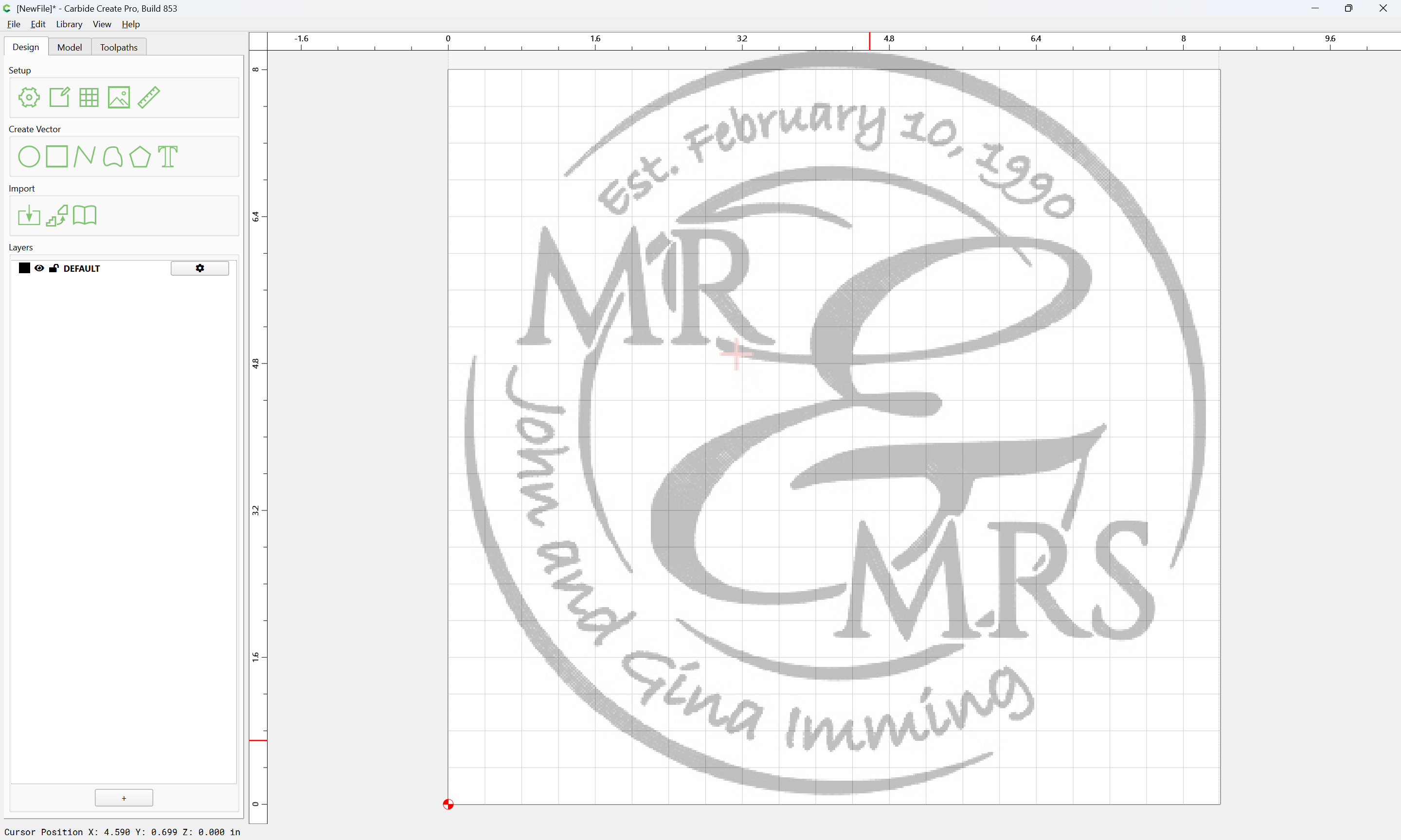

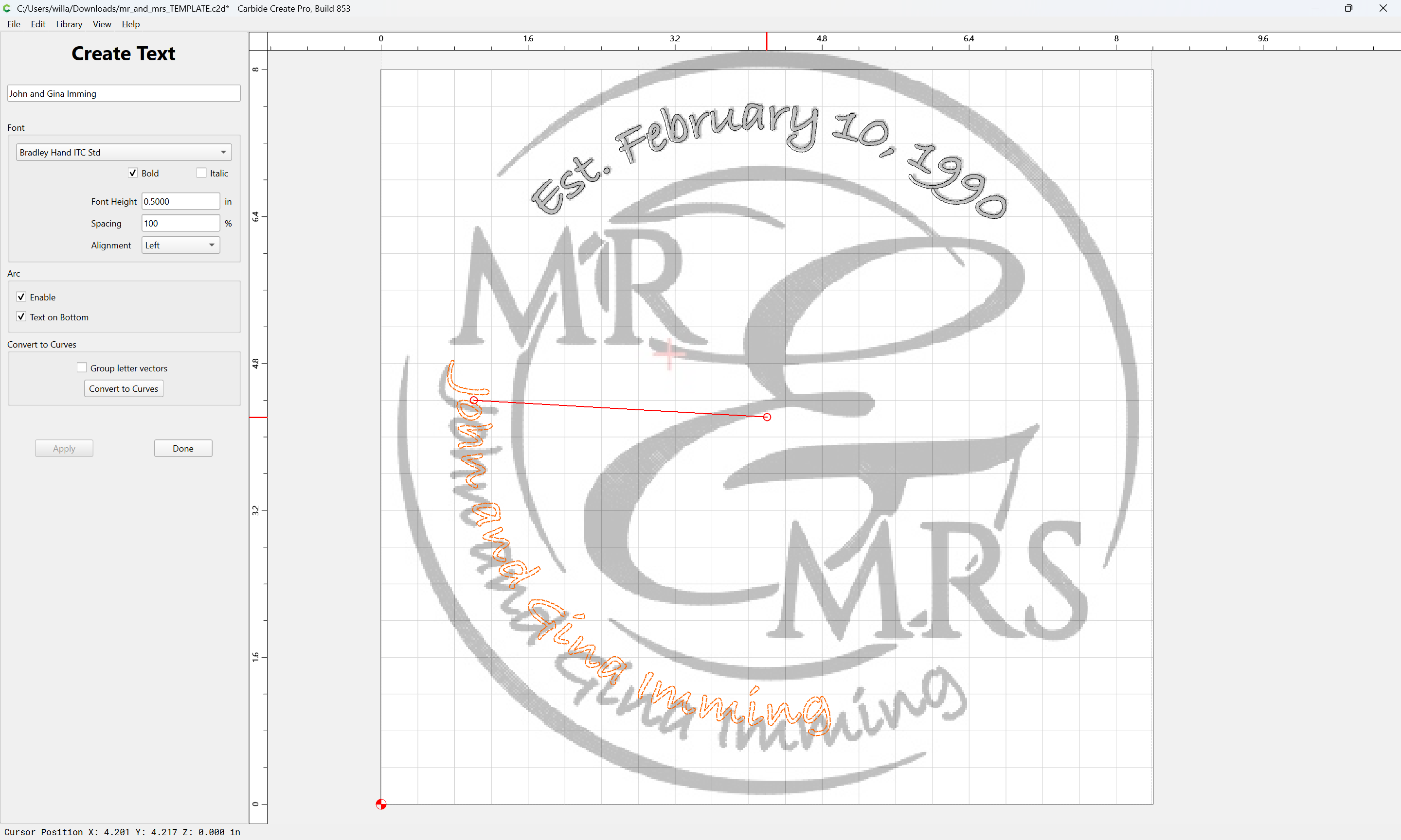

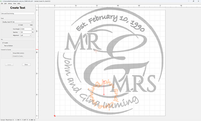

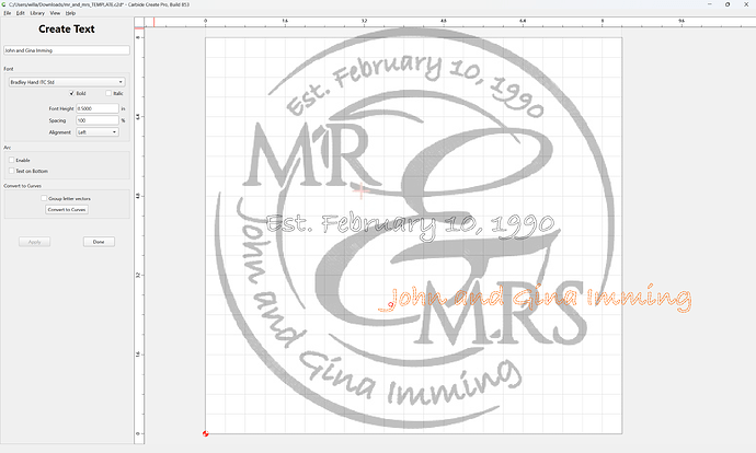

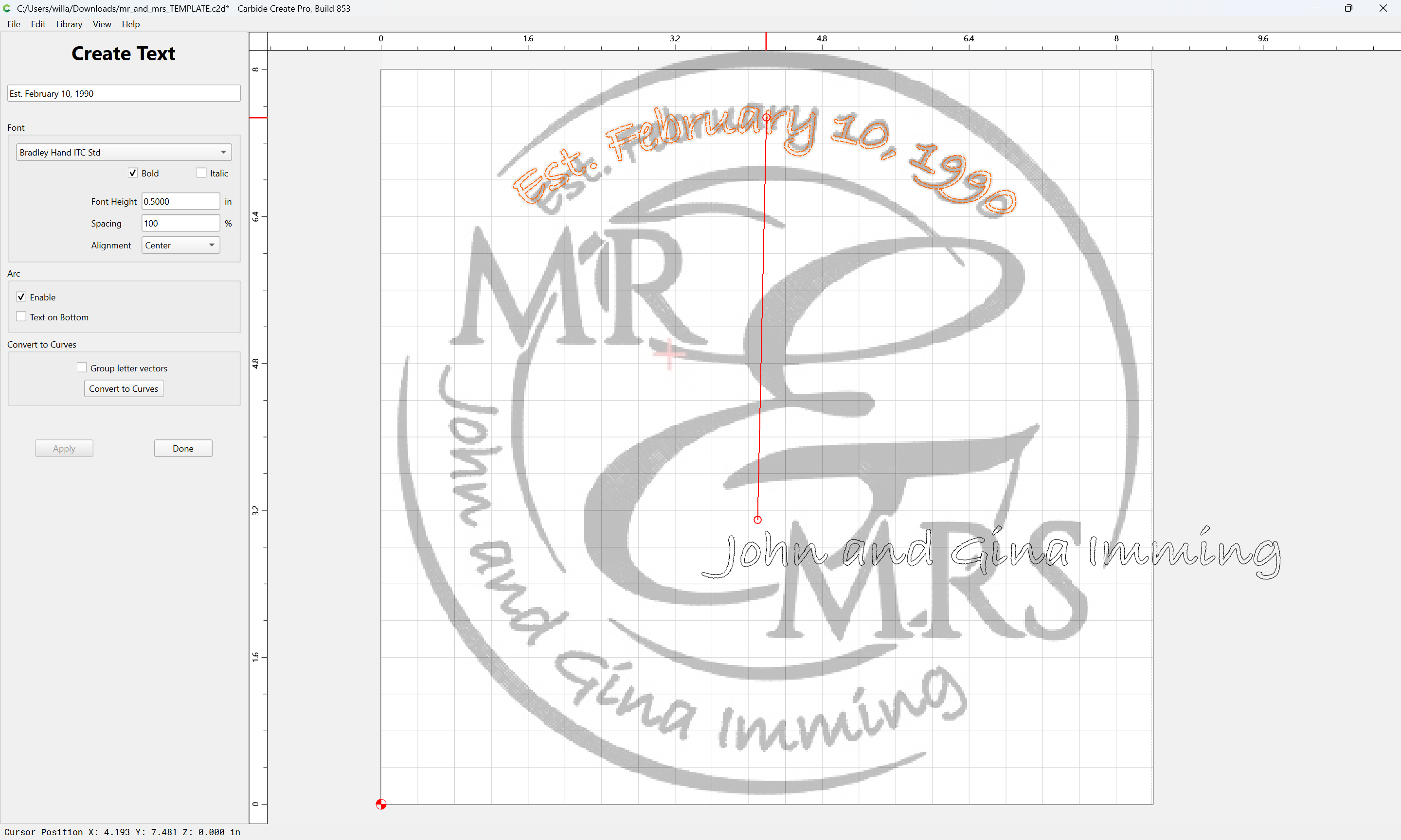

I am having trouble with wrapping the Names - … in the bottom of the design. We will be using this design and changing the date and names for each of our Customers so I really want to figure this Design out. I cannot seem to find the correct Tool in Carbide Create to arch the names the way I need it to. For some reason, I was able to manipulate the Est. and Date just fine. Is there a Tool that will allow you to grab one end of the text and arch it as needed? I found the Tool with the Red line that you can move in and out and adjust the text into a tighter circle but I can’t find the angle needed for this Design.
where the design is:
(note that it has been sized/positioned so that the center of the Stock is at the center (more-or-less) of the arched text)

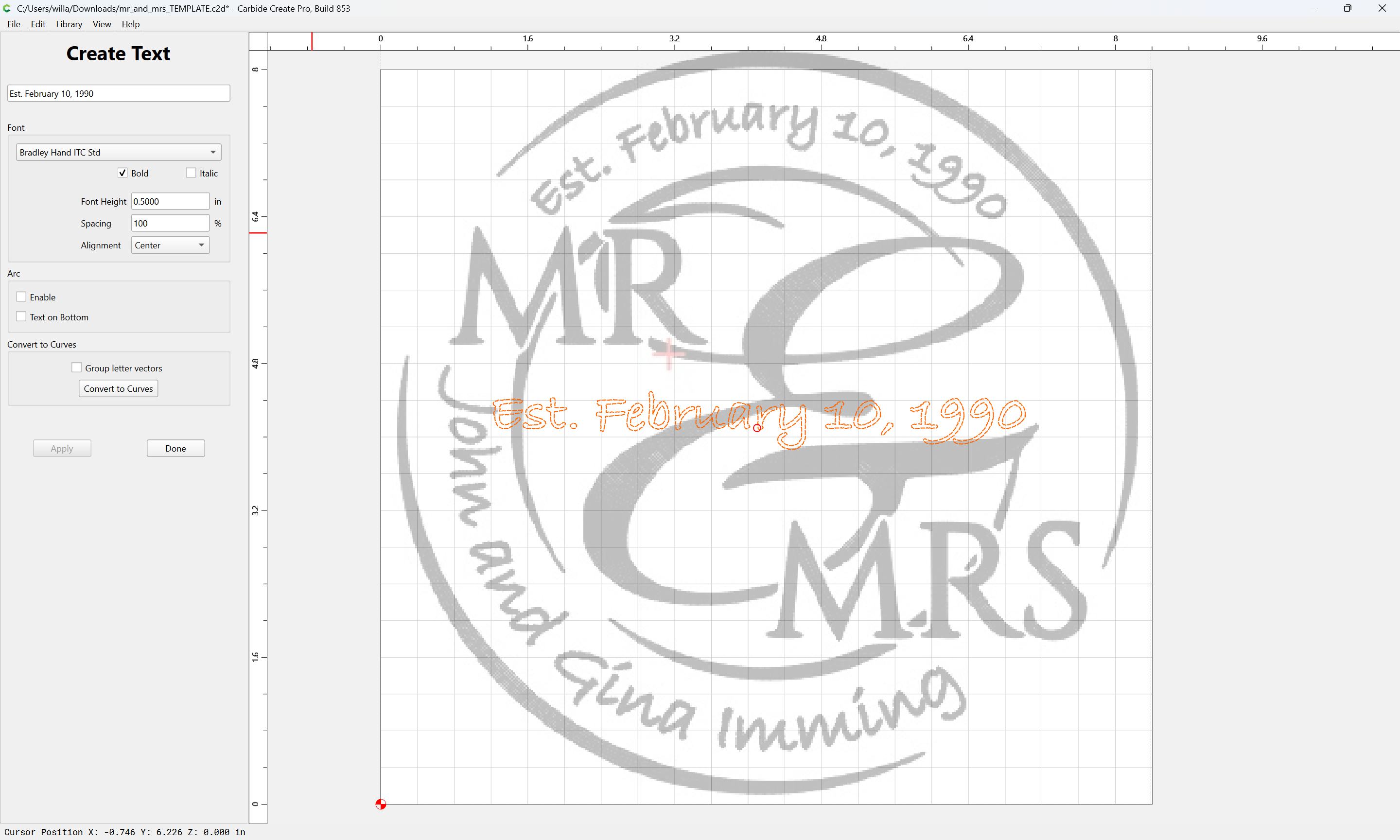

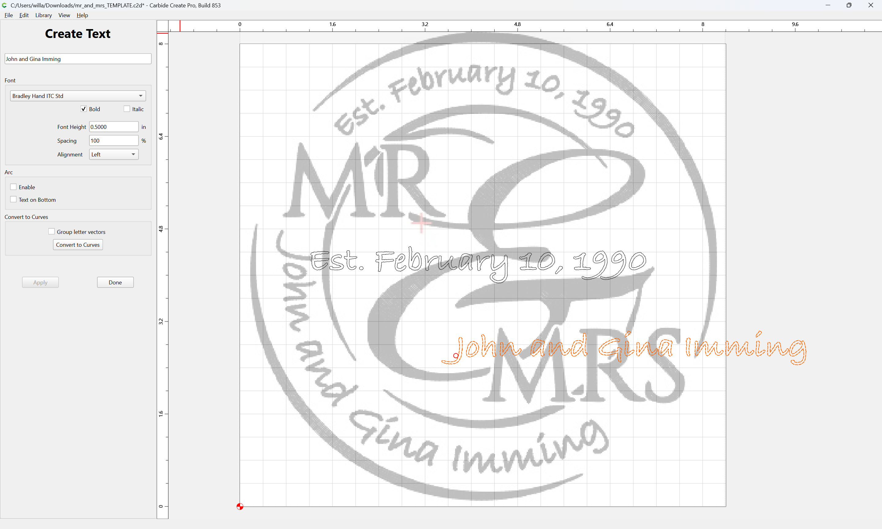

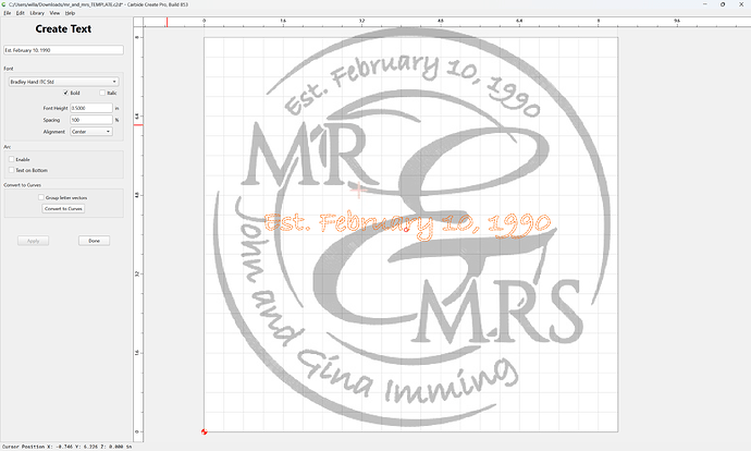

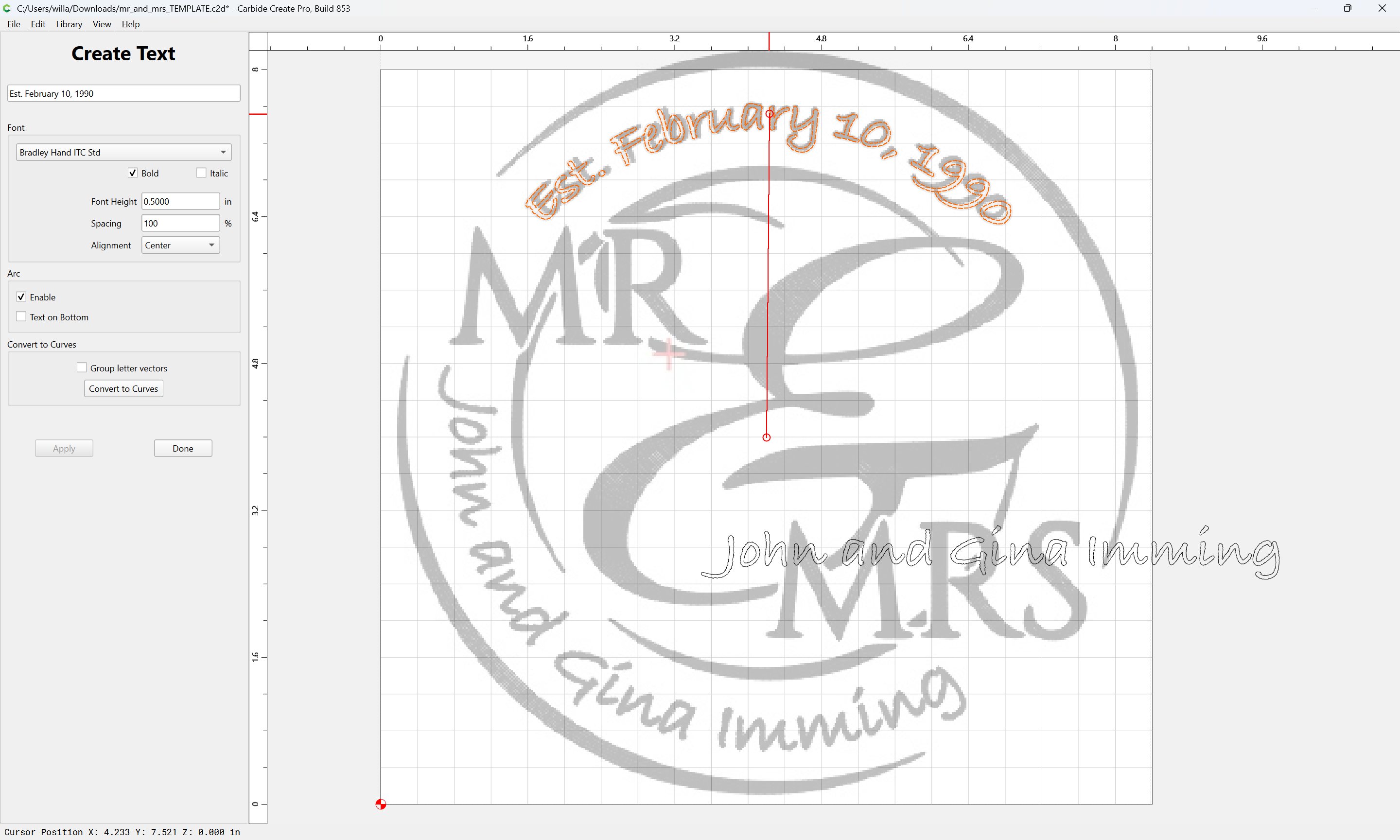

First, set the text:
(note that it will be easiest to have it centered or left-aligned as appropriate)

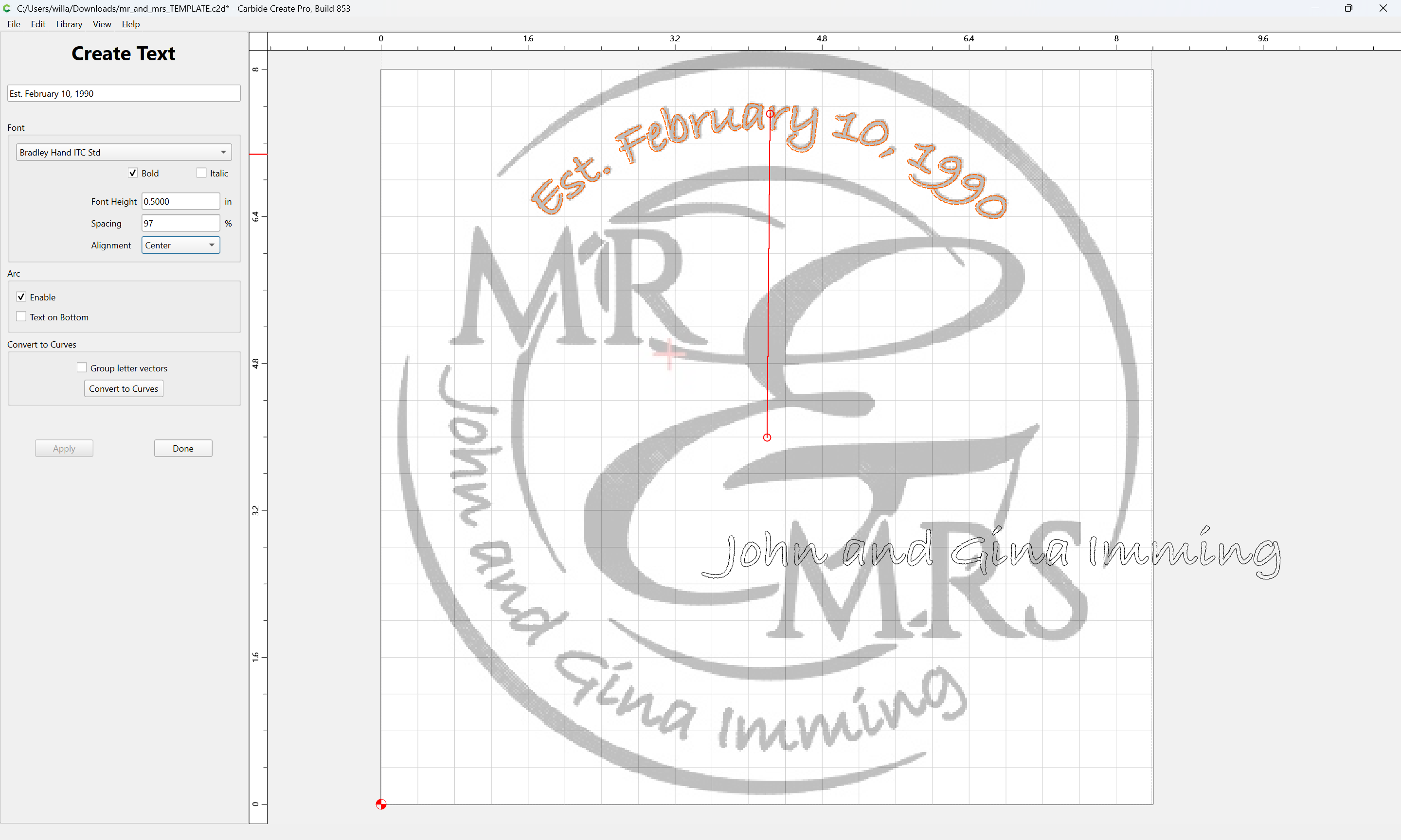

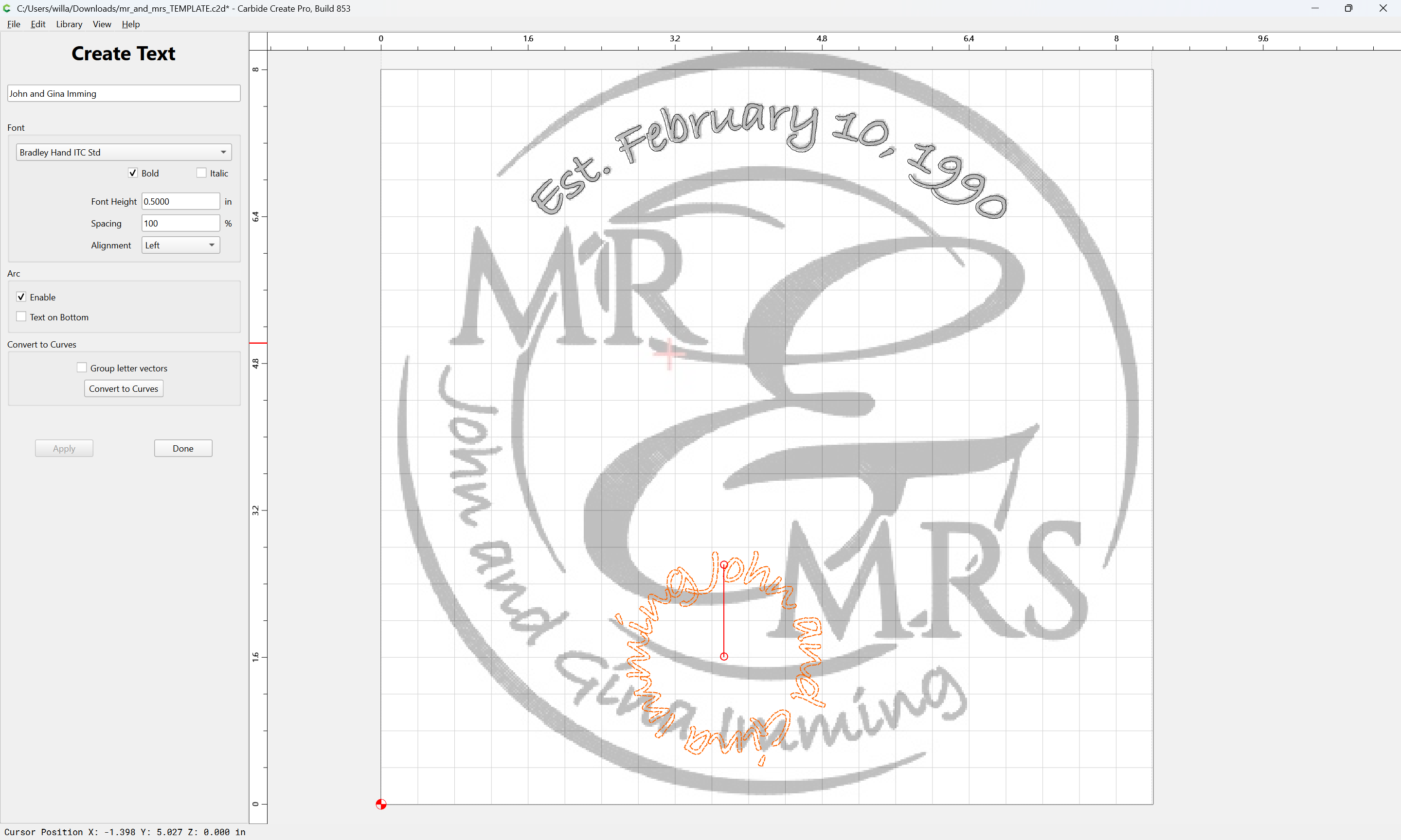

Then for each block of text enable the Arc option:
and adjust the positioning as appropriate:
and adjust spacing:
until things line up.

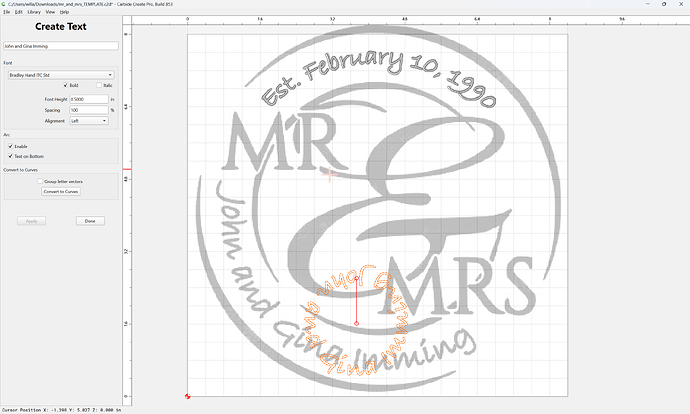

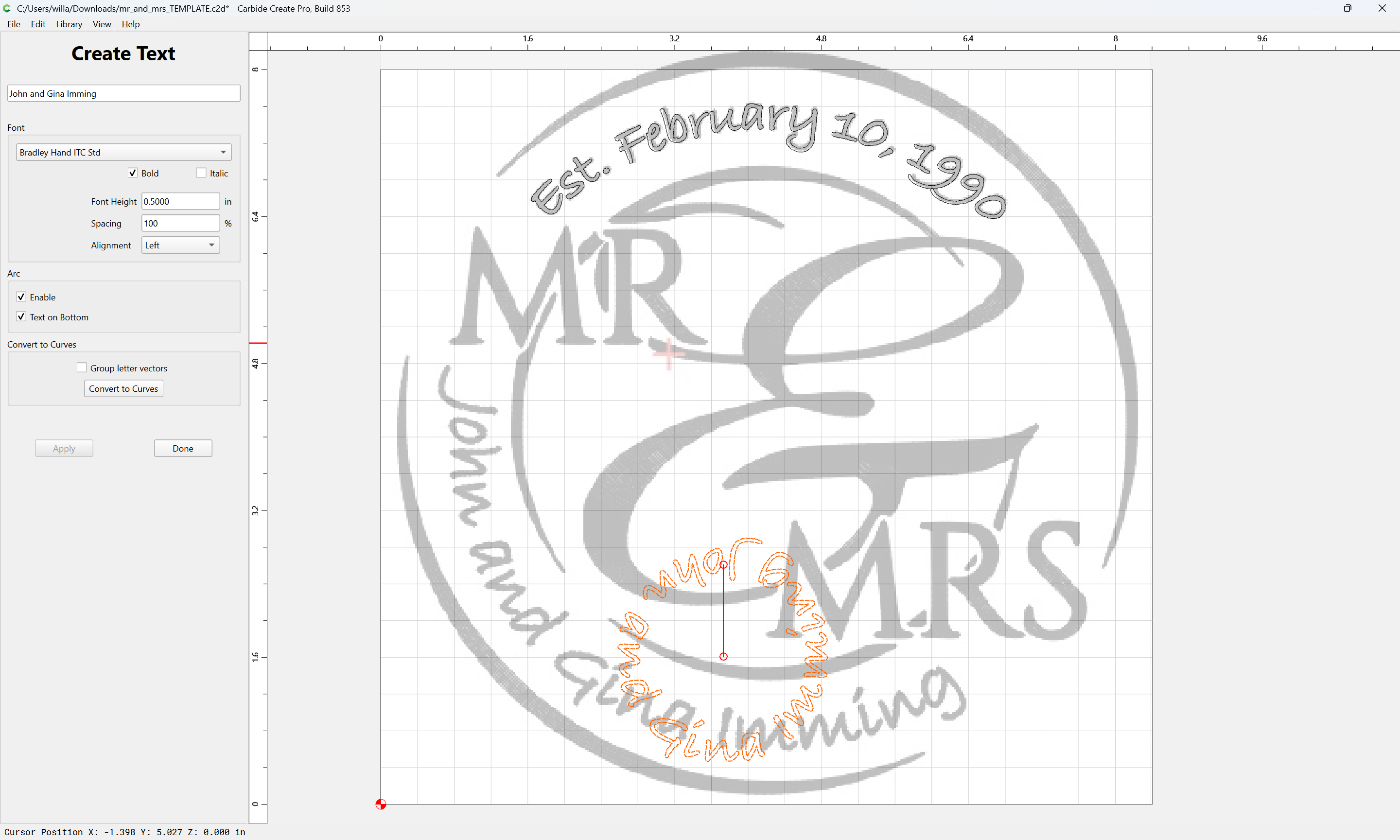

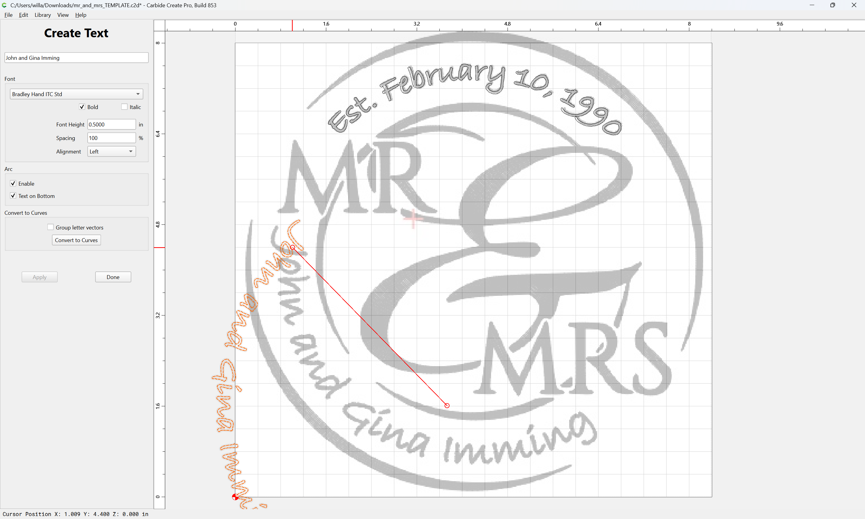

Repeat for the other block:

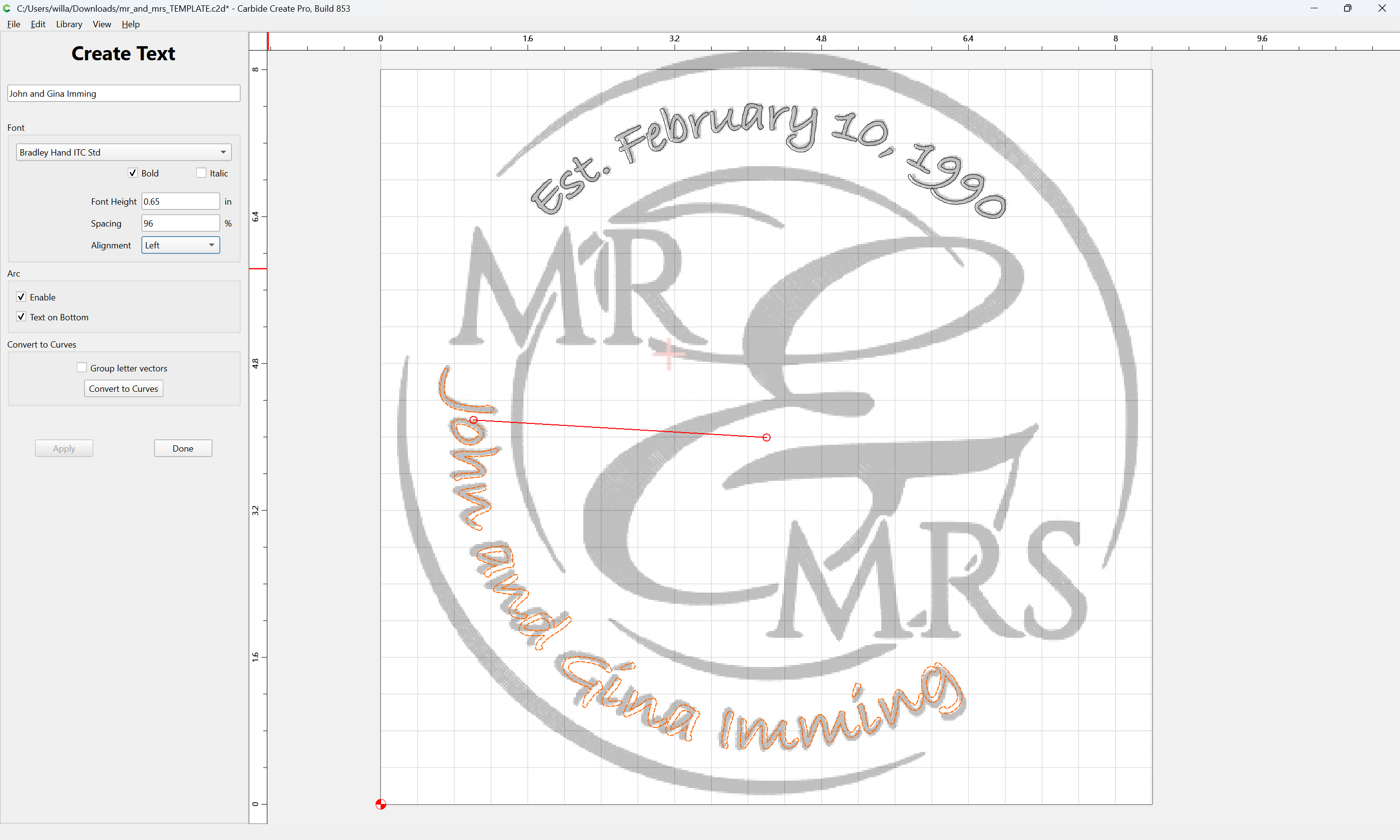

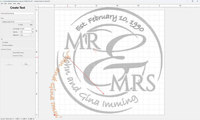

checking the “Text on Bottom” option:
Iterating until one arrives at:
