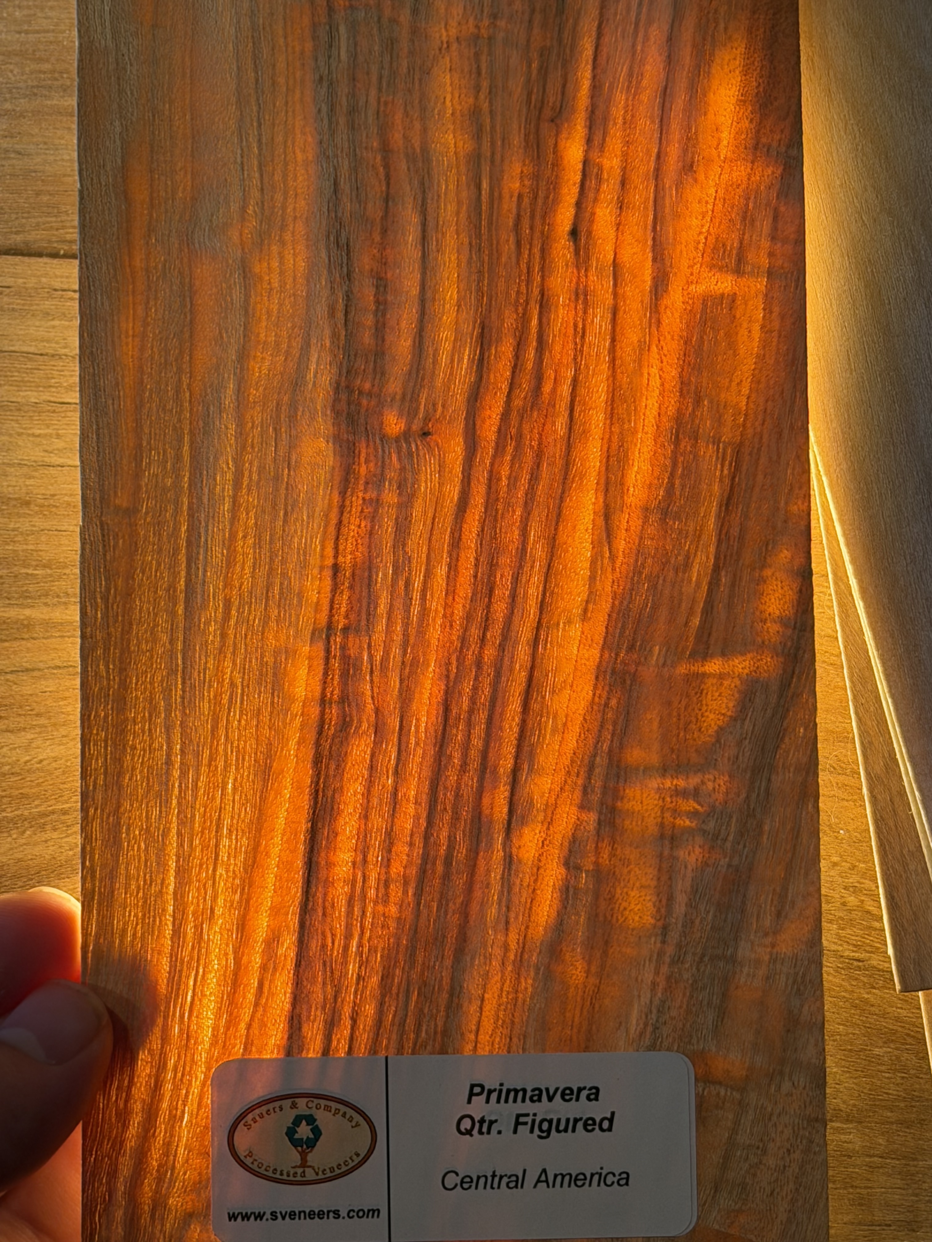

I’m inspired by this photo from a recent (unfinished :see_no_evil:) project:
I’ve got a bunch of different veneer, a led driver, and some high quality lights. The only thing I’m lacking is! An idea for using it :rofl:

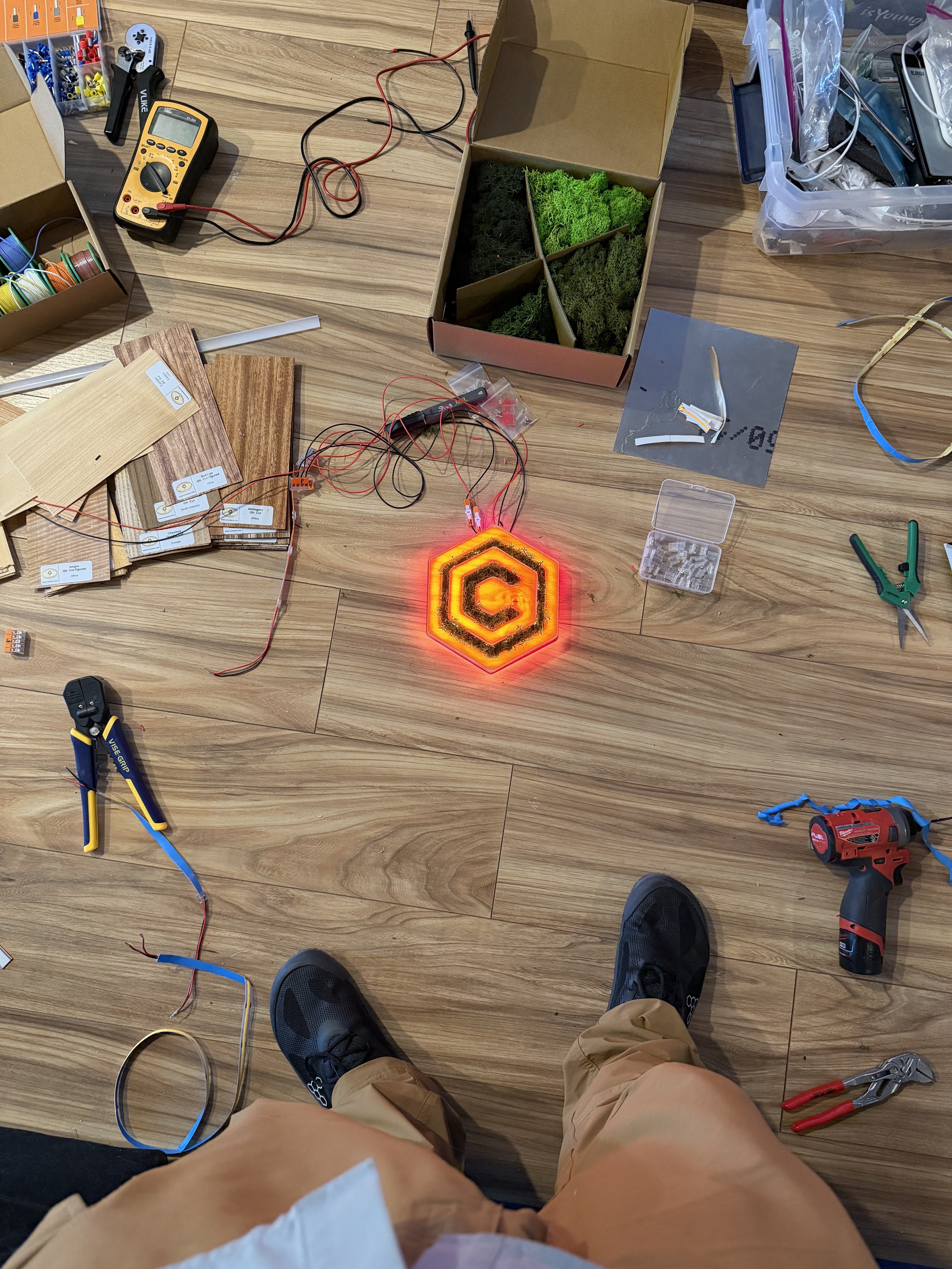

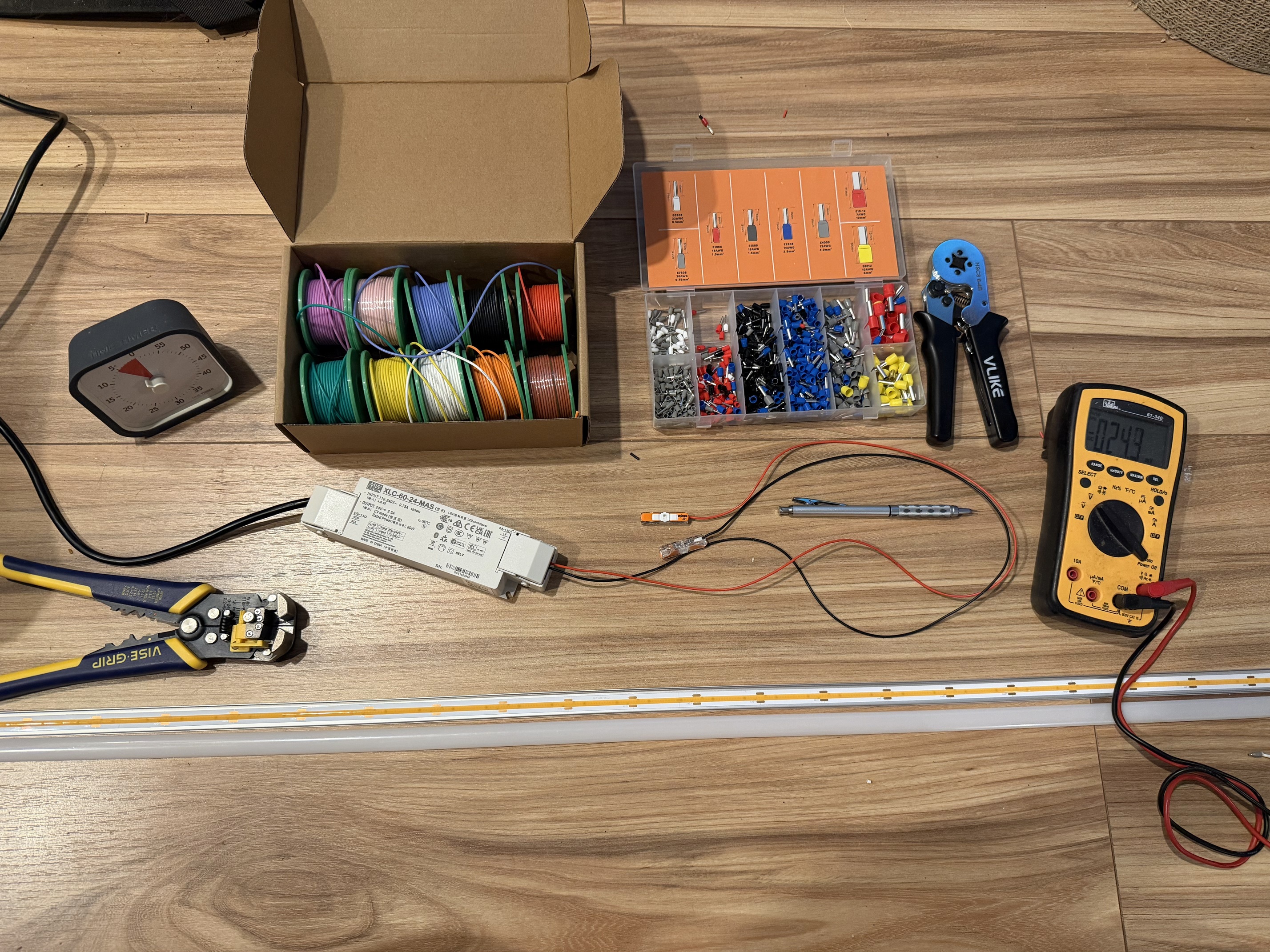

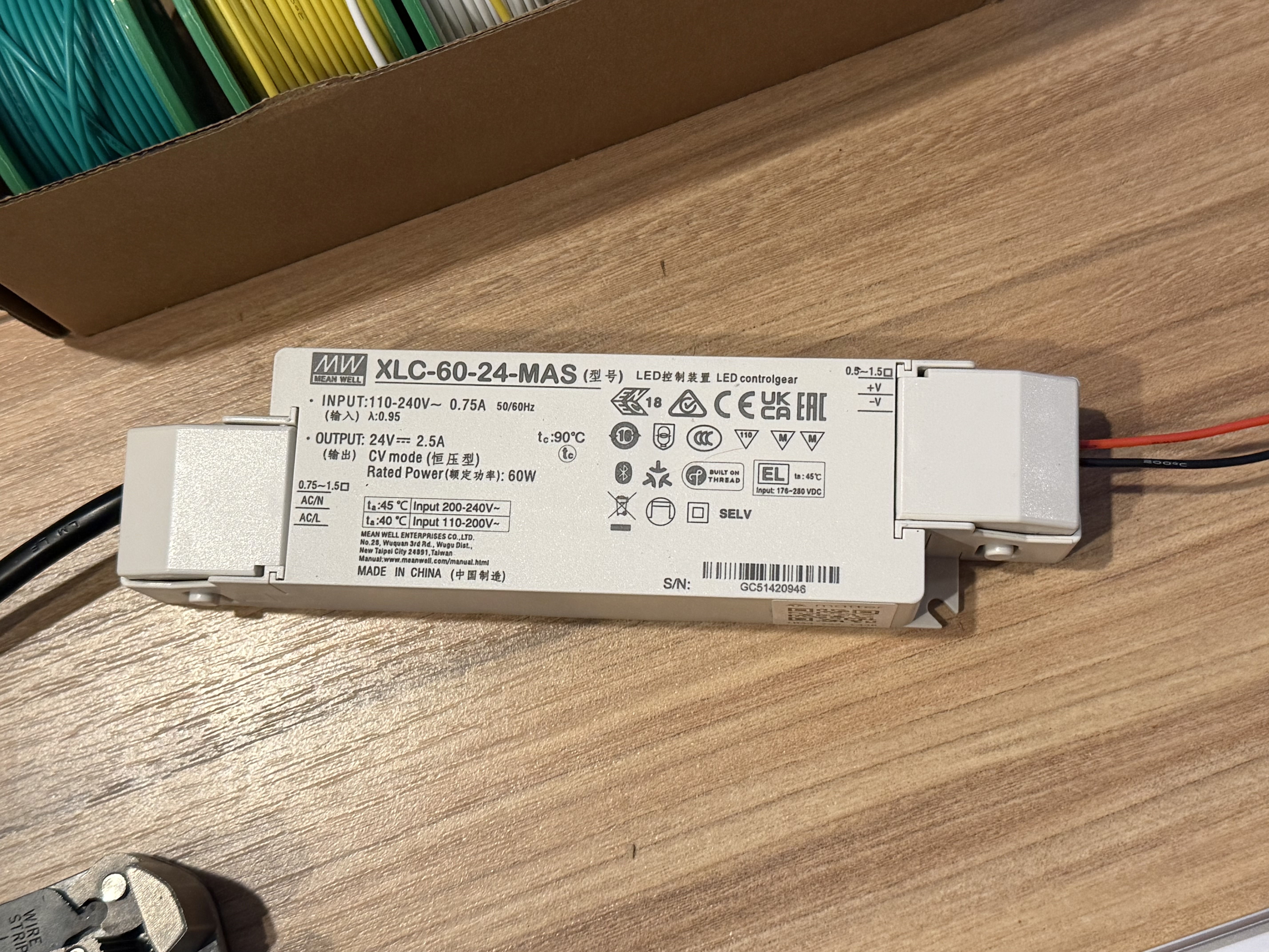

Here’s the experimentation setup:
Driver is a nifty Meanwell with integrated Matter for wireless control and dimming. This should make for very simple integration in most smart home systems or business wireless systems.
I’ve never used it (or any matter device) and it was literally one click and a photo of the QR code to add it. Finally something I would be comfortable providing to most consumers I would expect to buy this sort of lighting.
110-240v in and 24v dimmable out for powering a strip of analog LEDs.
I might take the next while to cut a logo or mask to make the lighting tests more interesting.

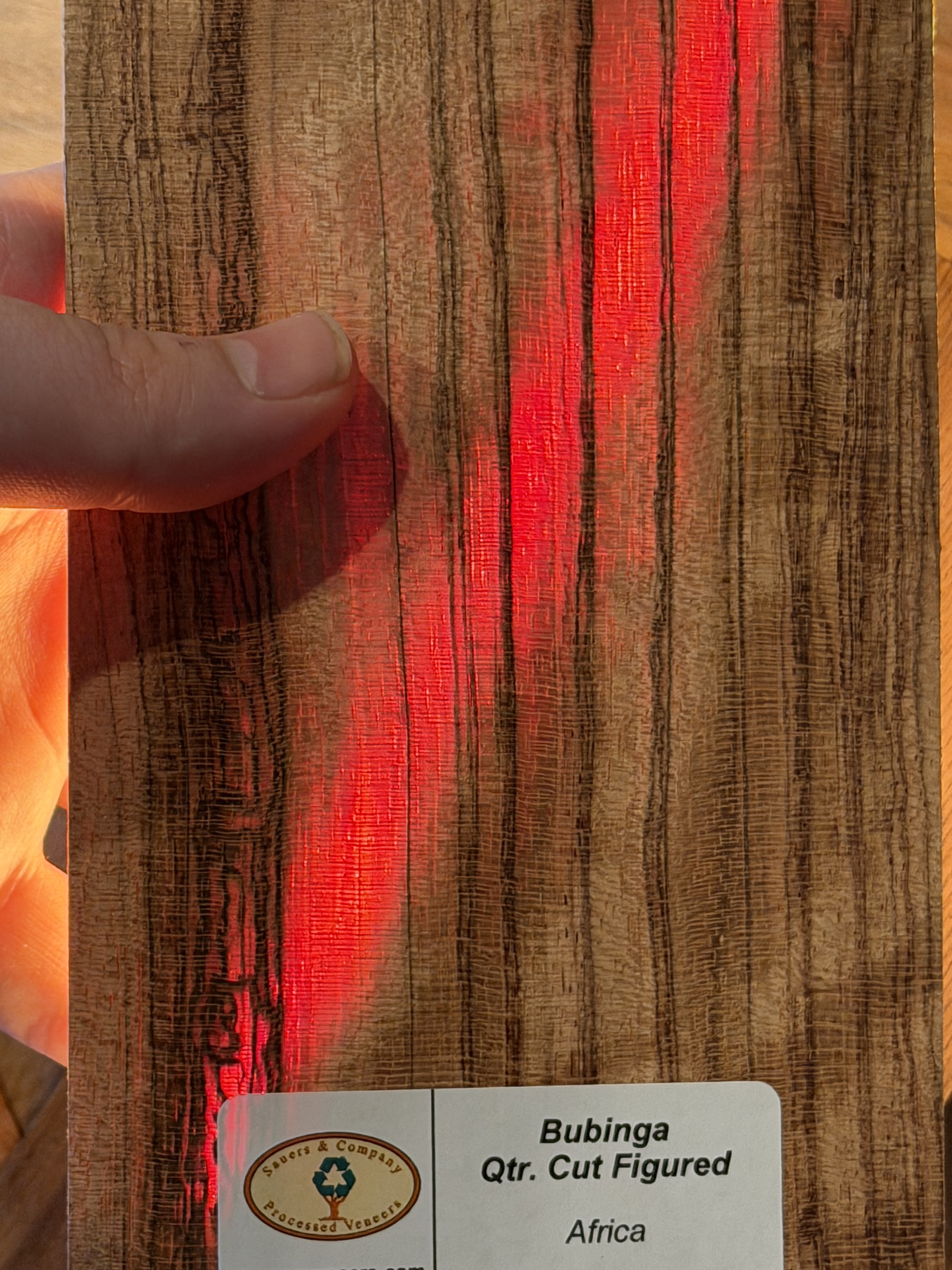

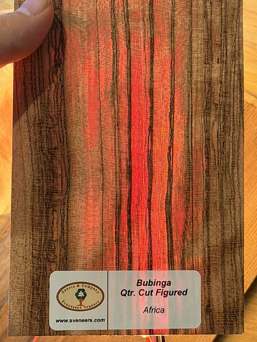

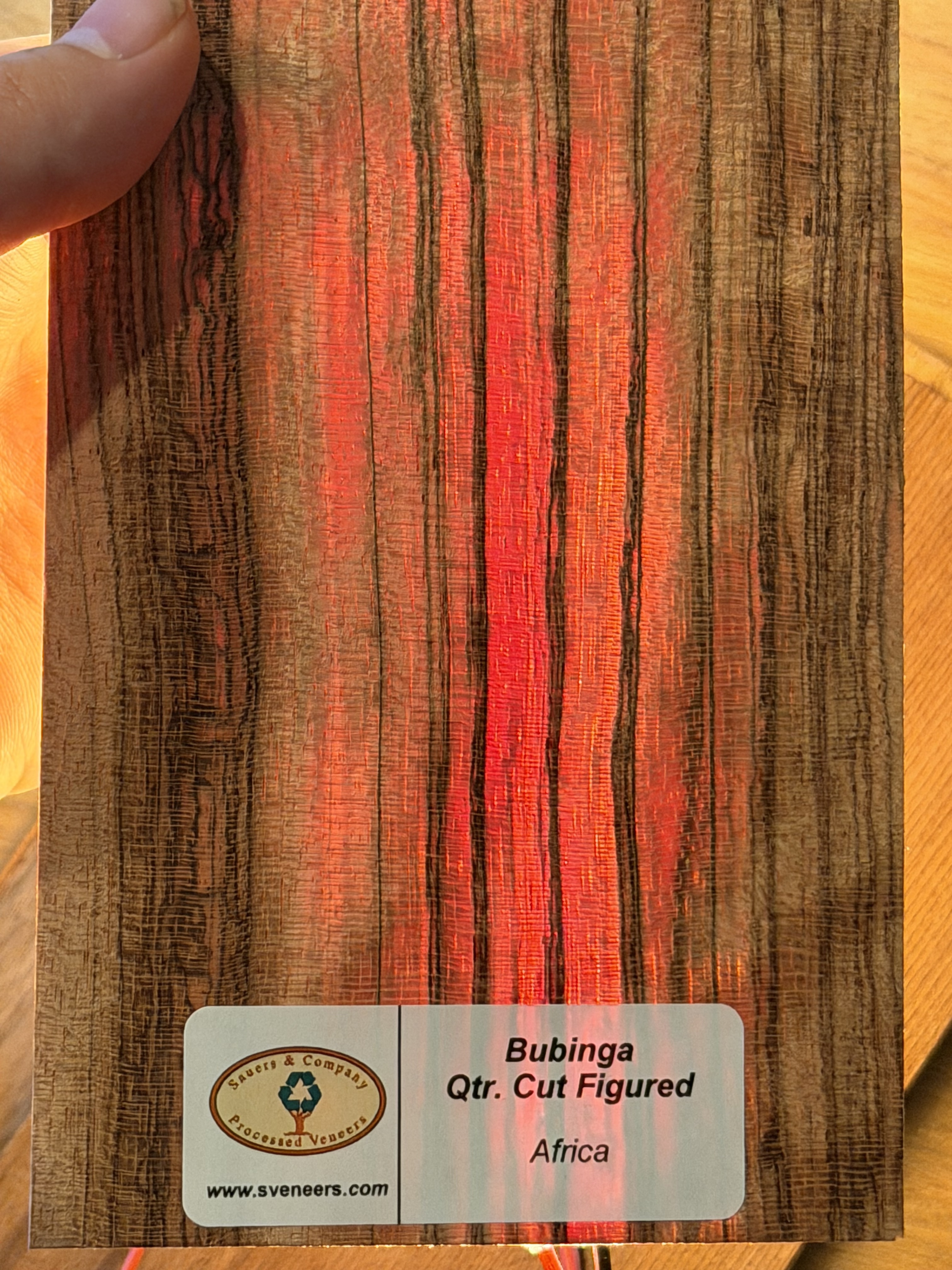

I did a very quick sorting of the ~light transmission for each veneer I’ve got in my identification pack.
High, medium, low, none.
  • High is a great even distribution of light.
  • Medium has good distribution but there are grains that block light.
  • Low is almost entirely blocked but there are grains that allow though (basically opposite of medium)
  • None is effectively opaque
Next up is making a jig so I can quickly iterate and photograph at different distances from the light source.

Here’s a quick preview :slightly_smiling_face:

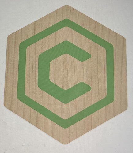

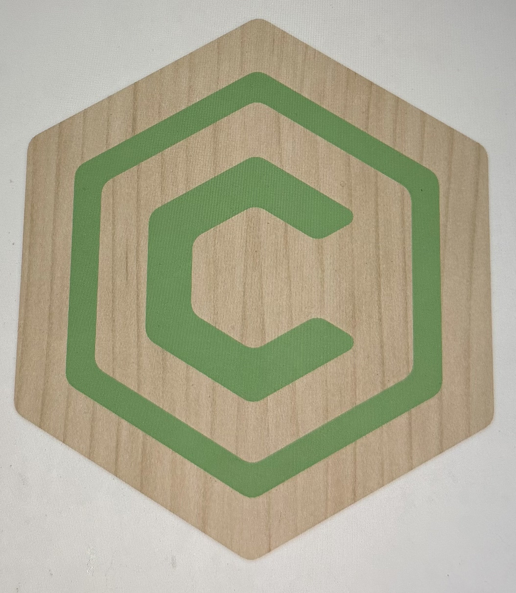

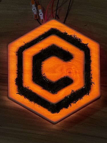

For testing, a Carbide 3D logo seemed appropriate:

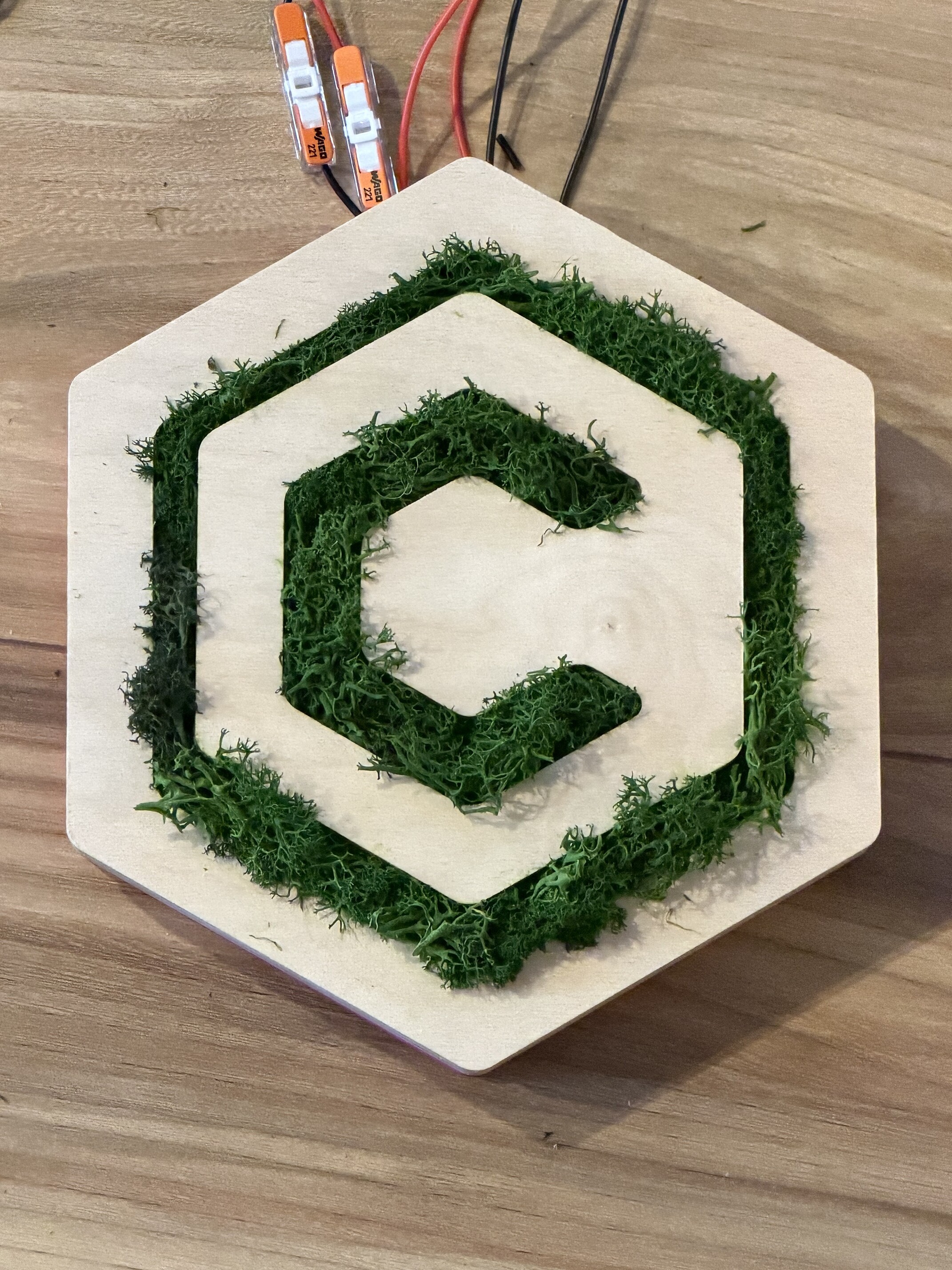

I inverted the colors, with the green of the logo being backlit wood and the negative space being preserved moss. (In hindsight, I wish I wouldn’t have done that but that’s just one of many lessons learned)
To keep the wood oriented appropriately, a 3d printed backer is used with some edges. There are better ways to do this and I’ll likely use something metallic as a heat sink for the strips, this works for a quick prototype though.

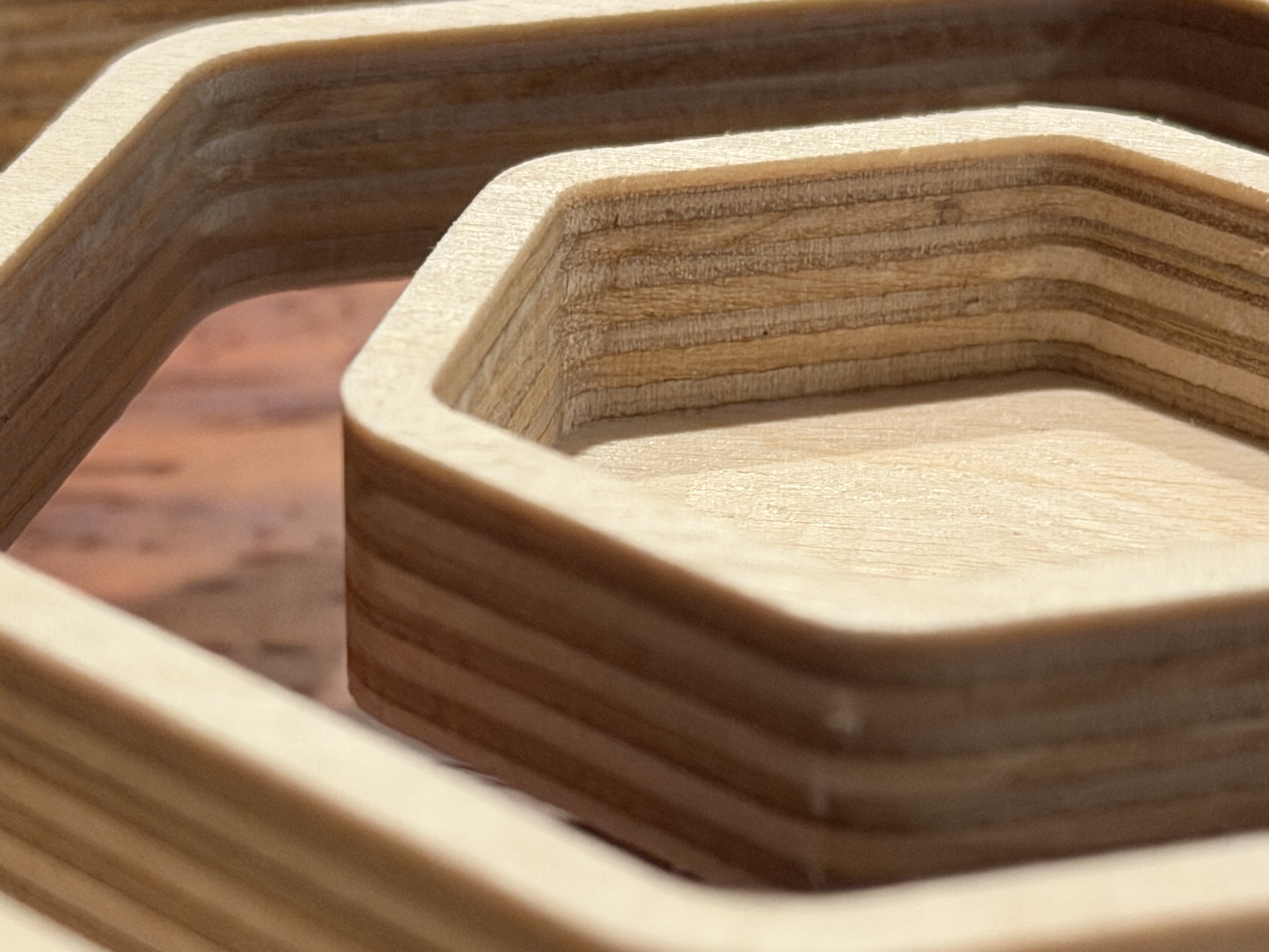

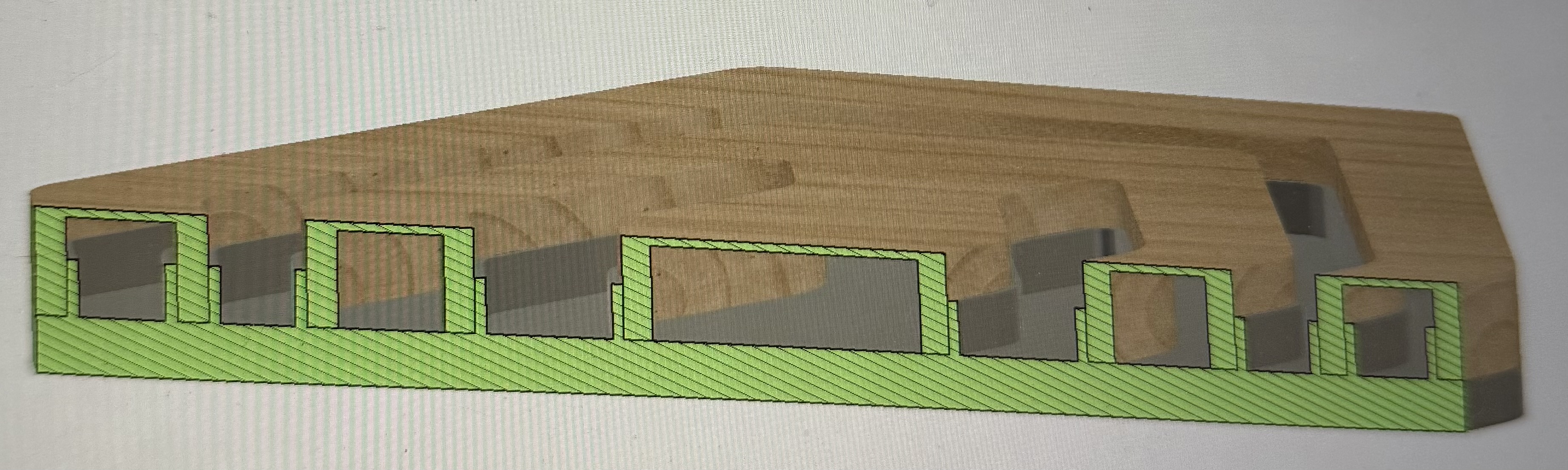

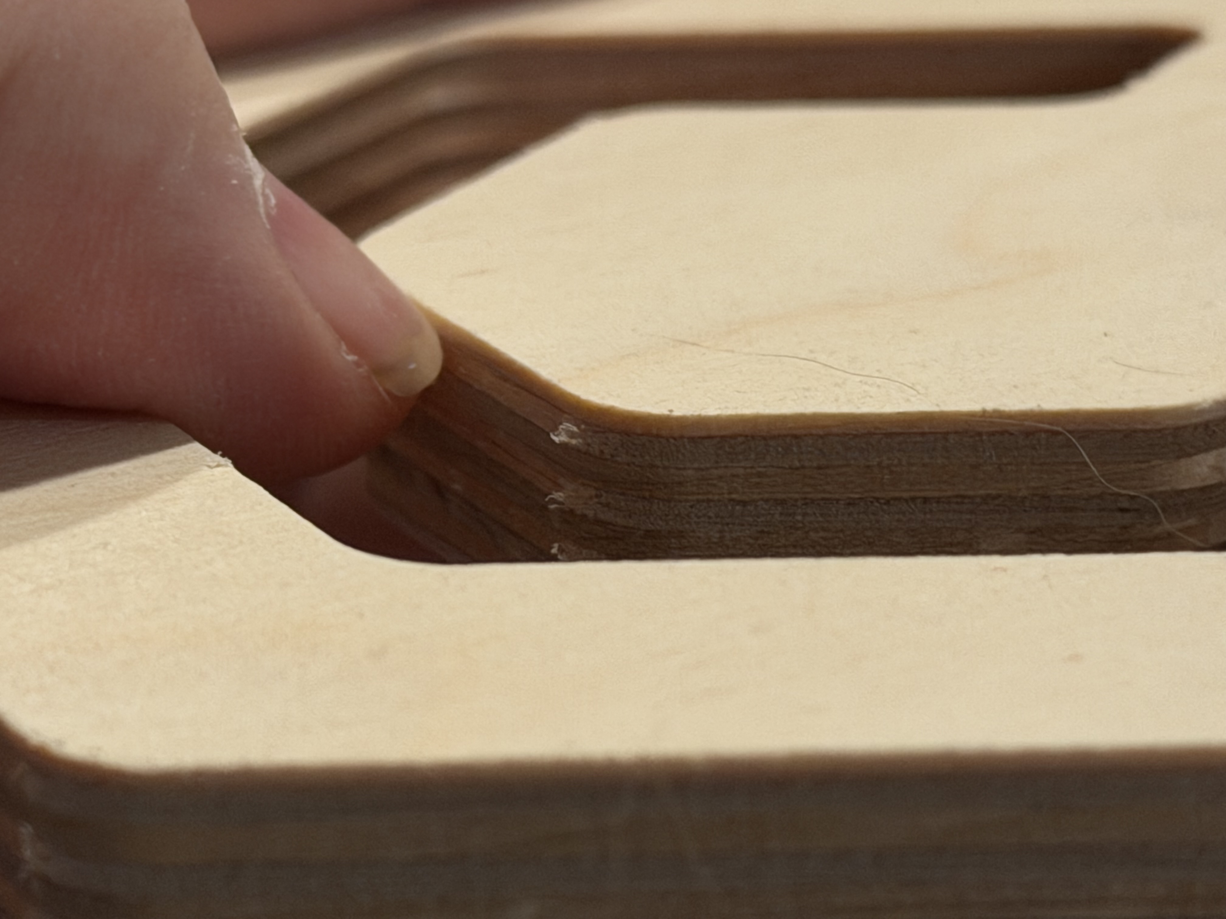

Here’s a cross section:
The approach here is to remove everything but the top layer of veneer in the birch ply. Luckily the ply is relatively consistent, only about 0.1mm thickness variance from what I can tell.

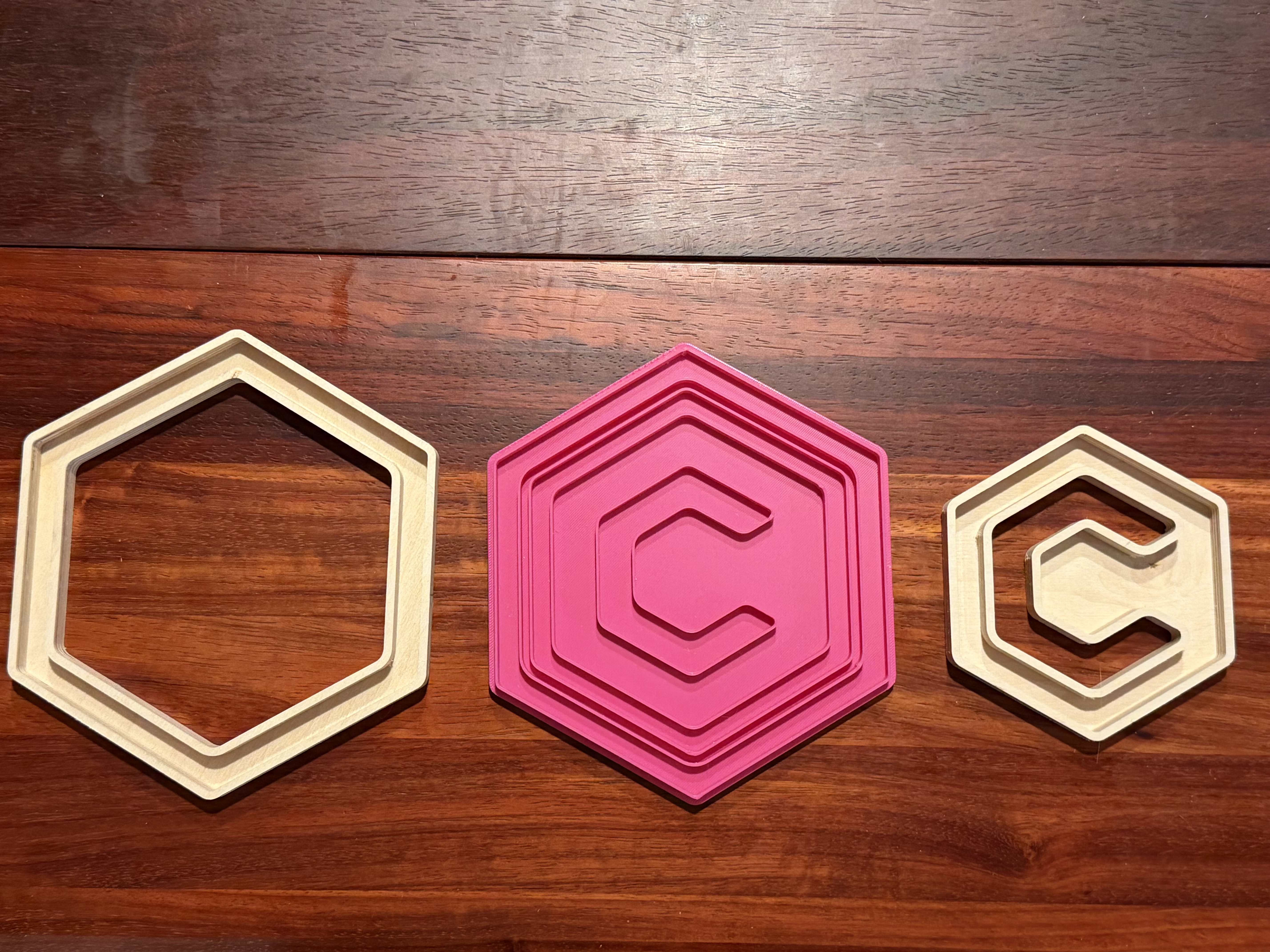

Here are the pieces:

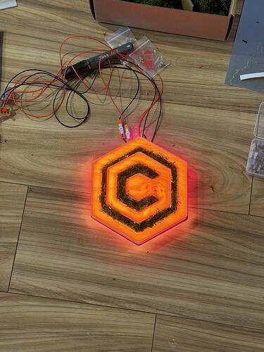

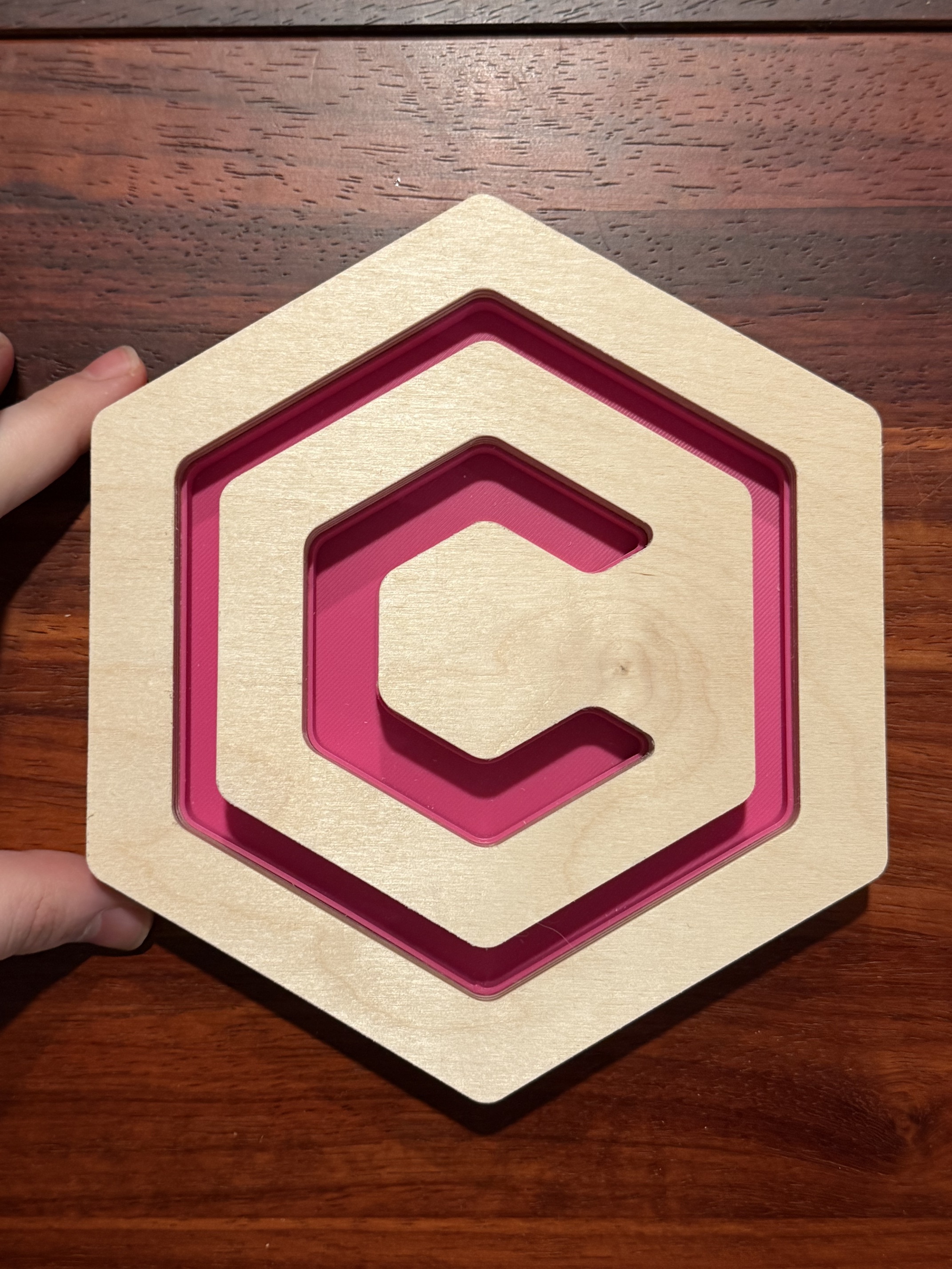

And a rough fit up:

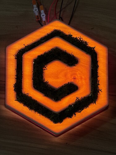

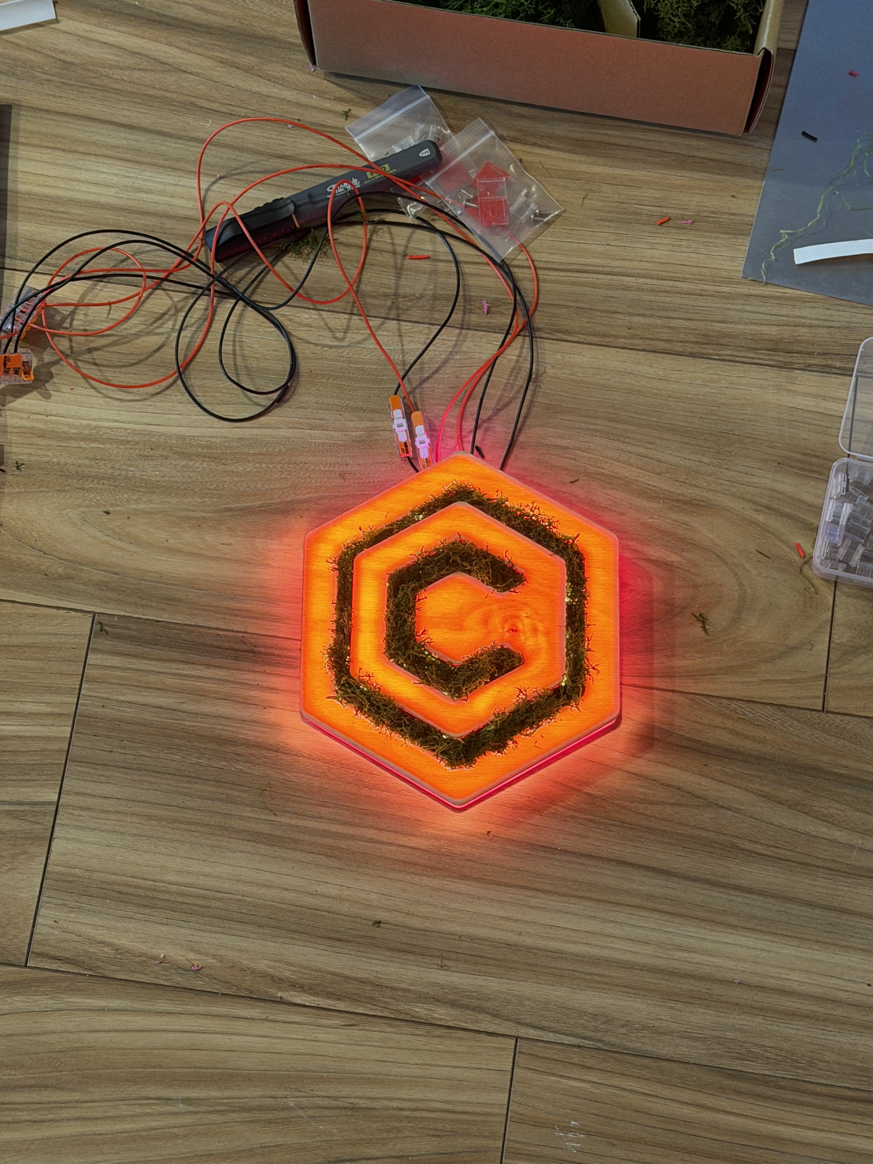

For the reveal…it’s impossible to photograph in a way that represents how it really looks. I’ll figure it out eventually:
Honestly I’m pretty excited to try the RGB and animations. That’s got some real potential, especially with the more interesting veneers.

Amazing your Birch is that consistent to get the thin layer to back light thru. Great project!
Yeah I was surprised it was that consistent, though I don’t have much experience with plywood so maybe I just got lucky :sweat_smile:
To be honest, I didn’t expect it to work. I was fully prepared to lay a sheet of veneer overtop if it broke through at all. Which I might still do for the next project to get some grain variation.
