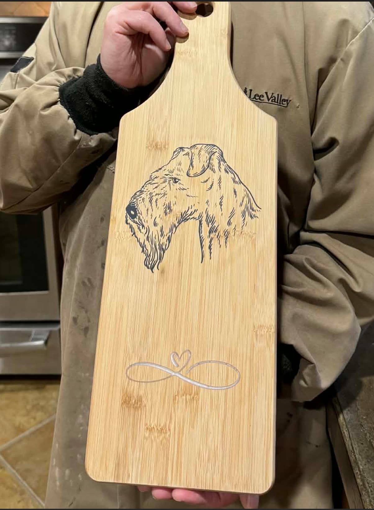

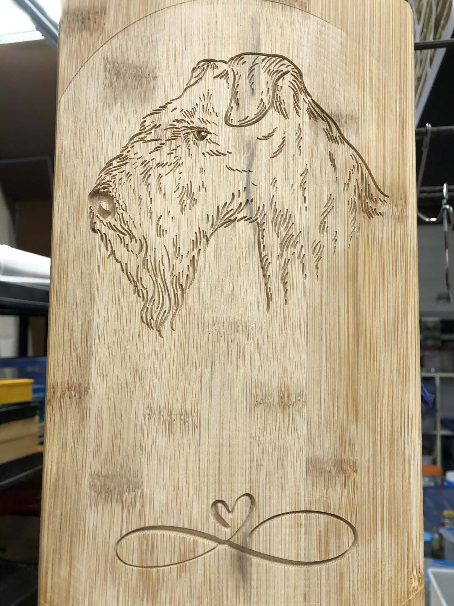

We found some Bamboo Serving boards, so I thought I’d see how well they carved.
I used a 30 deg V Bit for most of the work:
I then used epoxy and machined / sanded down, then Odie’s Oil for a finish.
Best part? $4.50 (Canadian!) at the local Dollar Store.

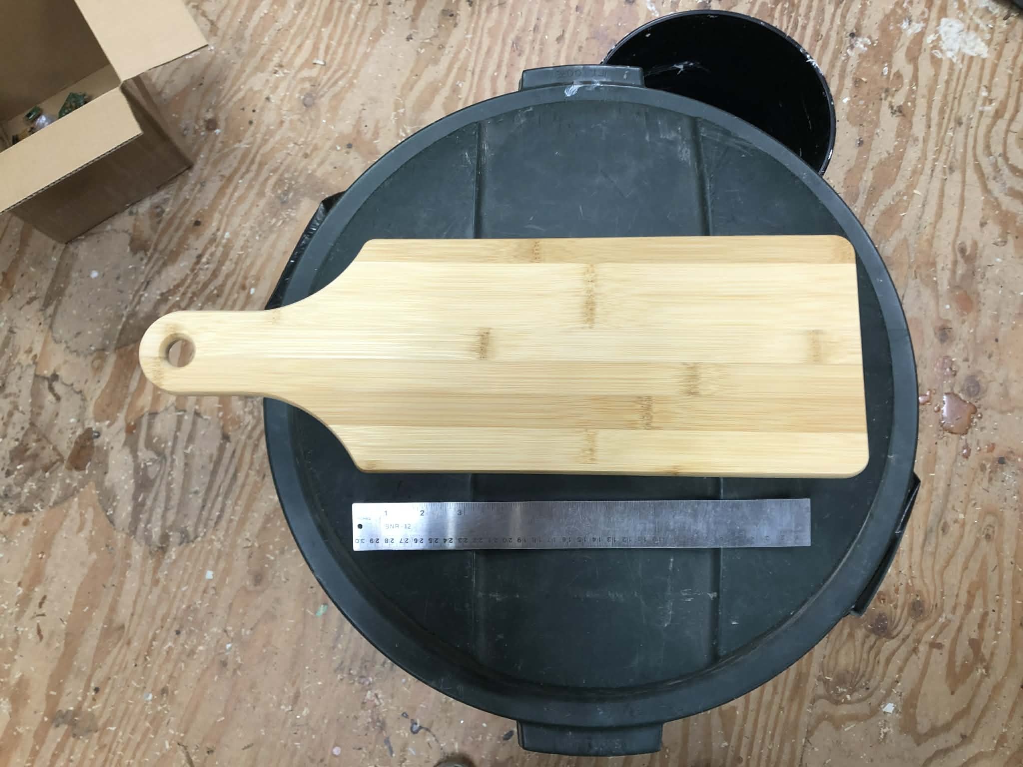

The rectangular ones can make for quite affordable stock as well:
…though it’s now $3.75 in the U.S.:

Is there a way to tell if a cutting board is solid laminated bamboo vs. junk on the inside?
Mostly, mine have been void-free — did encounter a void in one, but it happened at a place where it made a natural finger groove, so all good.
The Ikea Aptitlig cutting boards are a bit more expensive:
https://www.ikea.com/us/en/p/aptitlig-cutting-board-bamboo-80233430/
and since they are laminated in a single layer of strips, don’t seem to show voids (but they’re also quite a bit thicker, making for chunkier proportions, or requiring a lot more material removal.
They also have a design like to the one shown by @mhotchin for about the same price:
https://www.ikea.com/us/en/p/aptitlig-cutting-board-bamboo-40557247/
Thank you, Will. I had looked at bamboo cutting boards the last time I was at Ikea, but knowing their penchant for filling “solid” wood things with cardboard honeycomb I was hesitant to try one.
However, apparently there are two (new (bottom) vs. old (top)?) styles of the Ikea cutting boards:
The old ones with the vertical only glue-ups seem to be consistently void free, while the newer ones with the multiple layers (well the ones I more recently purchased) seem to pretty regularly have voids…
Guess I won’t be buying any unless I can go in to a physical store and check.
I recently cut my way through 48 of the bamboo cutting boards I picked up at a Dollar Tree store. Not a one of them had voids. I did have to toss a couple out for not being flat. Looking at mine I believe they are made up in a multi layer pattern.
I also have had good luck with the cutting boards from Dollar Tree with only a couple of very shallow voids along the center layer line.
