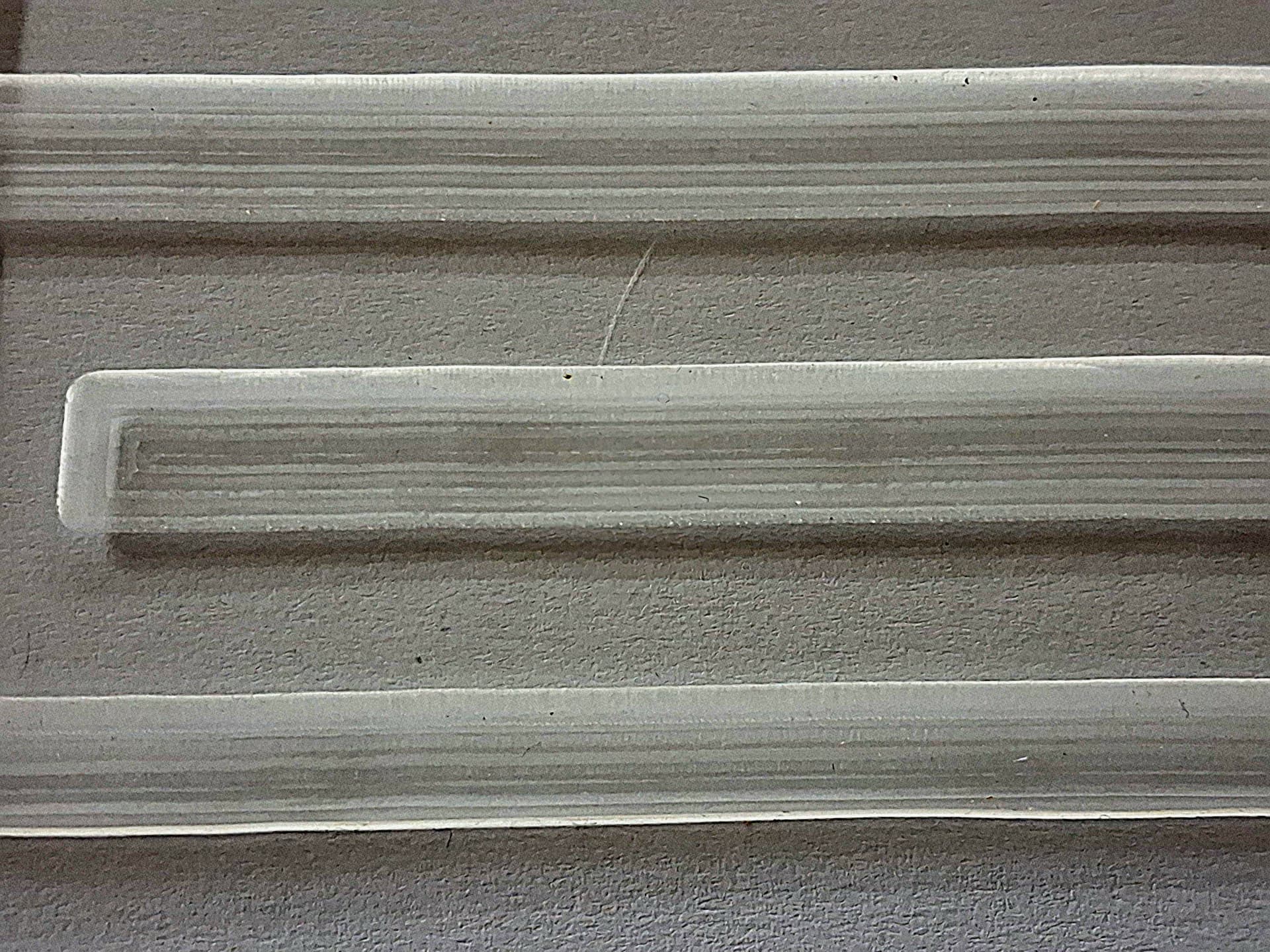

I tried to use a 1/8" Nomad 101 at 10.000 rpm, it works, but it makes small “lines”. Using a bigger tool did not work, and tore up the acryllic surface.
The 101 is a ball mill, so it’s going to leave scallops. Reducing the stepover will help, but there will always be a scallop.

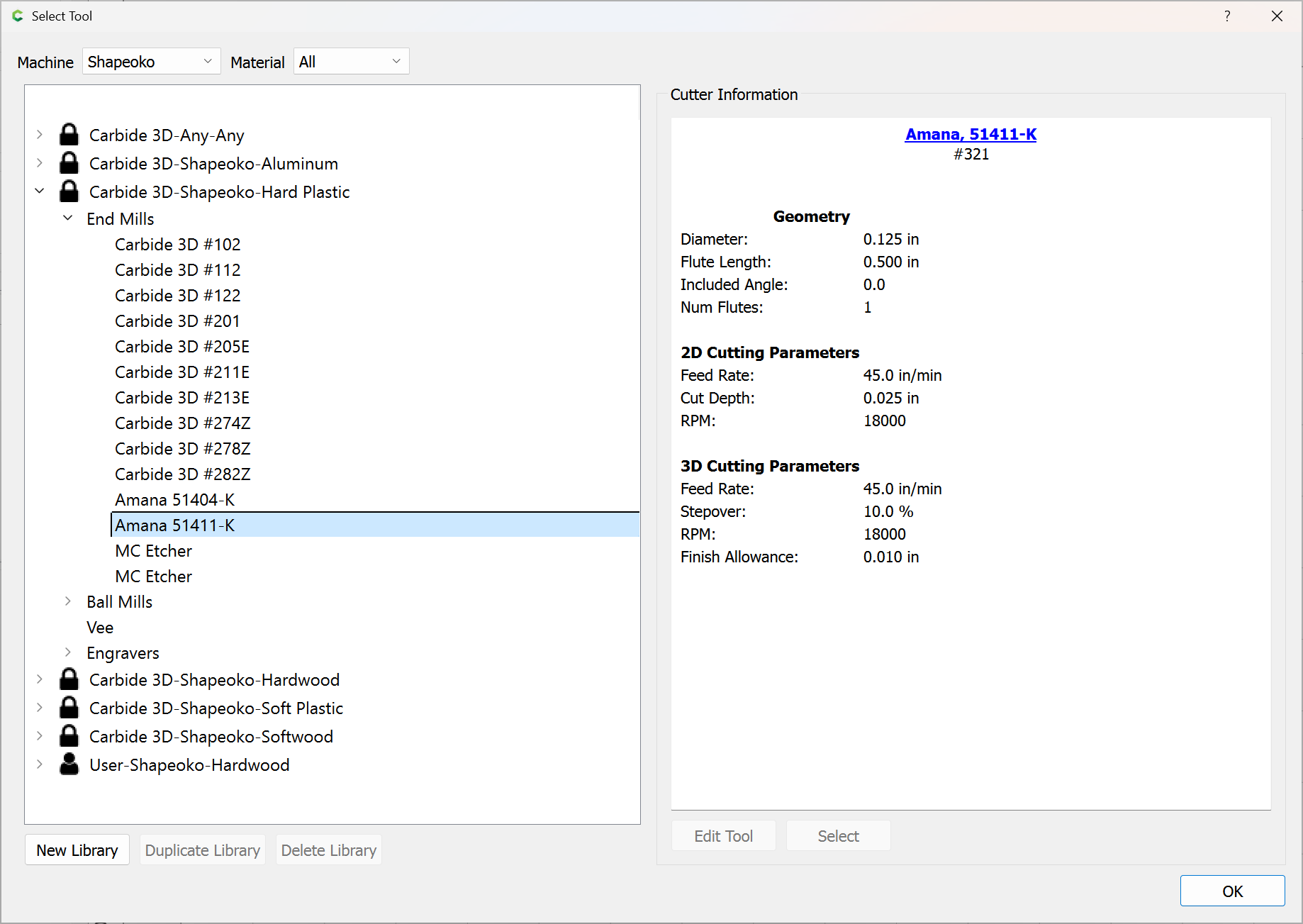

Also the Amana #51411-K .125" Single flute up cut in:

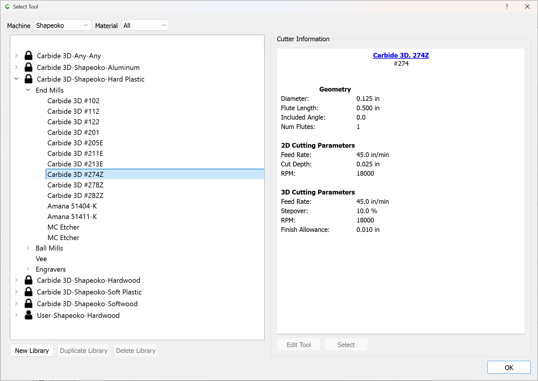

Where to buy Carbide #274Z in EU (or US without insane shipping cost) ?

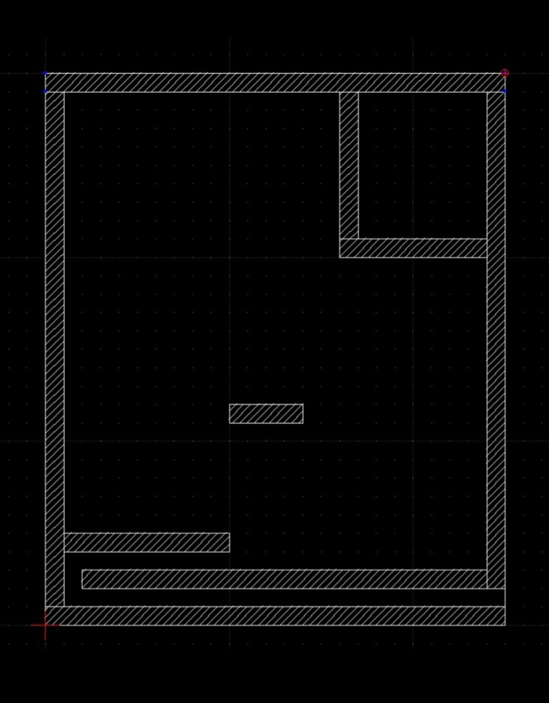

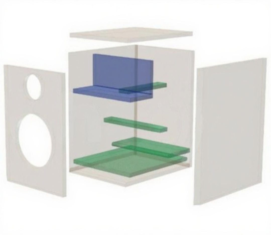

I only need to make pocket lines in two acryllic plates (25x30 cm) for assembly guidance for a loudspeaker and I have already ruined 2 plates. Maybe I should just look for a place to have this done ?

Thanks for your encouraging words. The speaker unit holes are easy with the powerfull laser cutter and looks perfect. Wish I could make the pocket lines the same.
Finally got my Carbide #274Z 1/8" Single Flute ZrN and tried it out. It works like a charm in acryllic, even with the Dewalt router going min. 16000 rpm. Requires good dust suction and a dust boot. I used Carbide #102 1/8" End Mill settings for hard plastic, with a high Feed Rate (1200). No melted acryllic with the new mill.
Now I wonder if I could somehow sand the 2x10 mm. grooves to make them shiny ? (Intuitively, this sounds like a paradox to me)
That’s awesome to hear! Thanks for reporting back :slightly_smiling_face:
For your intuition, think of the surface at a macro scale. My guess is that cutting at 16000rpm with some runout is going to leave a whole bunch of small vertical ridges as the flute shears away material. Light hits those ridges and scatters instead of bouncing off in a clean and orderly fashion.
I’m pretty sanding would knock down the ridges providing a more uniform surface for the light to bounce off of. I imagine flame polishing works in much the same way, just using the surface tension of the acrylic to pull the surface into a more uniform roughness.
