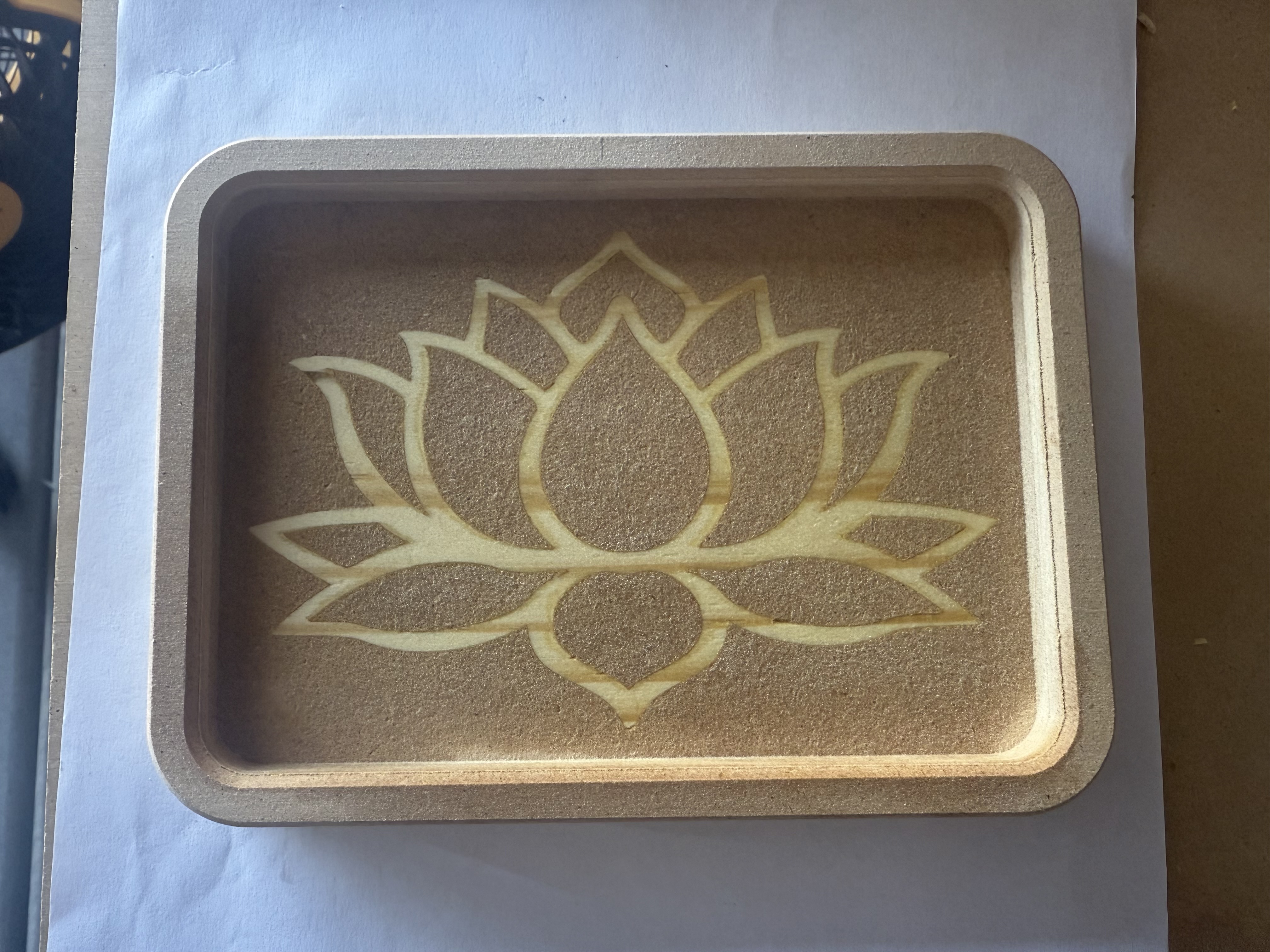

I started over with both the female and male portions, then ran a test run. Ended up not needing the 1/16th. Just used 1/8th and 60 deg v bit. Came out pretty good for mdf and pine…and my first inlay. :grinning:

I remember my first inlay. What great feeling!
Looks great!! Nice job!

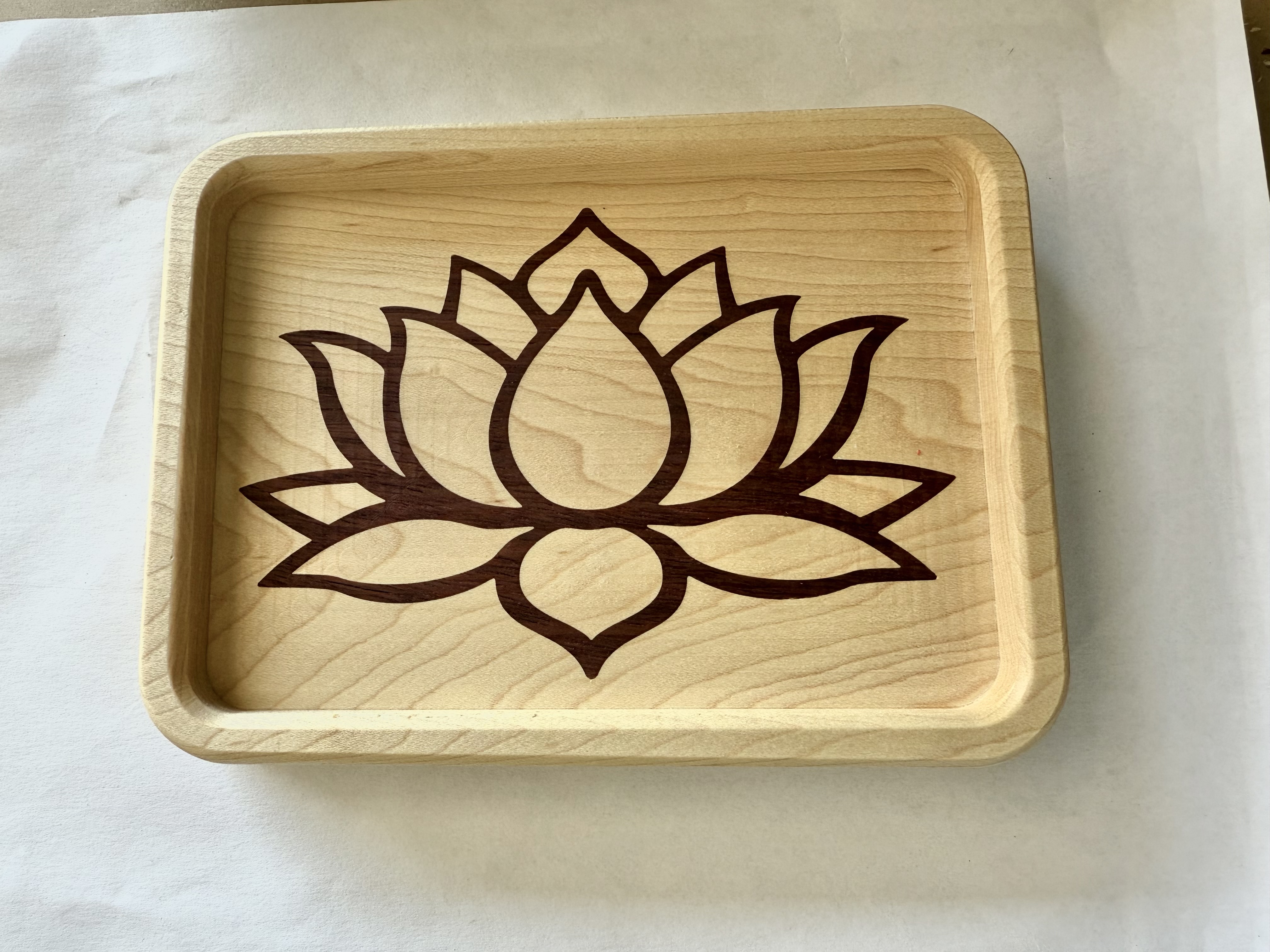

Thanks, just reran it today with maple and purple heart for the insert. Hopefully it turns out like the test run, just better looking. I will see how it turns out tomorrow. Fingers crossed.
Here’s the final result.
Very nice! Looks like a perfect fit with nice clean edges.
Thanks, yes I was very pleased. Anxious moments as it is making that last pass…lol.
Did you use V bit or end mills?
1/4 in end mill to clear the excess wood from the inlay.
1/8 endmill and 60 deg v bit for the male and female parts
