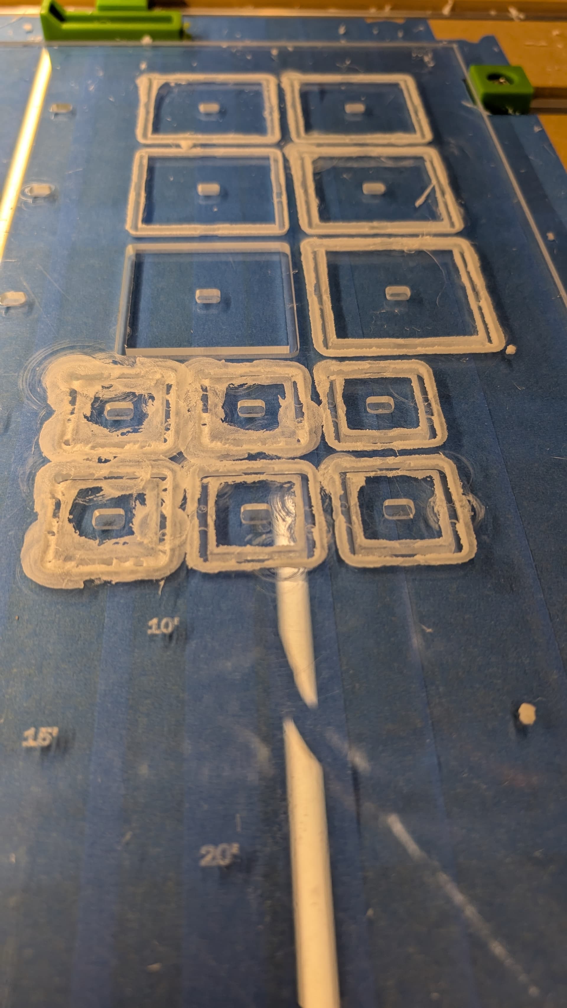

My previous results were… let’s just saying a learning experience.

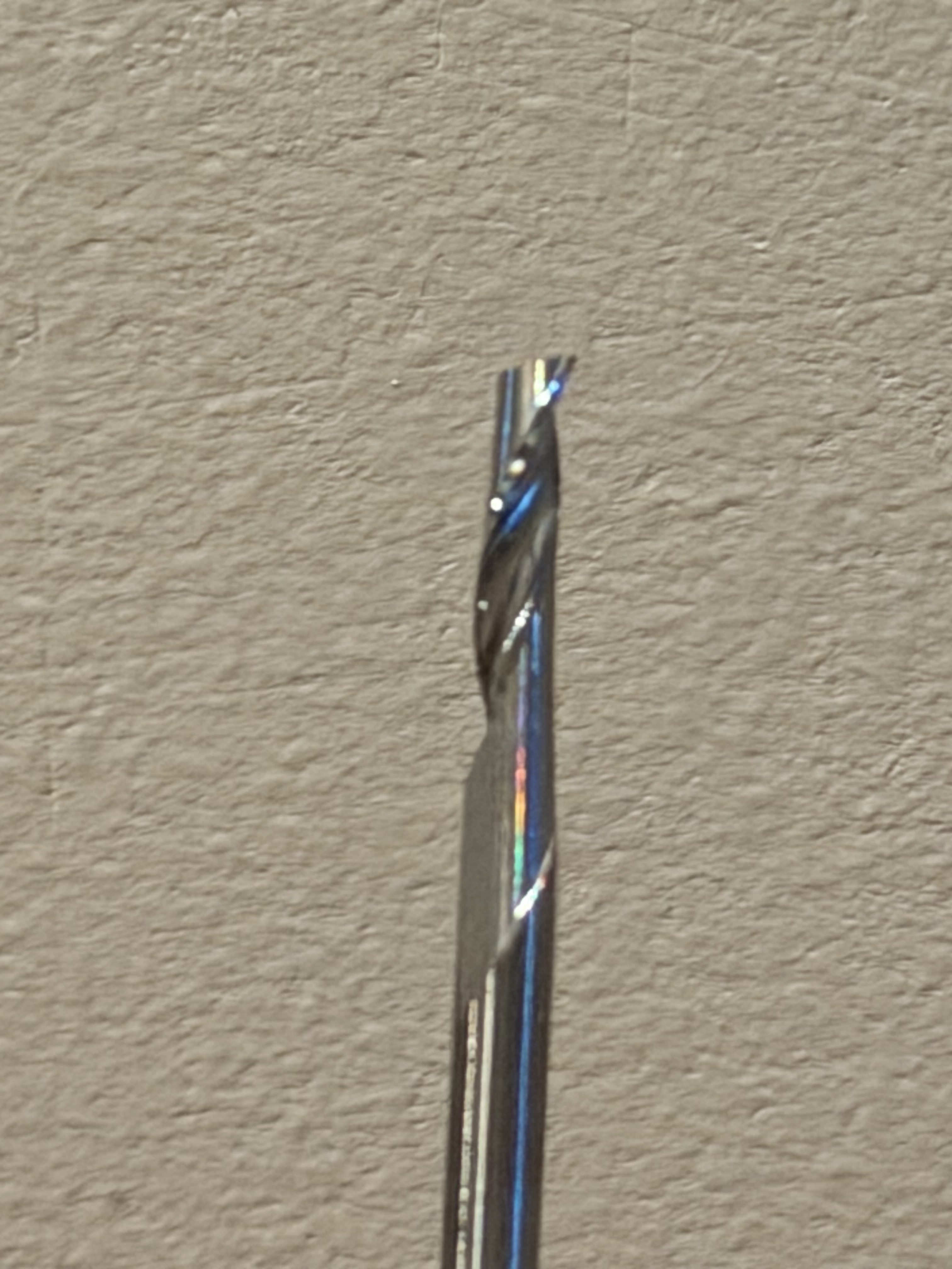

Single flute cutters:

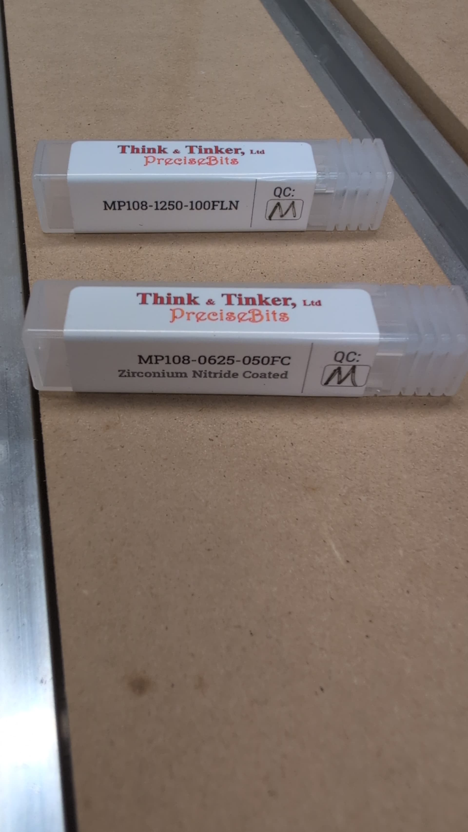

I’ve had good success with the precise bits plastics tooling:
Downright pretty tools that eat acrylic and leave a great surface finish.

I tried a bit of soapy water last night just as a quick test. It definitely keeps the plastic from melting to the bit, but it also caused the chips to hang out in the groove and not be cleared.
I switched to a steady stream of compressed air and it worked great, although it makes a huge mess because it bypasses the dust collection.

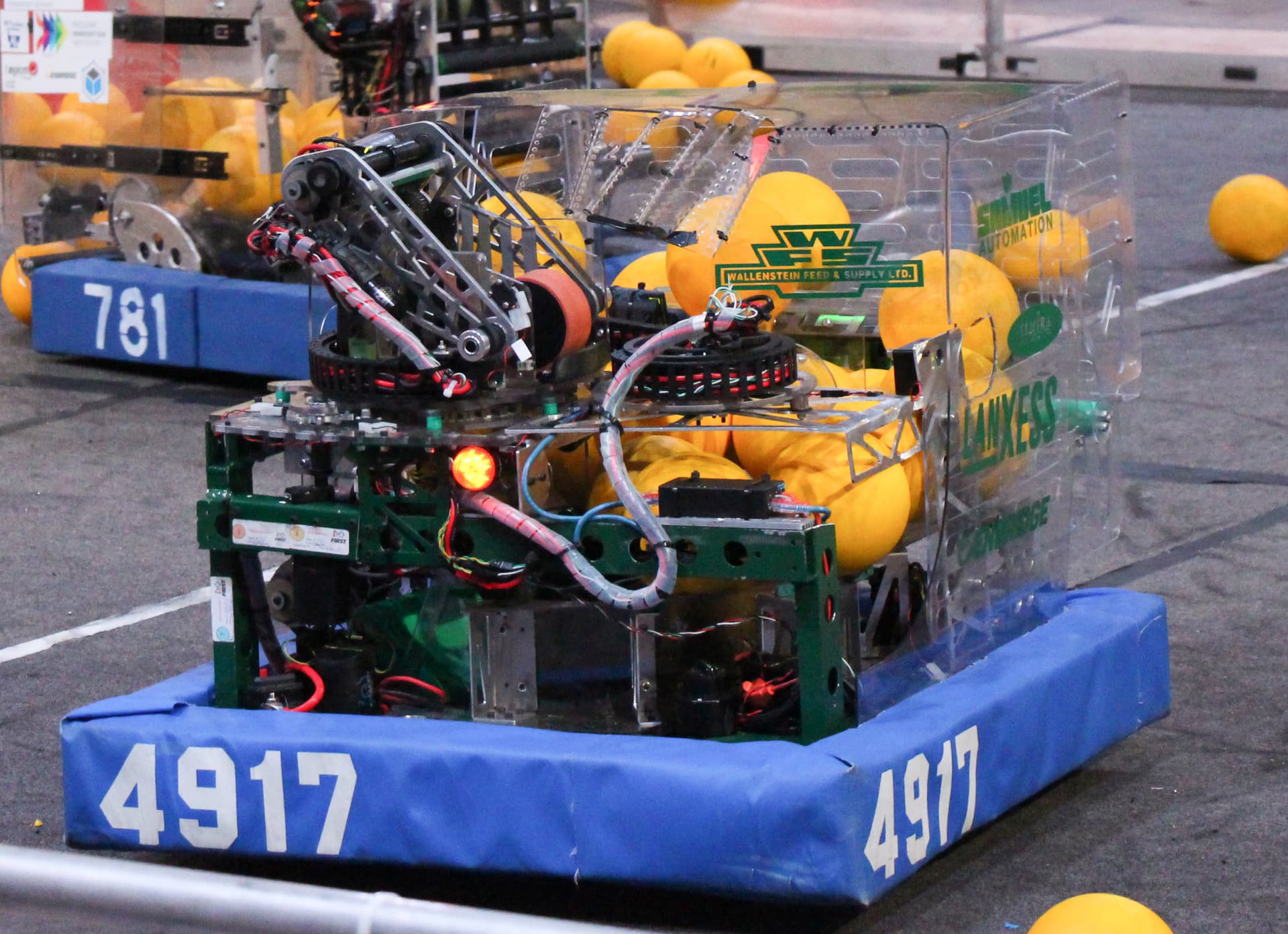

I’ve done over 100+ hours cutting on poly carb. Single flute and the default “hard plastic” settings in Carbide Create have worked just fine. I don’t bother with ramping. Unless I’m cutting something really small, I use the two pieces of painter’s tape with super glue method of part fixing and I put it on every waste board strip. I originally tried to skimp on this, but I found that even 6mm poly carb will flex and you get much cleaner cuts if it’s secure. When you get down to 3mm or thinner, you really need to secure it will or it will lift it off the surface temporarily. If you need to use tabs, I use 0.2" width, 0.04" thick. They’re thin enough that you can use a pair of flush side cutters to cleanly remove them. I dry cut everything with just the vacuum for chip removal. I actually find poly carb is easier to cut than acrylic.

If the part was silver, or transparent, it was cut on my CNC. :slight_smile: We also prototyped most of the aluminum parts in poly carb first allowing us to quickly iterate on spacing and tolerances. The shooter turret on the left side is a combination of multiple 6mm poly carb layers including some cut as custom spur gears. The top cover is made of 3mm poly carb. And under that pile of balls is a circular structure to funnel all the balls towards the shooter made of 1mm poly carb.

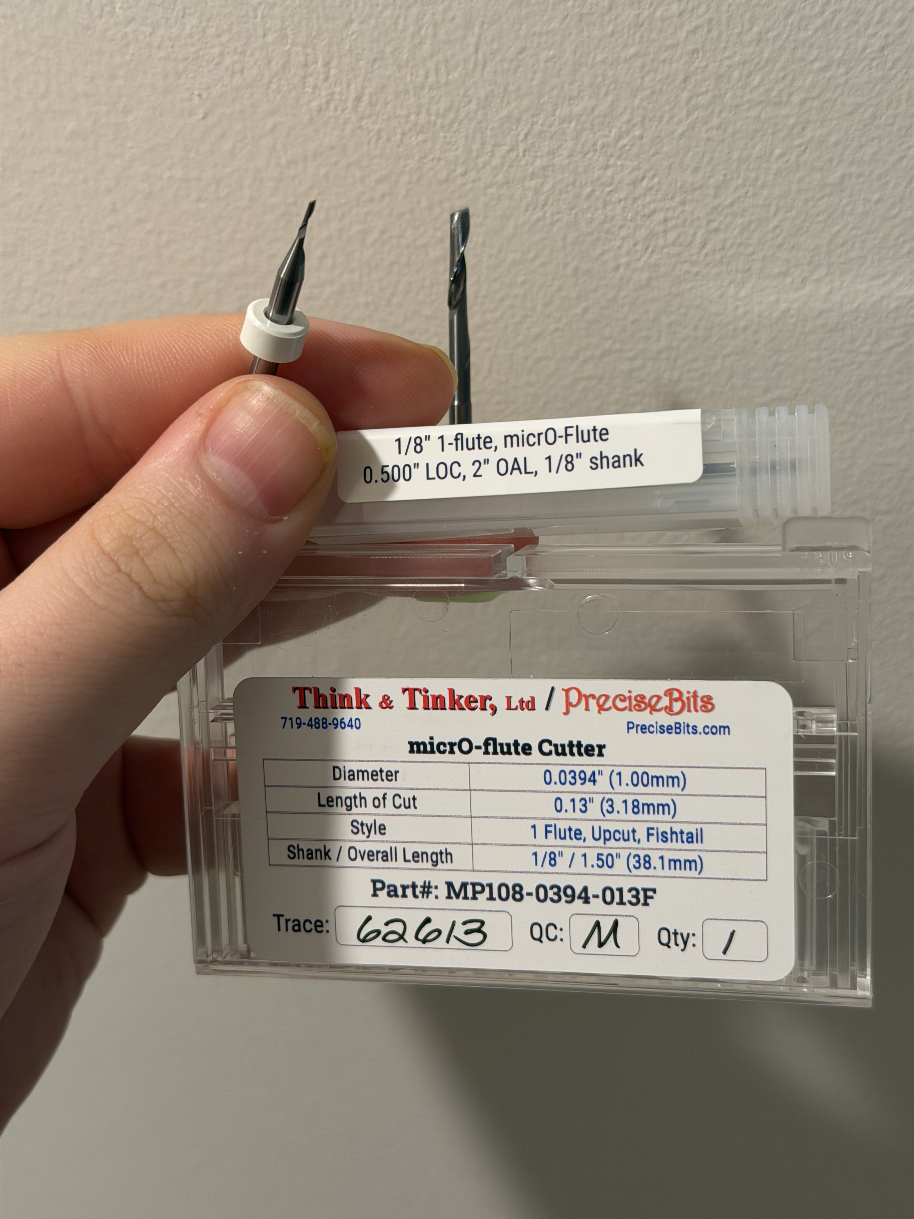

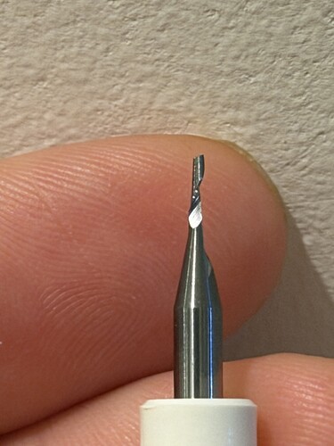

I just received a 1/16" and 1/8" single fluted bit from these folks. Do you have any feeds n speeds recommendations for these? If not, I plan to call them after Memorial Day and ask.
I need to enter them in the Carbide library…
What manufacture? And are they called out as a plastic only bit or are they a generic o flute?
Amana/ tools today both have good feed and speed information on the product pages.
They have generic ( aluminum cutting) oflute and plastic specific oflute models.
The plastic specific models are usually much sharper and have a little deeper flute cut. To allow for larger chip extraction.
Precise Bits at Think & Tinker in Colorado.
These are specifically listed for plastic cutting on their website.
I’ve not cut much polycarb so getting some advice from them would be the best bet.
I tend to start with feeds and speeds from a similar tool in carbide motion since they tend to be conservative. Generally a safe starting point.
