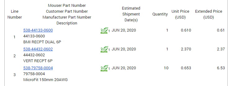

With these 3 Molex parts, you will not need to replace your board enclosure’s cover. You will just pass the wires through the default wires pass-through in the enclosure. The connector that needs to be soldered to the board is a vertical connector and not the right-angled one.
