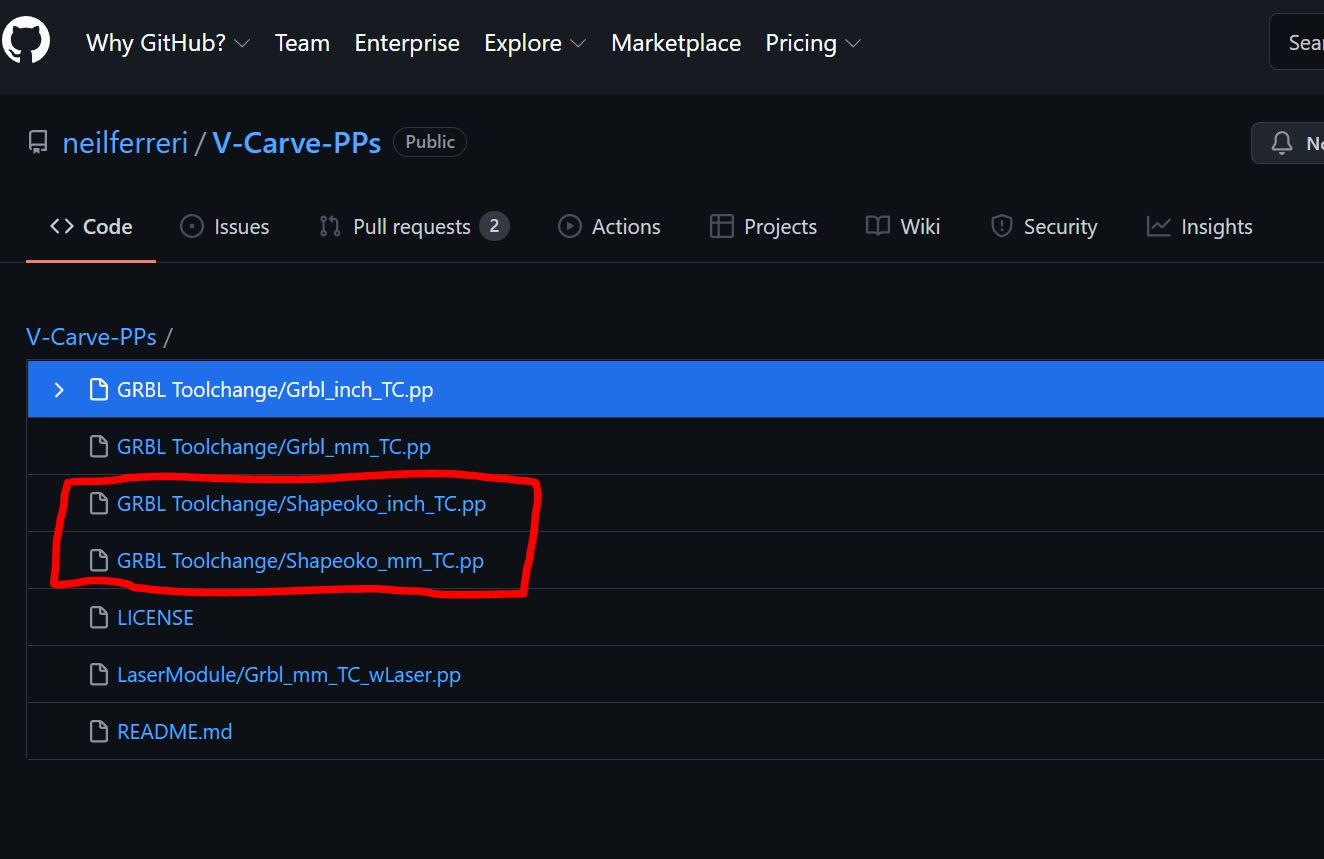

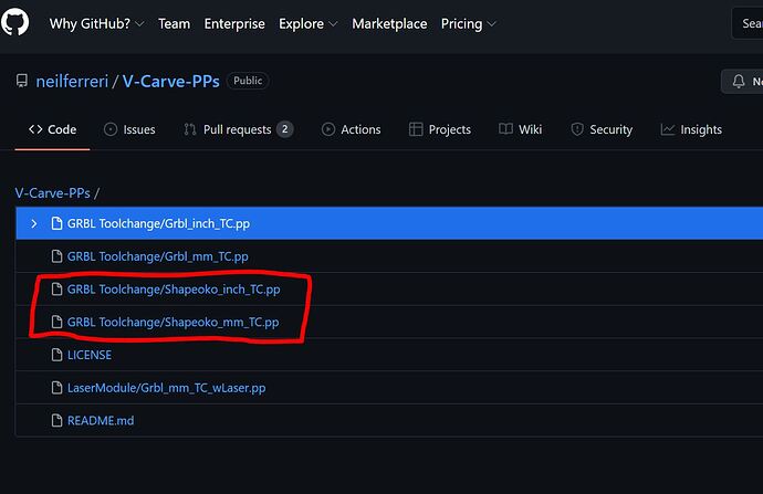

@neilferreri If I add any of these posts to the myPostP folder, Vcarve does not start. I tried adding a few of their listed posts from the PostP folder and Vcarve starts without issue. If I add your posts to the PostP folder, I never see them. I’m at a loss to say for sure what the issue may be, but it’s definitely new to me. My Vcarve version is their latest v11.009
These are the github posts i’ve been using for ages without any issues @neilferreri
