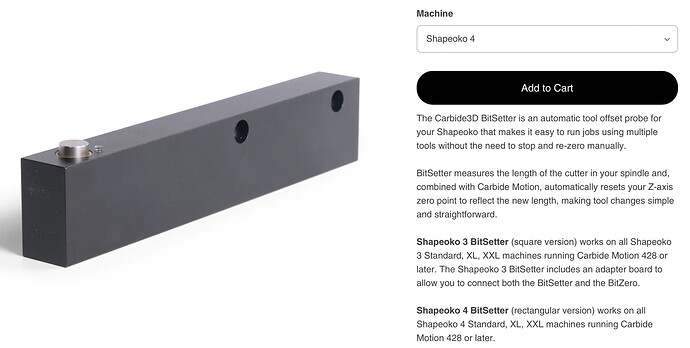

Is the bit setter compatible with the Shapeoko 4XL with hybrid table or do I need to purchase the bitzero V2
The BitSetter and BitZero are two separate products.
A BitSetter will allow your machine to manage tool length offsets so that you can run multiple tools in a single file — it comes in an SO4-specific version:
The BitZero is an accessory for setting origin relative to the plane or corner of rectangular stock — the original v1 was larger and lacked the hole of the v2 which along w/ the non-conductive bottom makes it a bit more flexible to use.
