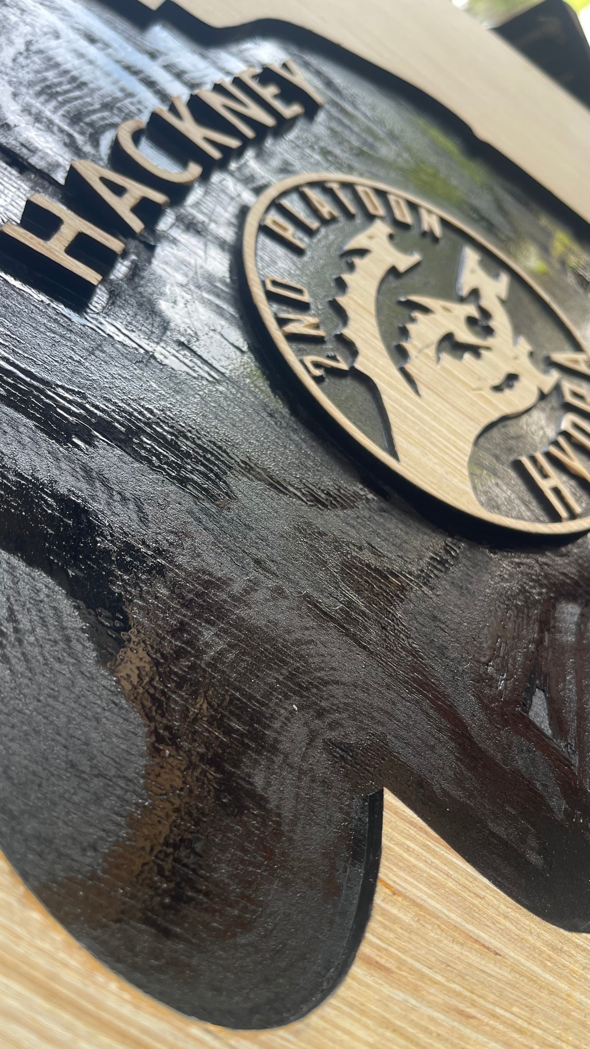

I was trying to set my work and noticed the bit setter button was off, the interior part was unscrewed, I was like well that’s an easy fix, so I screw it back, now I have a problem, I started to run a job and the dept that should be 1.5 mm is now 6 mm so yeah my job was ruined. So I tested the set the zero with the probe initialize and check the zero again and is way lower than the initial zero. so what am I missing here?

after I started the job just suck it up and have that deep pocket then I have a logo and with that design there was not issues
