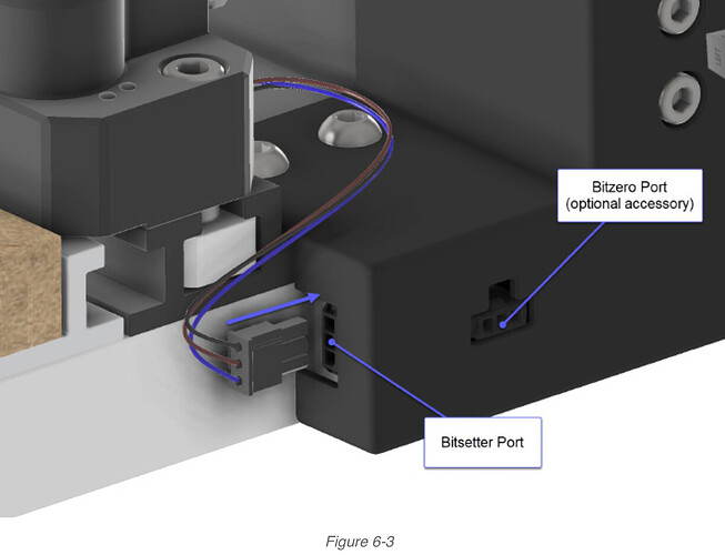

I’ve got a Shapeoko 5 Pro. In the bit zero installation video, it’s stated tgat there’s a port on the board marked “bit zero” and that’s you just “plug it in”. Well, my machine has no such port that I can find. I’ve looked everywhere and not only is there no port labeled “bit zero”, there is no port that looks like it will fit the bit zero plug. Am I missing something?
Update…there is a port on the front of the machine near the bitsetter port but there’s no label…is that the bit zero port?
As noted in the instructions:
the connector at the front of the machine is the BitZero port:
if your BitZero doesn’t have the right connector (white, Molex KK) then you have a BitZero for an SO3/4/Pro/HDM and will need to replace it.
