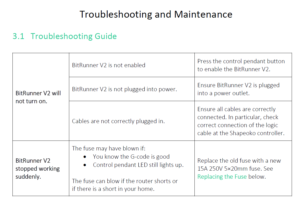

Double check on v2 of BitRunner if the fuse is blown. The V1 does not have a fuse but I believe the v2 does. On my V1 you can switch from Auto to Off to On. Not sure if they have the switch on the v2 but see if the router comes on manually or through the MDI command line.

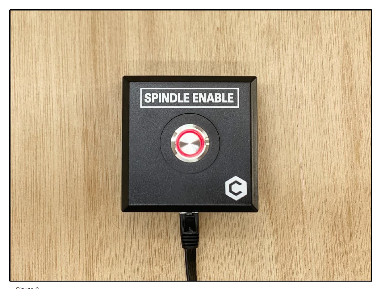

Did you check the Spindle Enable button?
If it is a v1 switch to “On” to see if router comes on. If it does not check the wiring to see if it has become unplugged or partially unplugged.
