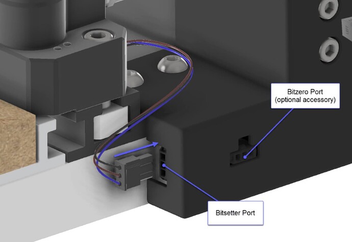

I am not finding the “CONTOLLER” on this to plug into. Kevin’s video on #4 has a box on the side of the gantry that the Pro 5 does NOT have. Can somebody provide a photo as to where the connections go? I have looked ALL OVER the gantry/body and main control box and I cannot find were I plug the female end into. This is VERY frustrating!!!
TIA
Are you using the “Sindle Adapter Cable” included with your SO5 Pro?
I think I had the same issue. What I found is the bit setter plugs in on the front right corner of the machine. The place is a little hard to find.
If folks mean the BitSetter/BitSero this is covered in the manual:
pg. 54
