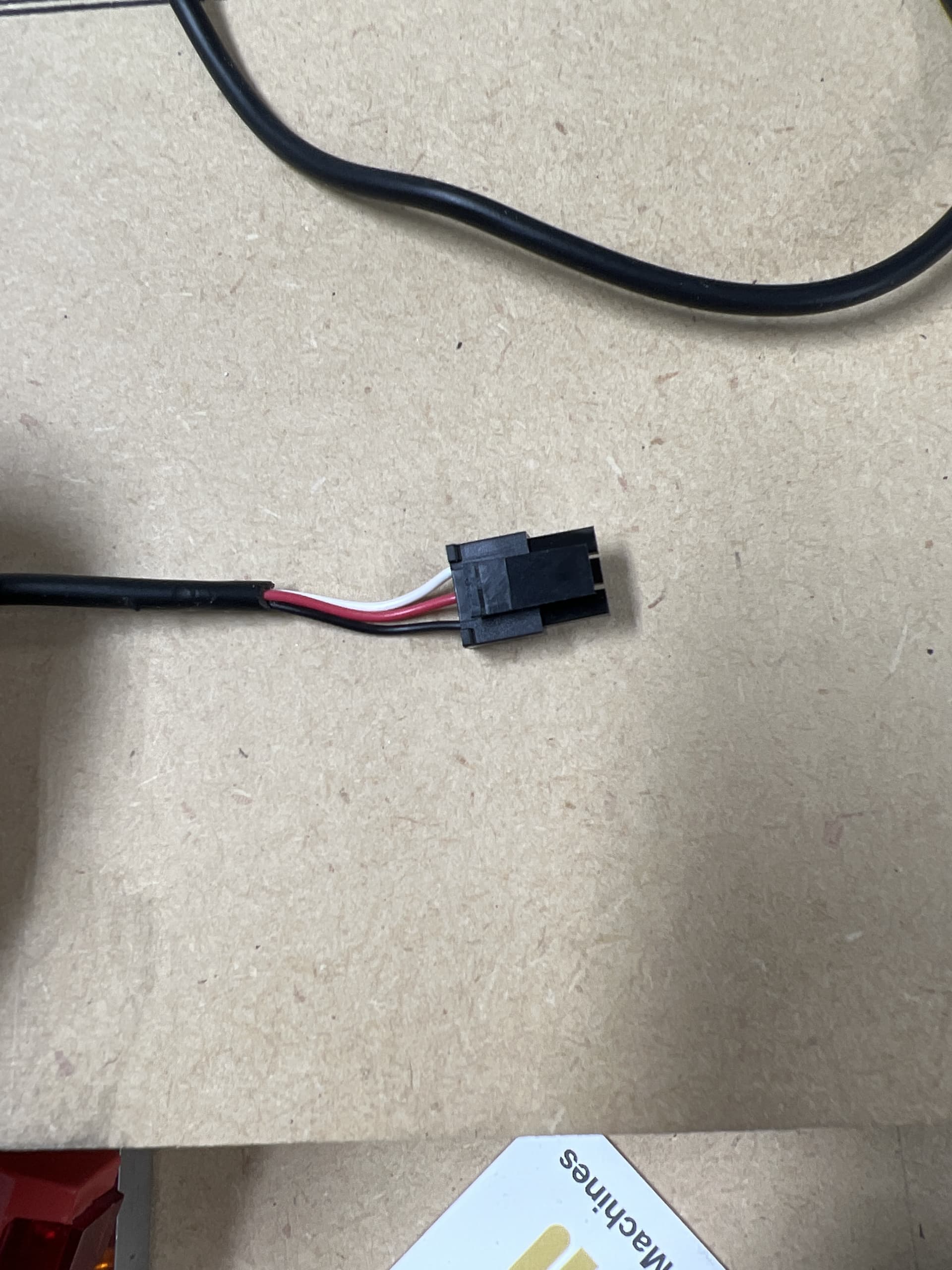

I bought a BitZero from Sparkfun and didn’t realize there were different connector configurations. I bought this a few months back and just now getting back into my machining project.
Mine arrived with a 3-pin white Molex connector and my Shapeoko 5 Pro looks to accept a black connector. Does anyone know, is this a Amphenol Micro Mate-n-Lok?
EDIT: Is this the connector? Micro MATE-N-LOK 3-position connector, female socket, 3mm pitch
https://www.digikey.com/en/products/detail/te-connectivity-amp-connectors/1445022-3/684982?s=N4IgTCBcDaIIwBYEFYAMYwFoDMIC6AvkA
Thanks to PaulieP for the wiring pinout:
Hey Folks-
Just wanted to shore up any information for someone who finds this in the future - I can confirm that connector is correct. I re-crimped the Micro MATE-N-LOK 3-position connector and everything fits perfectly.
More generally, this is a 3-pin, single row, female Molex MicroFit 3 connector (with clip). I already had a Bitzero that was being used with a Shapeoko 3, so I modified it by replacing the connector with one of these. That item includes both the connector and pins.
