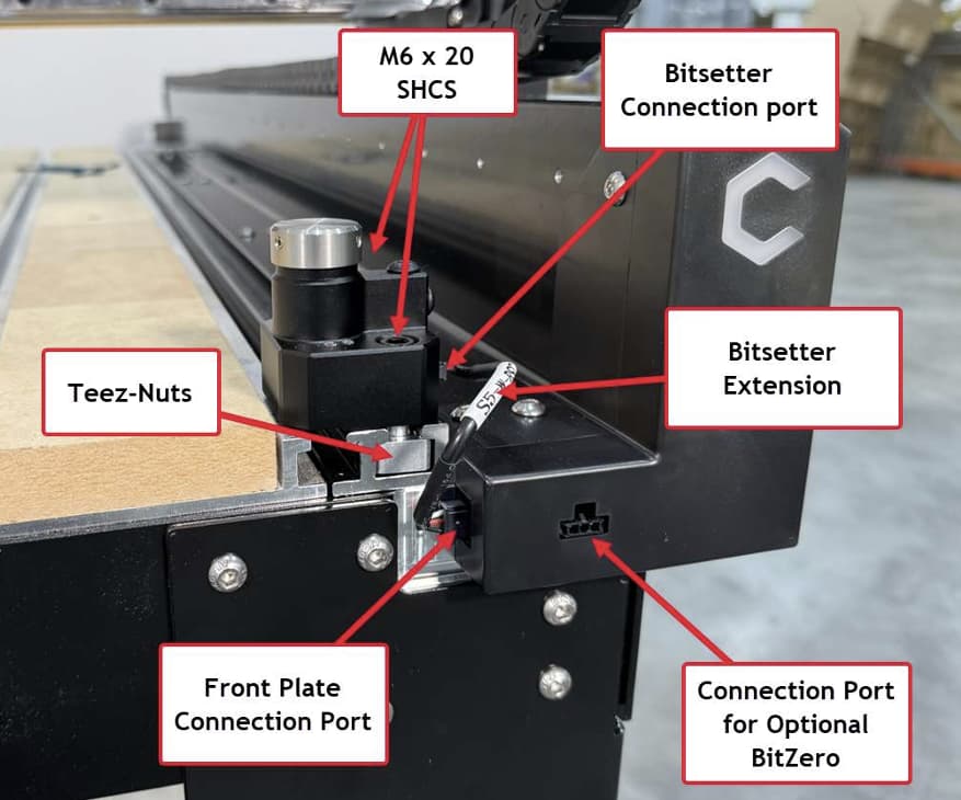

Hi there - Are there any videos available that show the end-to-end installation and setup process for the BitZero v2? I could only find setup, no installation.

Not a video but the manual is a good reference
https://guides.carbide3d.com/files/pdf/BitZero_V2_Shapeoko.pdf
Installation depends on the specific machine — for the SO5 Pro it’s plug into the BitZero port at the front of the machine:
For the SO4 and Pro there’s a BitZero/Probe connector on the controller, for the SO3 use the Reserved header as noted in the instructions, or if you have both a BitZero and BitSetter, the P(robe) connector on the PCB Expansion Adapter.
