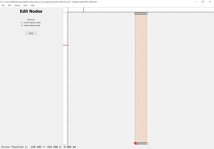

How do I set up a tool-path with horizontal motion to flatten a board in Carbide Create It wants to start in the middle and move in a rectangle pattern outward.

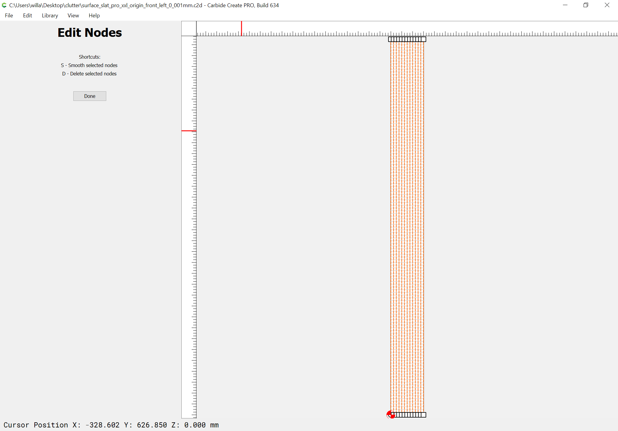

To control where the machine cuts you will need to draw the desired toolpath:
See:
surface_slat_pro_xxl_origin_front_left_0_001mm.c2d (12.2 KB)
