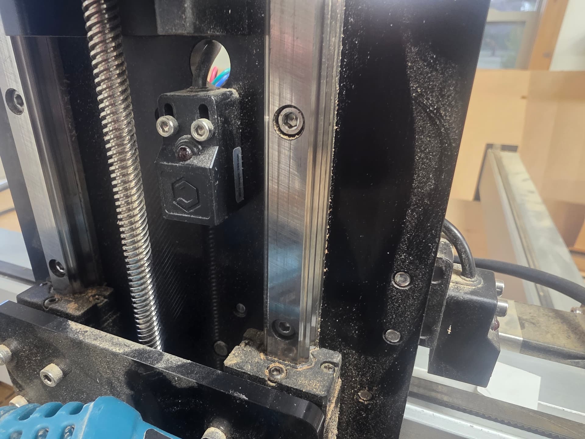

I tried to change over my Carbide Connect to a new laptop. When I did, the machine moved to the far right front corner and pulled off my Z limiting switch. I tried to rewire directly and now when I initialize, the router goes down and does not trip the Z switch and will not progress.

Photo of the switch in question?

It appears I have those switches
instead of going up with the Z drive and contacting the limiting switch, it is going down.
Thank you…I figured it out myself.
Just for future reference to people reading this post the Z-Plus and the Original BeltZ/HDZ run in opposite directions. So on and SO3/4 if your Z goes the wrong way on italicization you have the wrong Z selected.

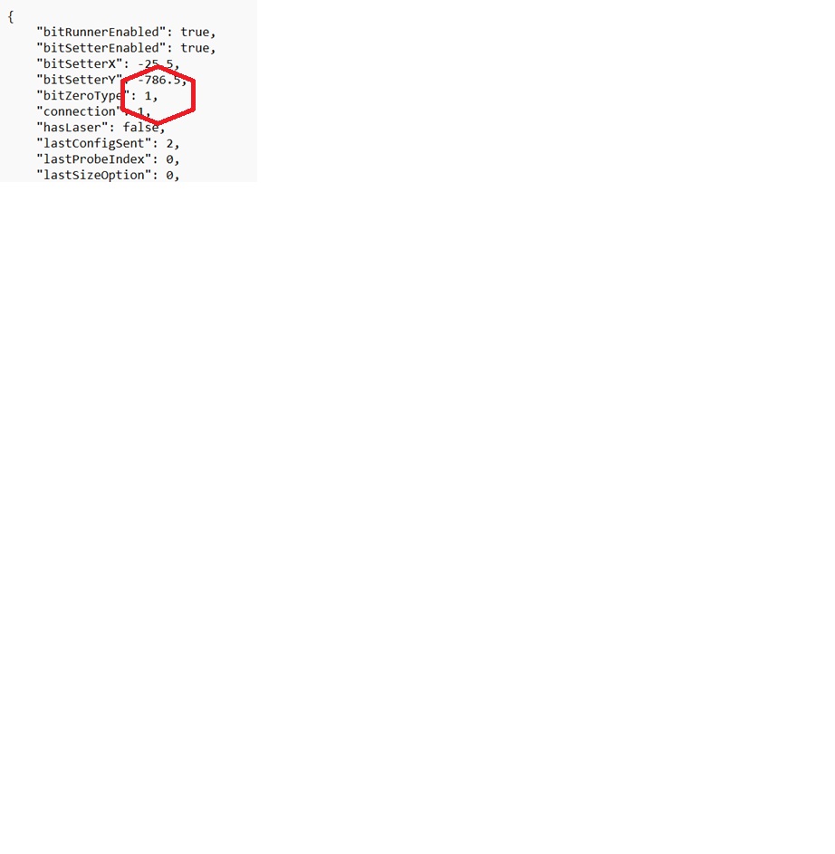

If you want to know what your configuration is:
Open Carbide Create. Then go to Help and About. Open Data Directory. Open the Carbide Motion directory and then open the shapeoko.json file. You will see the BitZero version. I have a v1 so I think yours will have a “2”.
If you change anything in shapeoko.json you have to quit Carbide Motion and restart it. The shapeoko.json file is only read on the opening of CM. The shapeoko.json file is just a text file.

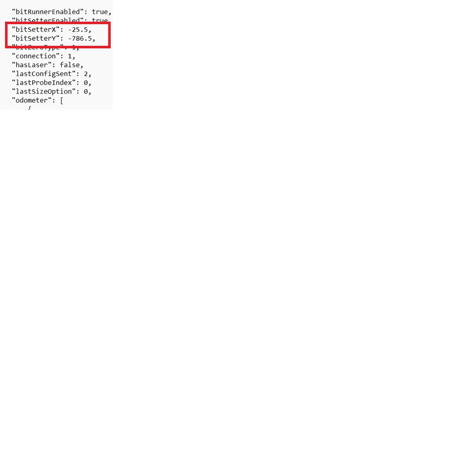

In the shapeoko.json file is the position set during setup of your BitSetter. The numbers are negative. When you initialize homing position is “Zero” position. All movements are negative relative to the home position. (machine internal coordinates).
