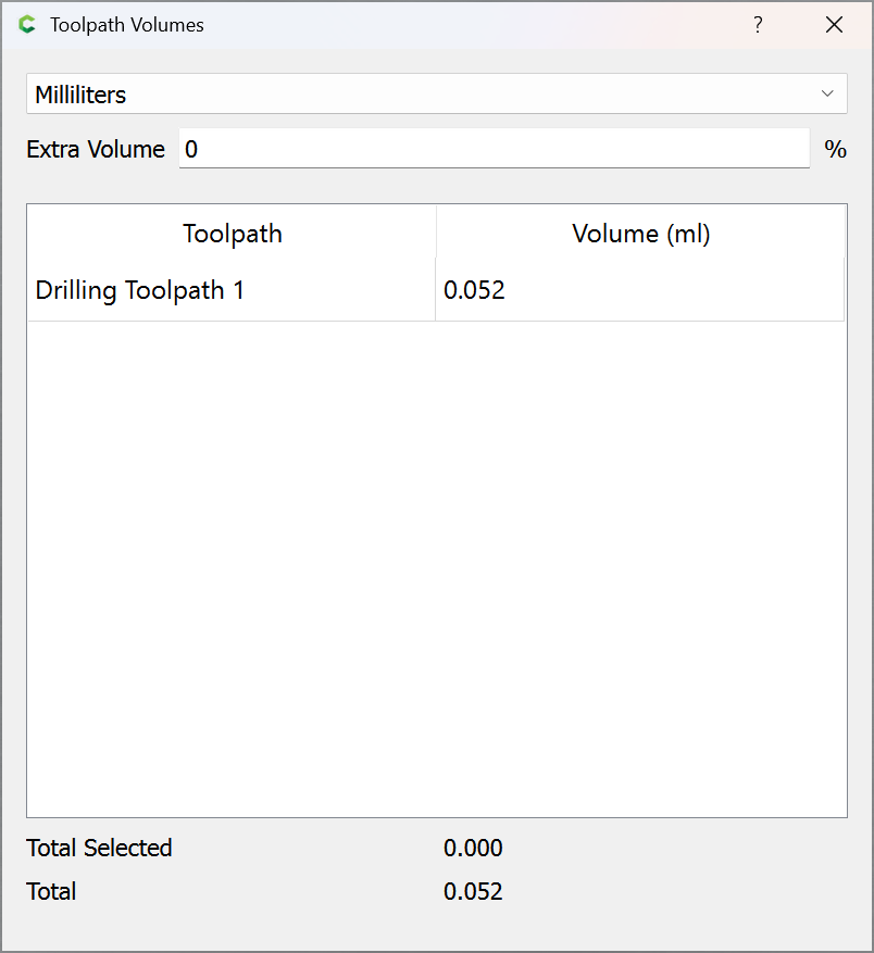

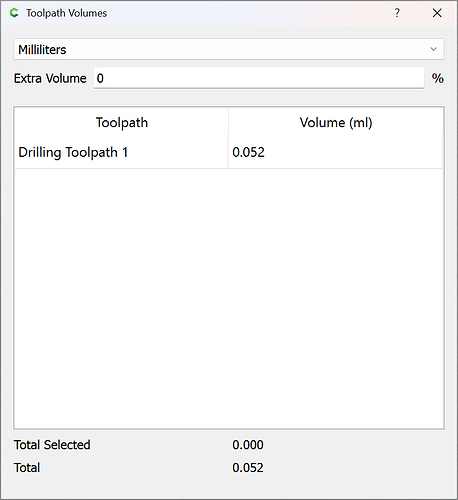

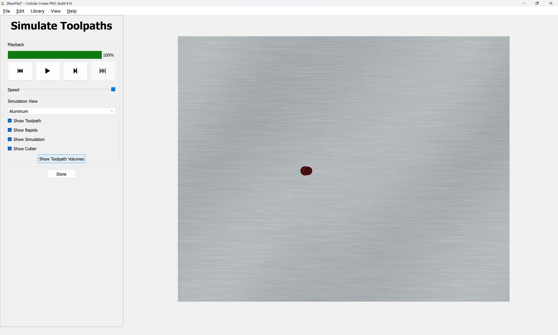

If you click the show toolpath volume button after you run the simulation. It will give you the volume in cu-in for each path.
I don’t see that option. I have Pro build 756.
I am using 816 pro. I don’t know how long it has been an option.
It’s a Pro feature:
click “Show Toolpath Volumes”
