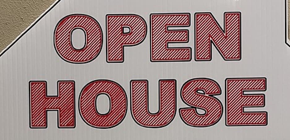

I want to make some sharpie signs to advertise an estate sale, using big block letters that are partially filled in for visibility, like the red hashing in this picture:

Ha ha. That was my sign from a year ago. House finally sold!
Notice that I used a black outline around the letters to make them stand out better. Get it spaced right though so it doesn’t bleed with the color.

EDIT: come to think of it, I actually created that as a demo for a realtor much longer ago and used a Dragknife to cut the coroplast into the shape of a house. But I did use it at our house when we finally convinced our realtor to do an open house.
