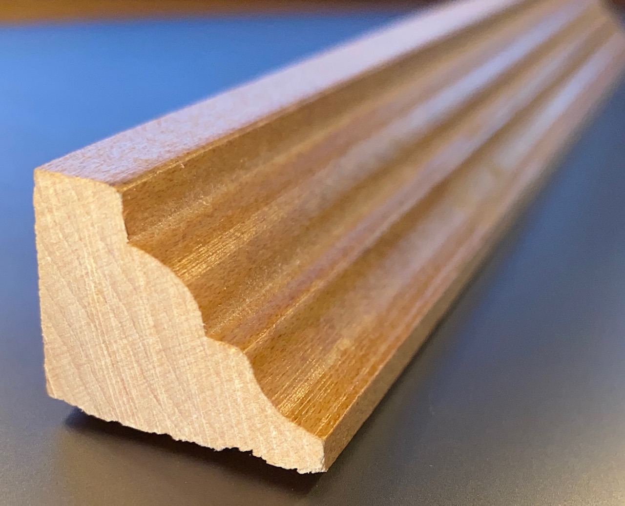

Can I make this molding on Shapeoko?
I need a 2-foot piece of maple molding for my kitchen cabinets, like the one pictured. Cross section is 3/4" by 15/16". Yeah, I could buy conventional router bits and make it the old-fashioned way by routing the profile into the edge of a board, but here’s a chance for a CNC project. Can this be done in Carbide Create Pro (which I have)?

Alternately, if it can be multiple pieces it’s “just” a board or two, a piece of quarter round, and a piece of cove molding.
I can get the cove to happen in CC Pro…but how do you get the roundover portion?
For projects like this I will take a picture of the end of the molding with a ruler in the picture. I will then add that picture into a modeling software and trace the object and scale it correct. I have been able to get very accurate results. Here is a good video on it https://youtu.be/dUiIAb1YqeM

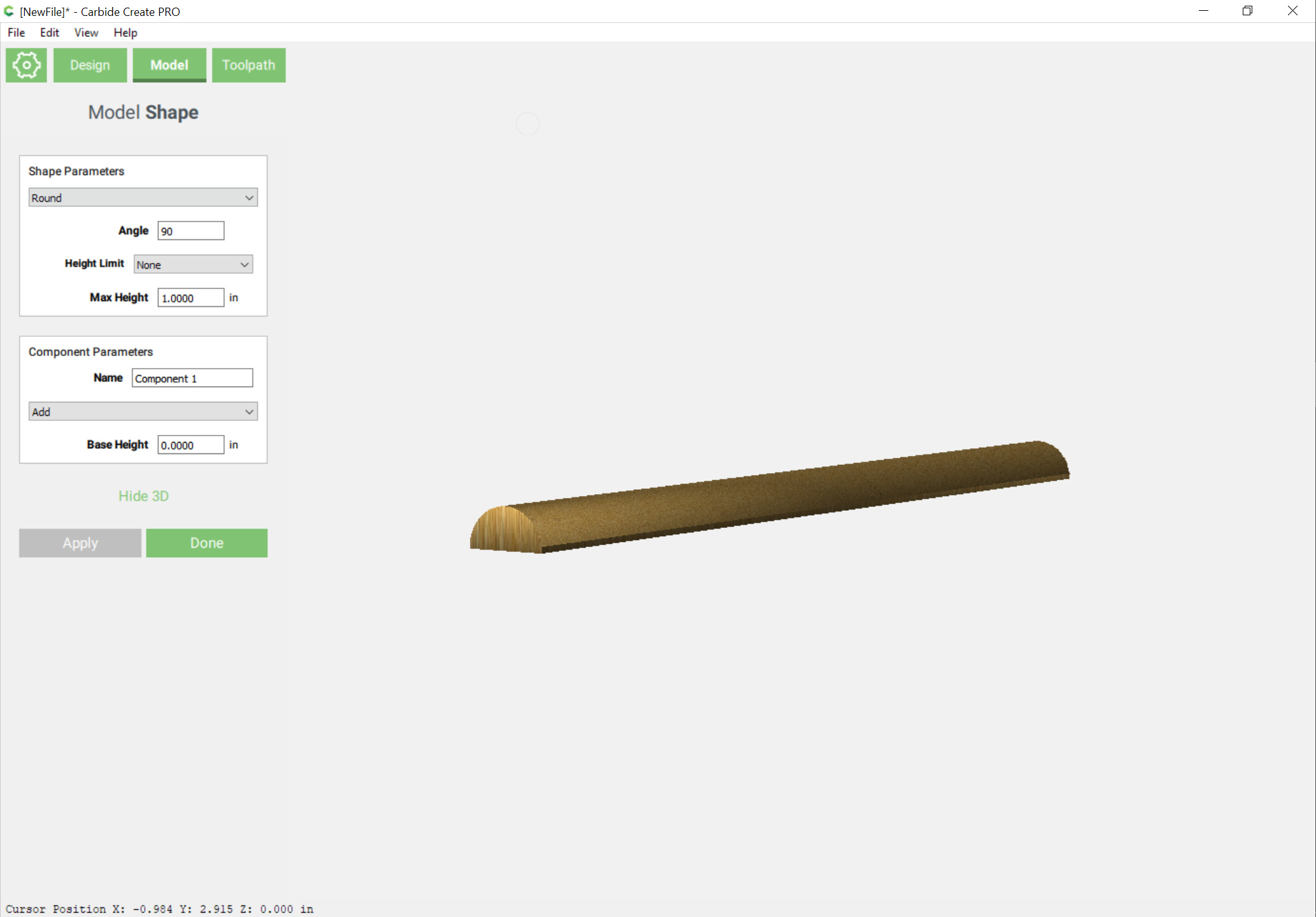

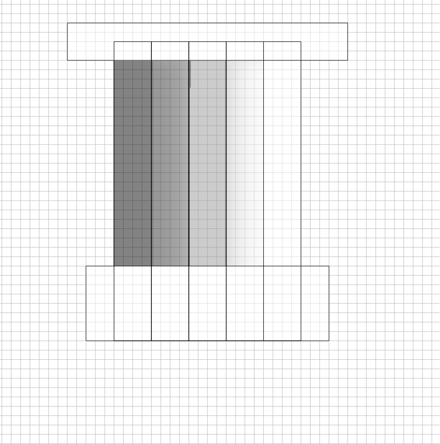

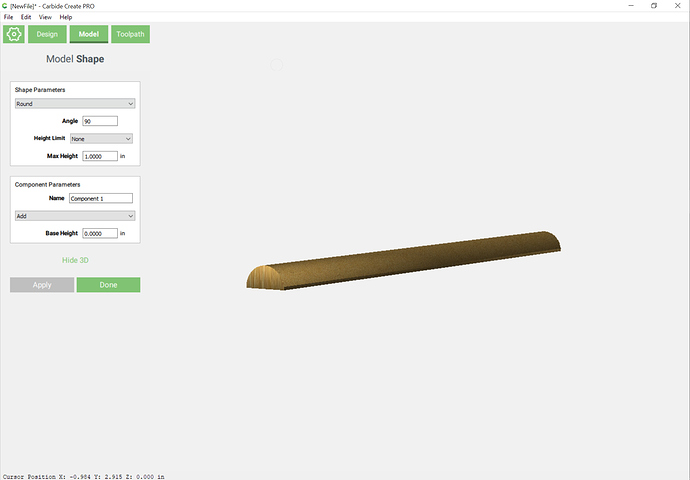

For the roundover you’d need a rectangle which is twice as wide as necessary:
Then you could add the rectangle as an equal height:

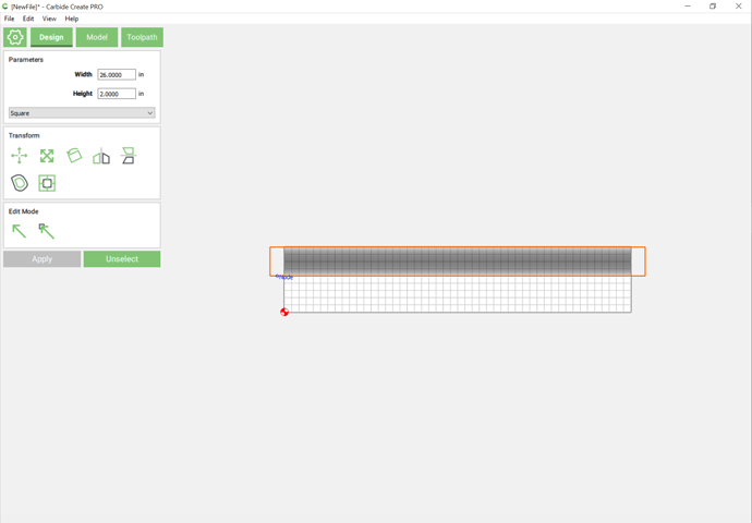

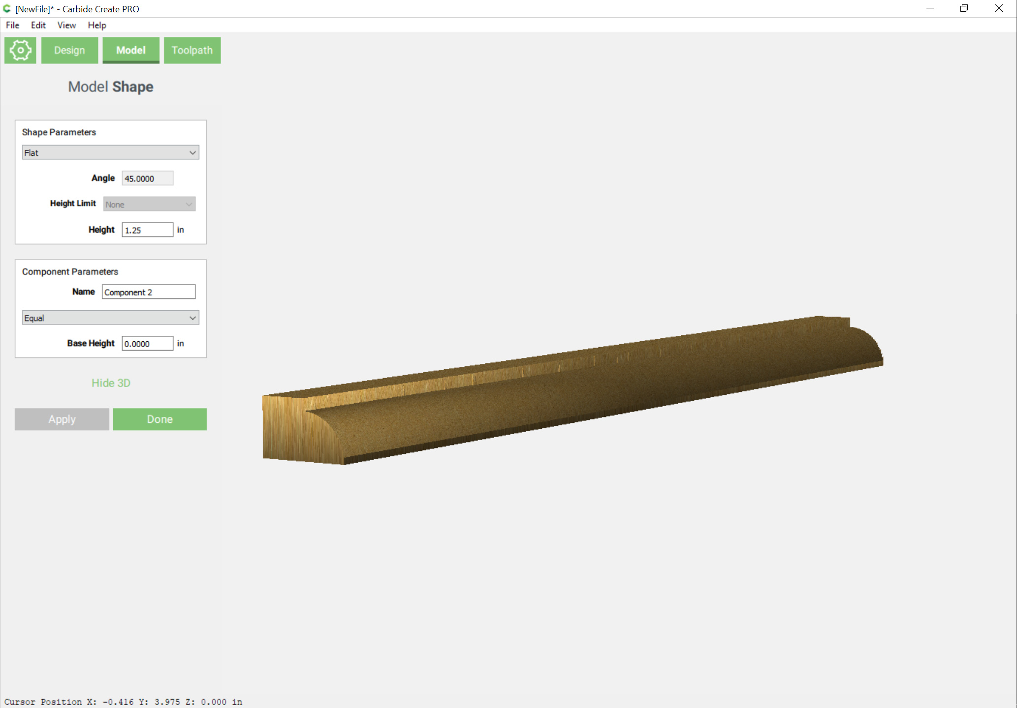

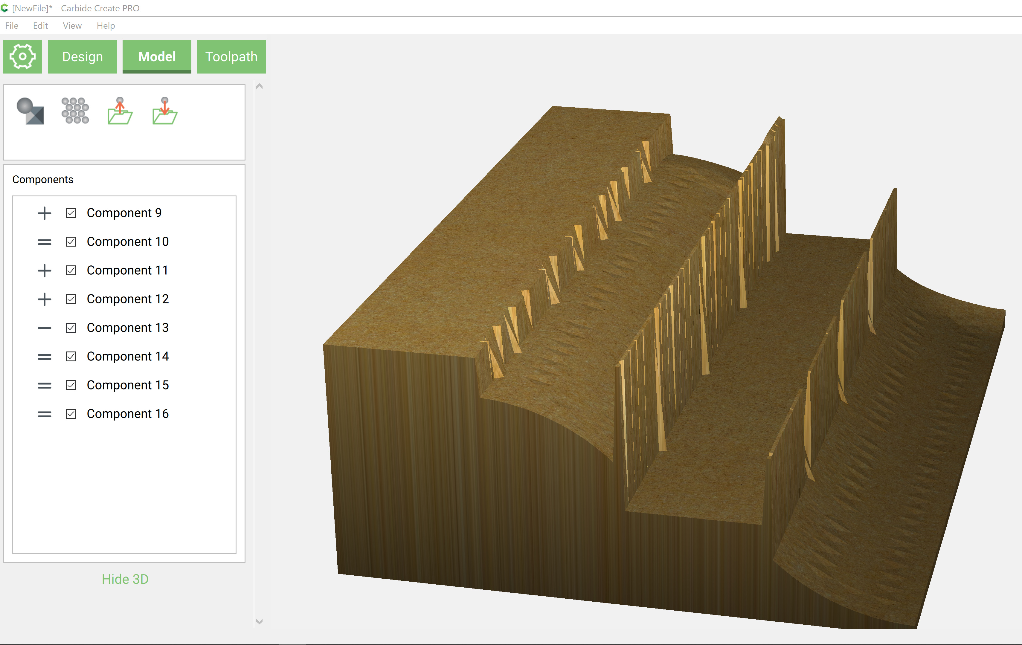

OK…using Will’s technique, I took a shot at this. This is really ugly, but I’m getting the general shapes. It’s REALLY hard to re-edit, once you’ve created the component (pressed “Done”), and changing the size of the shape after you’ve created the component doesn’t seem to resize the component (like toolpaths do), so I couldn’t adjust the sizes and widths…but you might get an idea.
Can anyone tell me what those spikes are between boxes? The boxes in the design are all snapped together, so they are not separated at all.

Could you post the file and the dimensions or a scale drawing of the profile?
