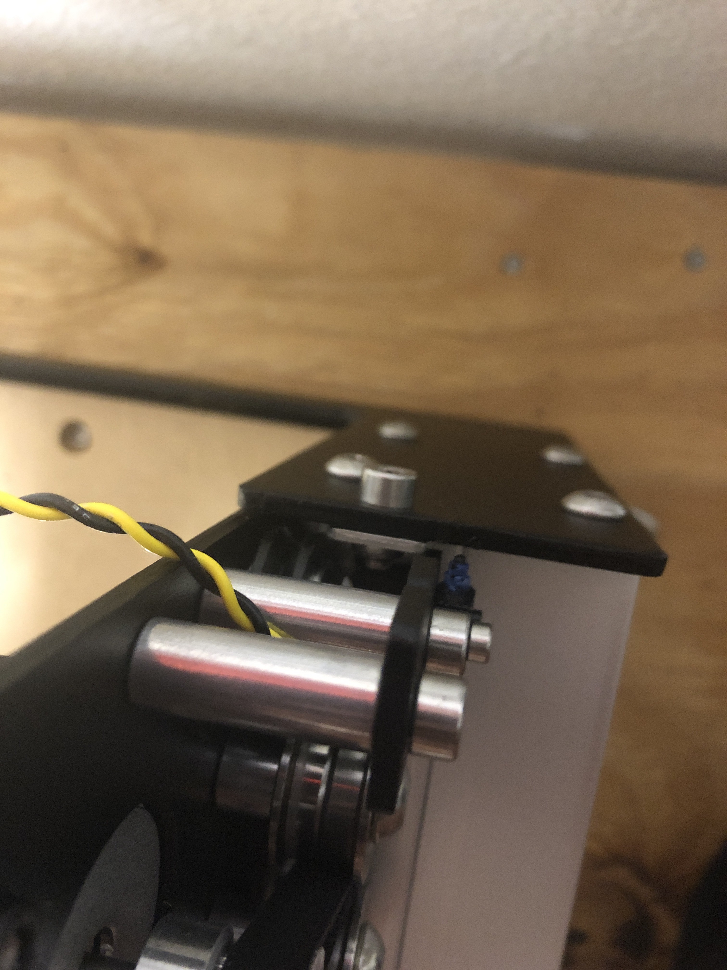

I am experiencing a bumping/vibrating occurrence when homing in the machine. I just finished assembling everything which seemed to go fine. Now I am stuck. I hope this video helps explain my issue.

@neilferreri I did notice the switch is not being engaged because the switch plate is bumping into the belt buckle. It’s like the alignment isn’t quite precise. I will have to try and make some adjustments. Do you have any suggestions?

Got any washers? Make that spacer a little longer by adding them.
Forgive my ignorance. This is my very first CNC and learning as I go. Where do you suggest I put the washers? On the switch itself?
On either end of the spacer, effectively making it longer so the switch clears the belt clip.
Sounds good. I’ll try that out and let you know. Thanks.
Alternatively, I have twisted the position of the belt slightly by releasing the cap screw and turning the L bracket a bit so the V wheel clears the clip.

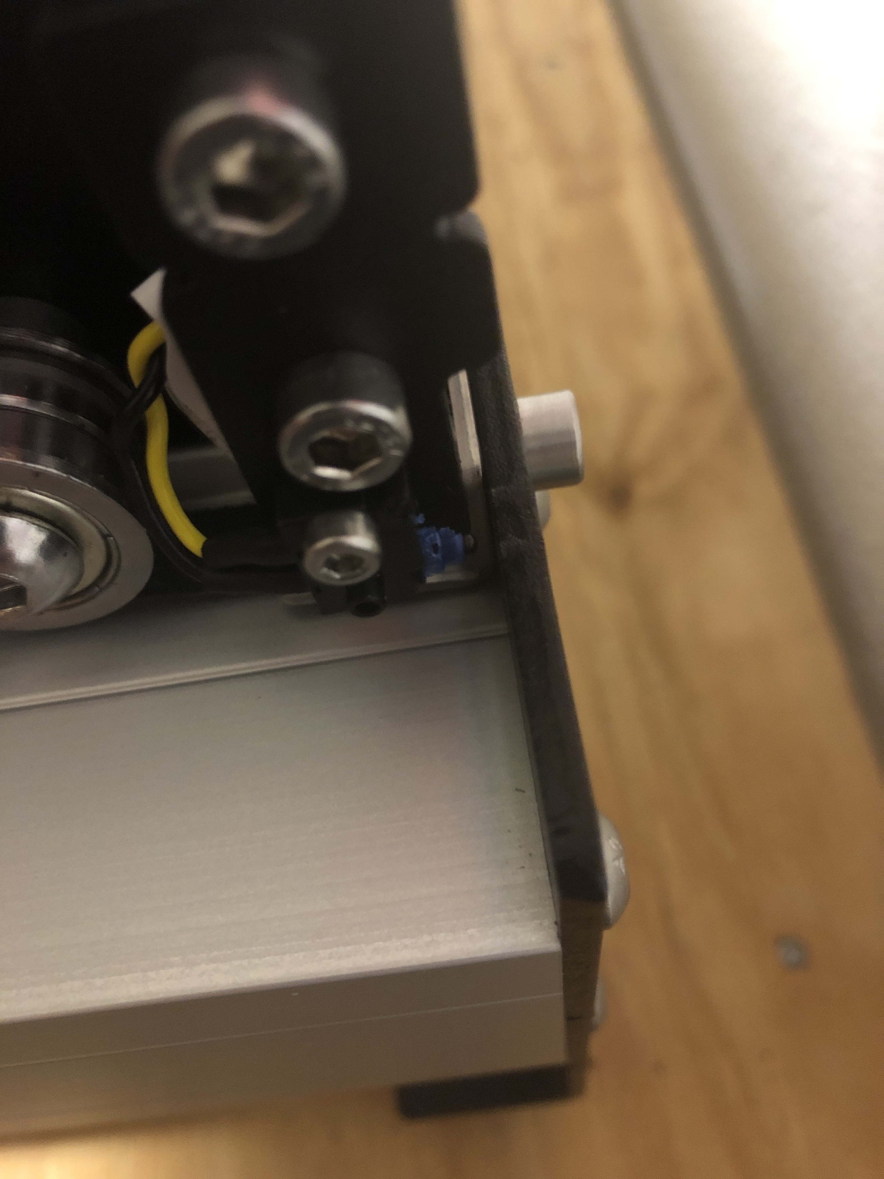

Yeah I got the y switch fixed. Now I need to get the x switch fixed. I’m messing around with it right now. The washer idea was genius.
@neilferreri I got it working! Thanks so much for your help. I am sure I will have more questions later on. I will be sure to reach out. Cheers.
Great! What was wrong with the X?
Similar issue. It wasn’t being engaged so I had to adjust the screws and spacers a bit to turn the switch just enough to touch the end. @neilferreri
