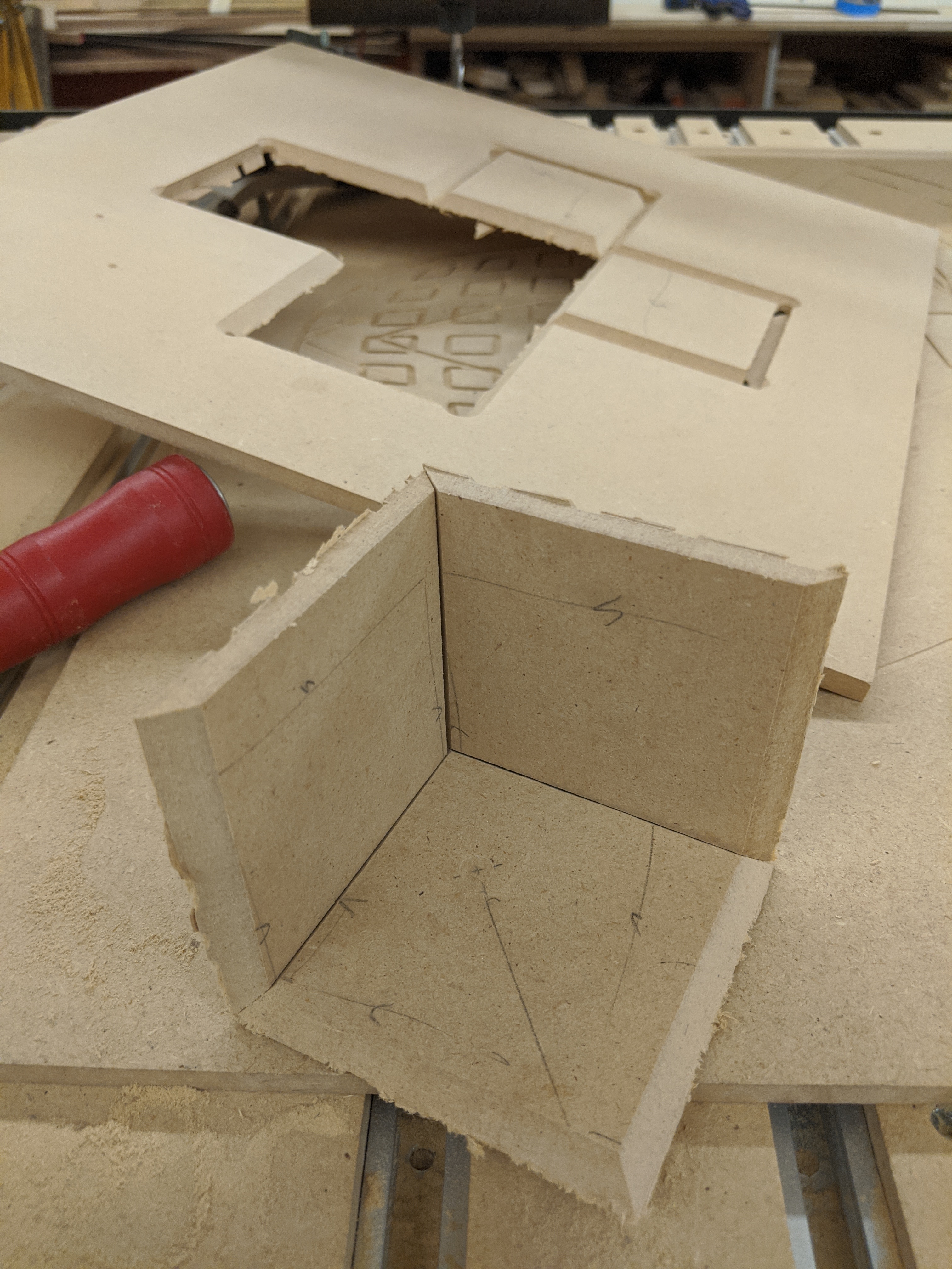

Can the Shapeoko cut 45 degree mitre joints?
I checked it is a 1/2 inch shank. Sorry.
Ah thanks for checking. Someone posted a $$$ one in this tread (110$!) But it MIGHT be worth it to us as we build this.

now you can of course make 3 cuts with that to make it look wider (upto 1"), first make 2 cuts parallel to eachother at the 1/2" width of each side, leaving a little ridge in the middle, and then a 3rd cut deeper in the middle.
if you pick the right locations for the cuts the deeper cut stops and ā€œcontinuesā€ the side wall from the first 2 cuts
I think your ā€œ45ā€ is usually called ā€œ90ā€ on this forum, but yes I’ve seen bit manufacturers call them ā€œ45.ā€ It can be confusing.
100%. I guess I lean on saying 45 as that’s the cut it ultimate creates. But yes, 90 degrees. :wink:
You cannot make a vector on a line in Carbide create, you need a closed vector. You could use a rectangle an go around or a rectangle that is only a mm or so wide so it basically is a line.
Contrary to what is being said here, I have made several very sturdy cabinets with plywood albeit I used glue and screws but no pocket screws. I made many boxes using 0.20in plywood, some using the 45 deg method and no screws or nails while others use joinery.
you CAN do a vector on a line in carbide create.
Well I stand corrected, I don’t use CC very often and it had been a limitation. I tried it it works but the simulation does not show a V-bit toolpath using a contour toolpath.
Correct. Unfortunately, Carbide Create won’t preview when using a V endmill unless it’s used for a V carving toolpath.

Oh really? It can’t cut along a line without a closed vector/loop? I’d PROBABLY just try to make it 1mm wide…
I’ll post when I have a test done.
Good to know. I think I can make this happen without the preview.
The newer versions of CC allows you to run a toolpath that follows a line that is not a closed vector. I corrected myself after @fenrus pointed it out.
Ah cool. I’ll have to download it before attempting this…as I’m sure my version is over 2 years old.
Cheers!
Did a test cut this weekend with some scrap wood. We’re aiming to cut 1/4", So I’ll need a bigger Vbit, but I think this will work for us.

If you leave an onion skin, you can just fold the pieces in place.
technically you don’t need a bigger bit, just more passes, but from a reliability/usability angle it’s much easier to get a bigger bit, and they’re not insane expensive
