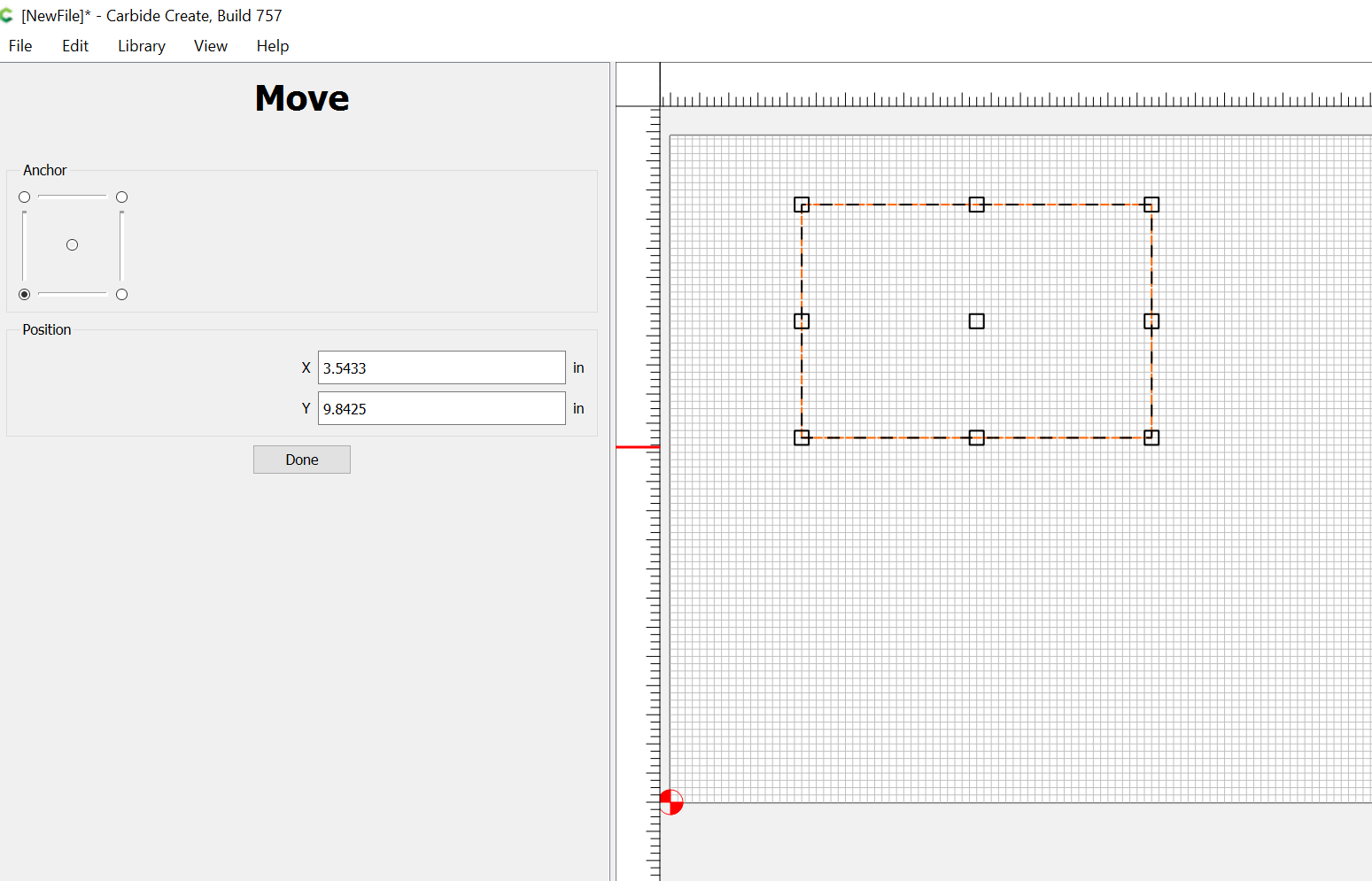

You can use the move tool to locate an object to a desired position. Pat attention to the anchor point.
Awesome thank you! I will give that a try now.
