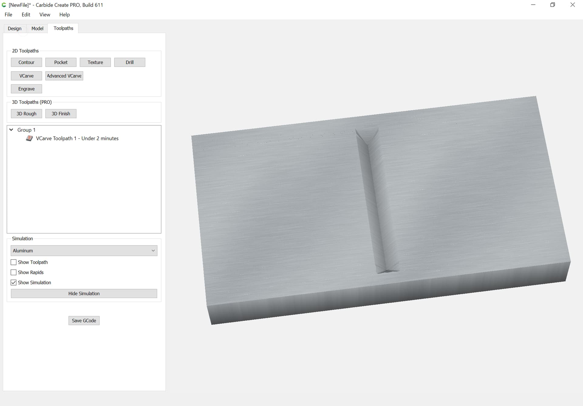

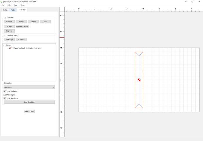

Hello All. I’m a fairly new user with a Shapeoko 3 XXL. I’m using carbide create (B 530) to draw a simple sign. I’m laying a line around the edge of the work piece using the rectangle to create the vectors. When I do the tool path for a Vcarve, it always create this X mark going from the corner to the center. I tried to run it and it did layout this X on the center instead of the border line. Any ideas what could be wrong? Thanks!
Toolpatherror|690x411

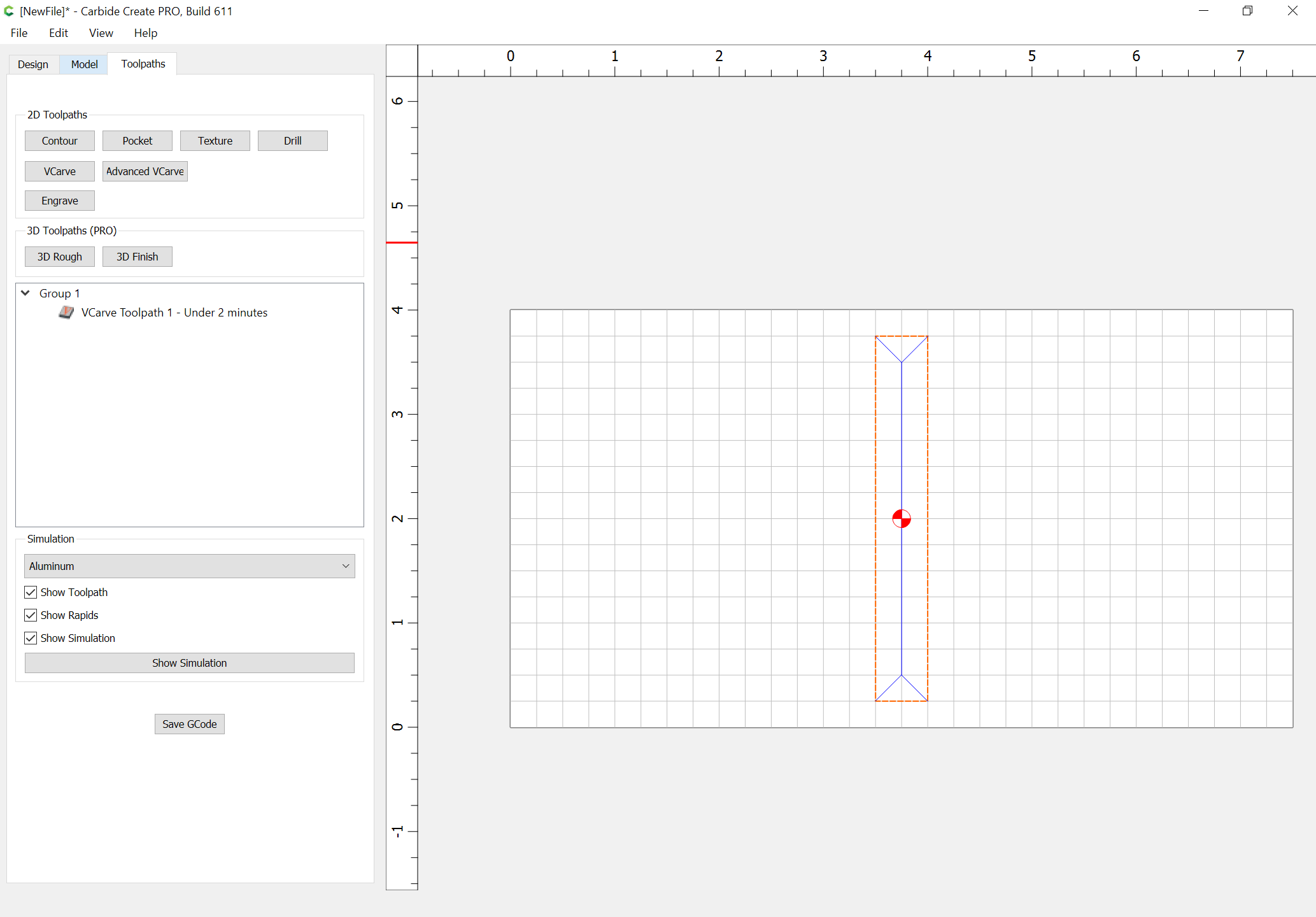

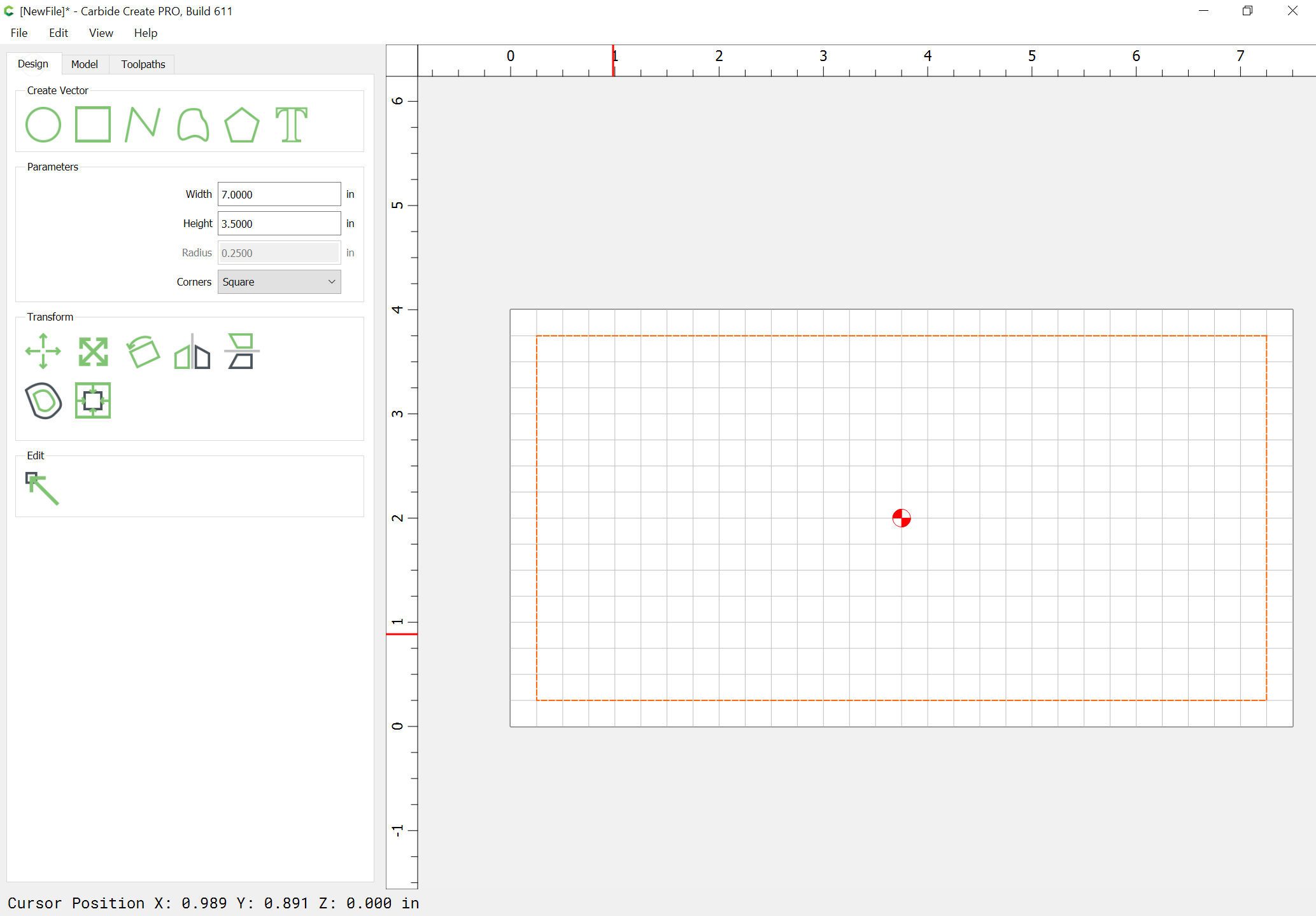

V carving is done based on the entire closed region:

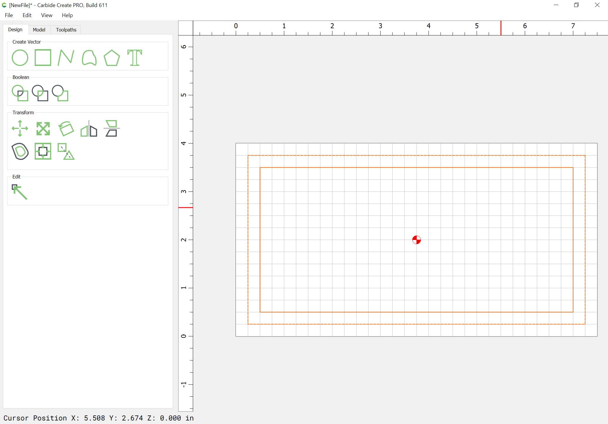

If want to do the surrounding region, then you need to do a pair of nested figures which describe the desired space, so instead of:
Please try:

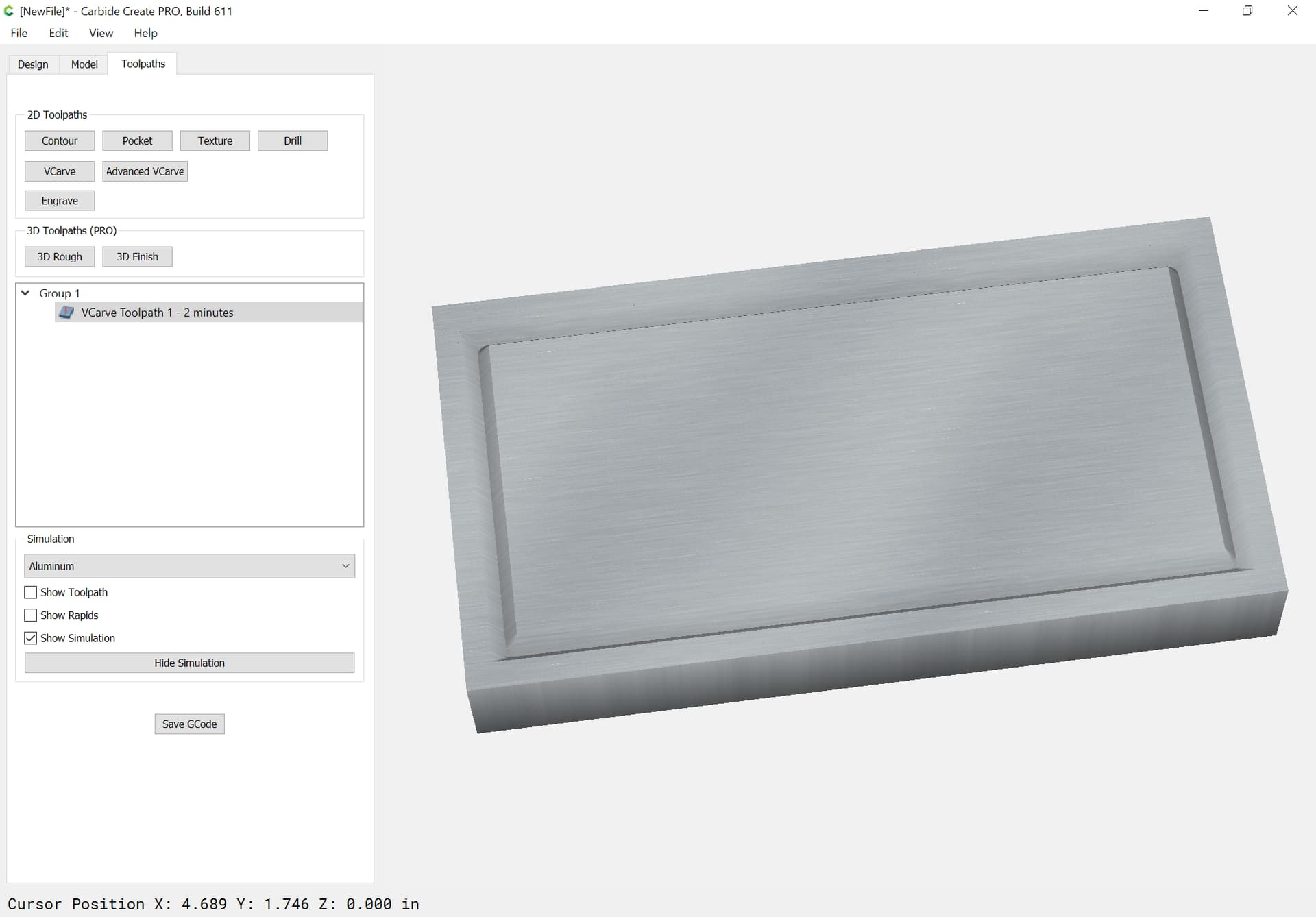

which will cut as:
That was the solution. Also nice to meet you, I have seen you provide a lot of support and that is much appreciated.
