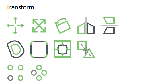

I think the problem is that once you get down to 3 points, deleting one doesn’t leave you with a well-formed vector, so it won’t let you.
If the goal is to completely remove the loops, you can ‘Ungroup’. Now you can select the loops independently, and delete them.
Select the object, then rightmost icon on the second row:
