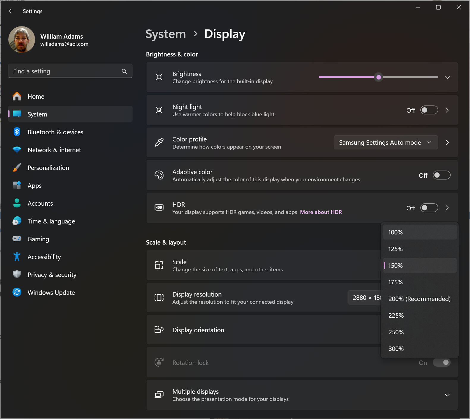

What screen scaling do you have set?
Note that Carbide Create requires:
Screen Display: 1280 x 1024
so if you have screen scaling set to any value greater than 100% your display will not meet the minimum system requirements.

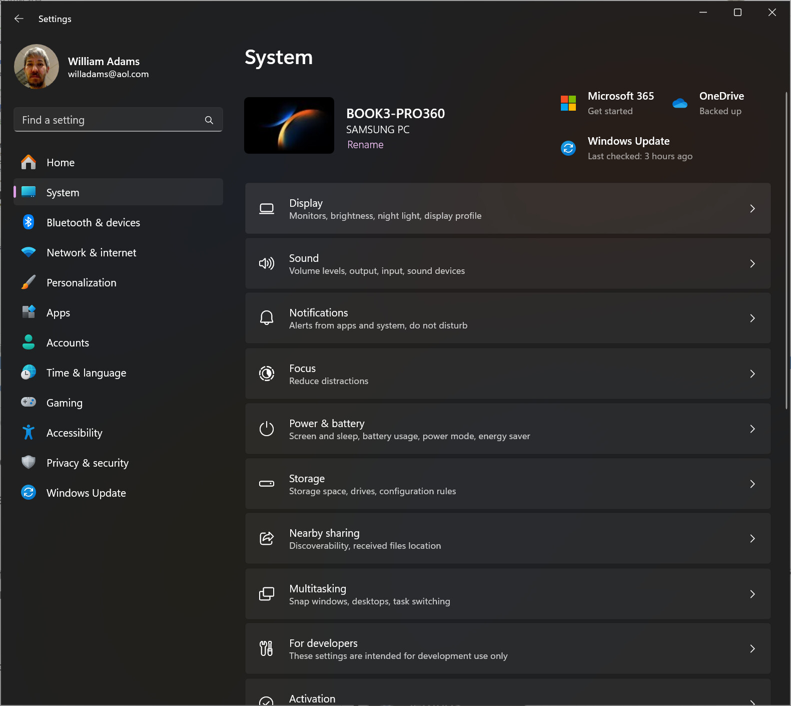

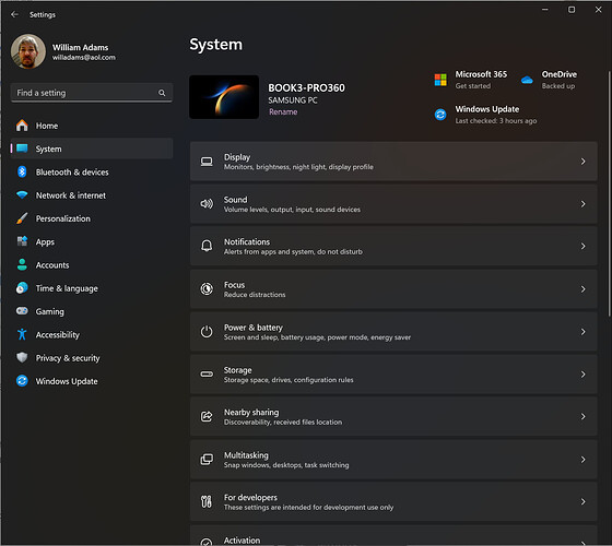

Go to Settings
System
Display:
and under Scale & Layout set Scale to 100%
Whoa, quick reply. And correct answer. I didn’t look into that because everything seemed the same as my other computer. Thanks.
