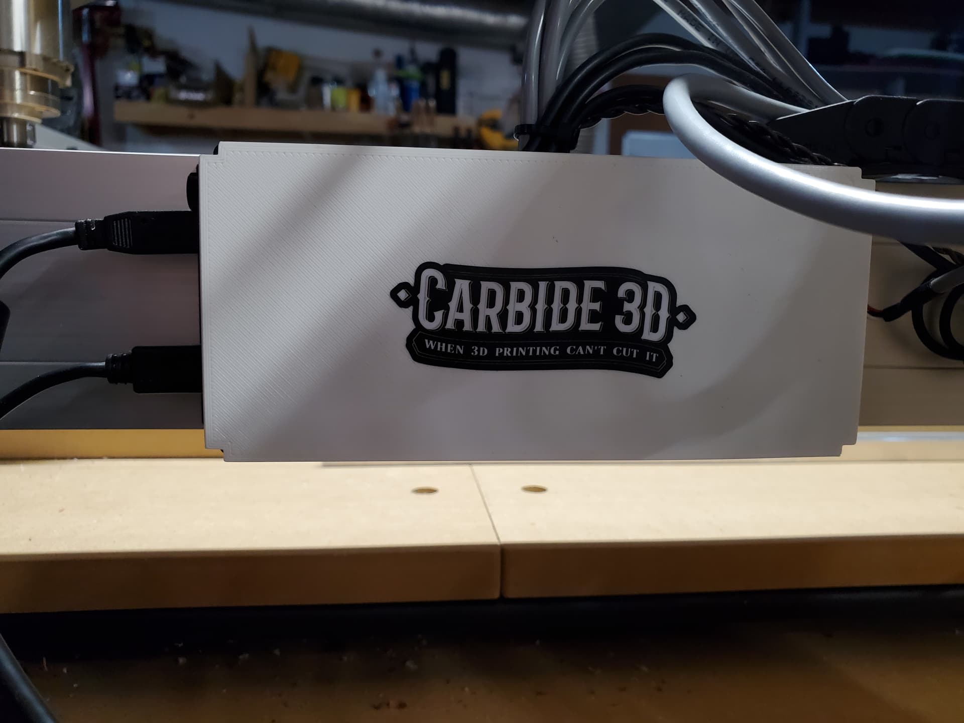

A little irony in my upgrade path this past weekend. As I had to replace my control board so that I had the required connection for the spindle, I purchased just the new board. Rather than purchase the board and case, I figured I’d just get the board and mount it in my base.
In hindsight I realized my cover didn’t have the slotted cover for the new plug. (facepalm)
Off to the Man Cave to fire up the 3D printer and design a new cover. A few measurements and a few minutes in Fusion and problem solved.
Got a fresh batch of stickers with my 65mm mount for the spindle and found the perfect one for use.
