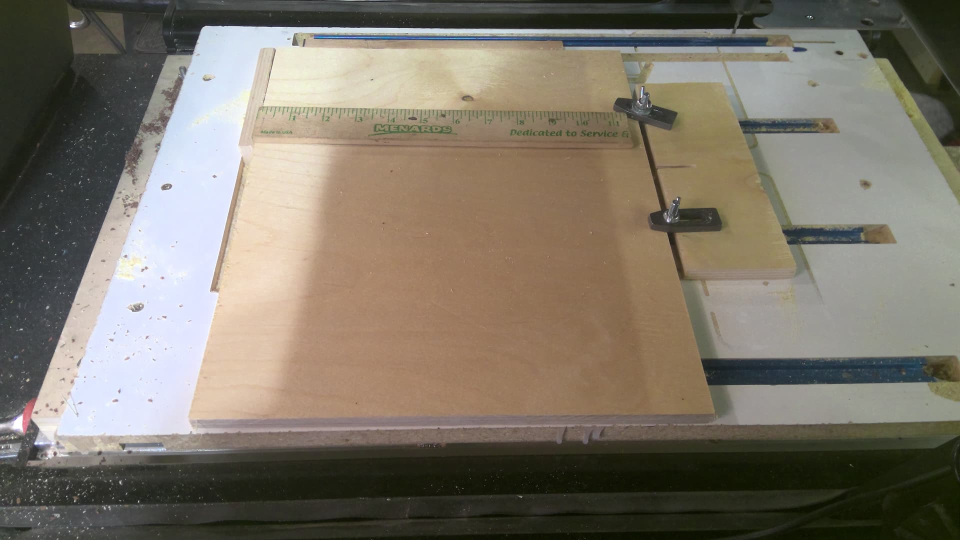

Please post a .c2d file, generated G-Code, step-by-step notes on how you are securing your stock and setting zero relative to it, and a photo, w/ a ruler showing an attempt at cutting still in place on the machine.

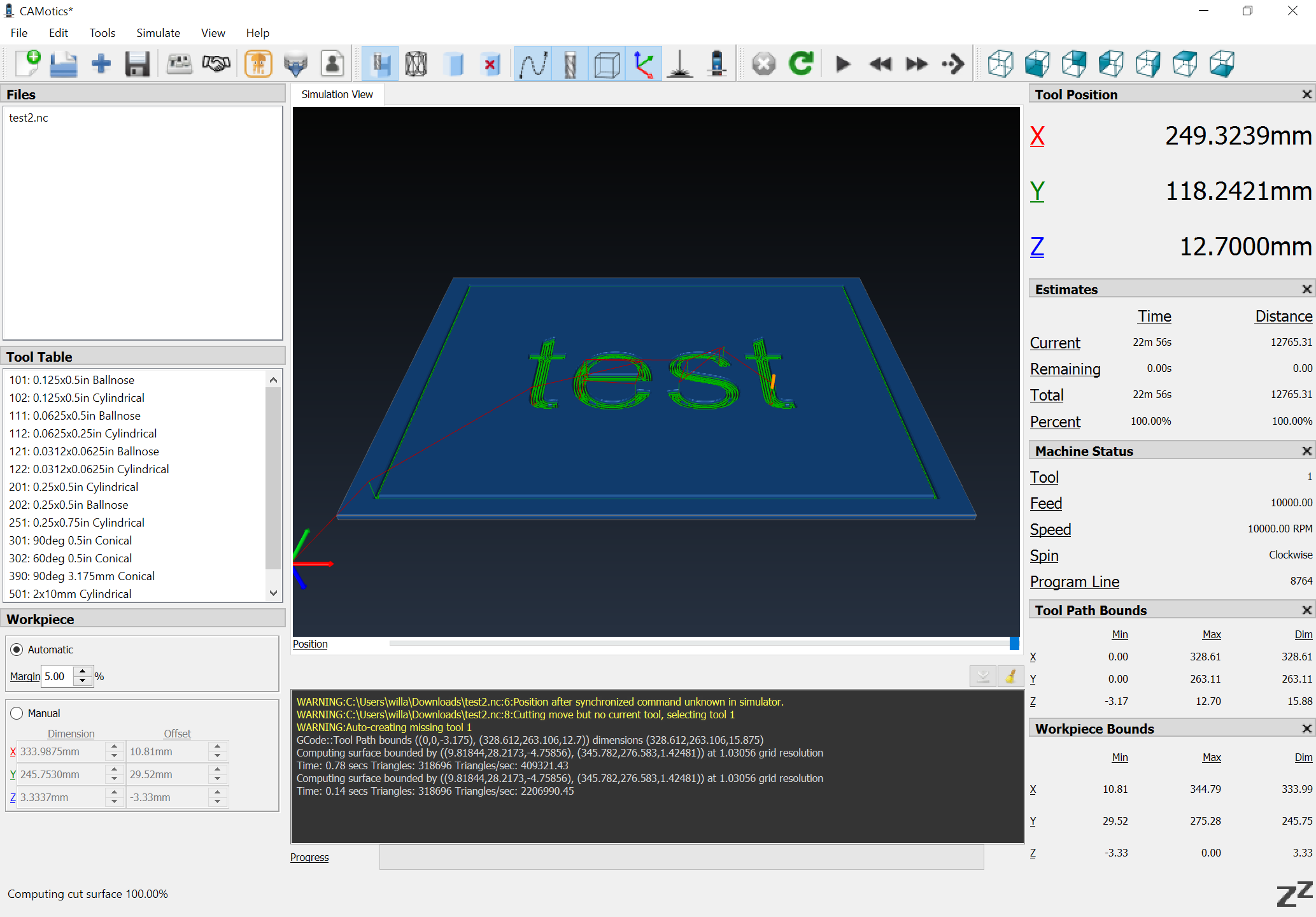

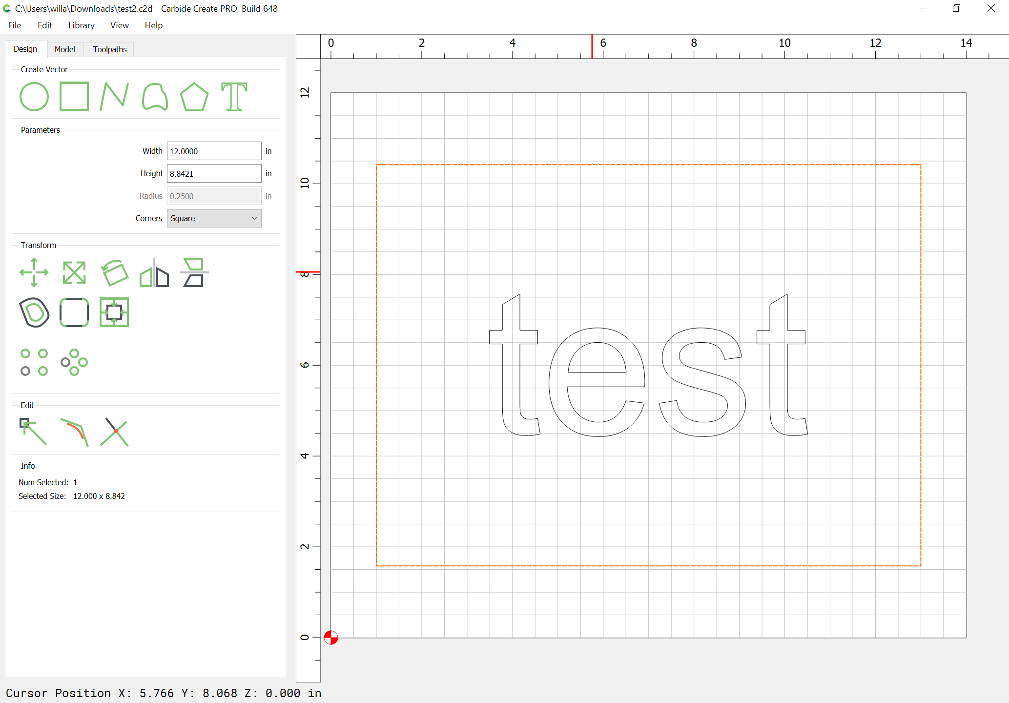

Okay the geometry is:
but you have specified using the #102 default — which isn’t supposed to be used — what size tool are you using? What feeds and speeds are appropriate to your machine?
The G-Code file is output using Imperial:
G90
G20
(Contour.T...)

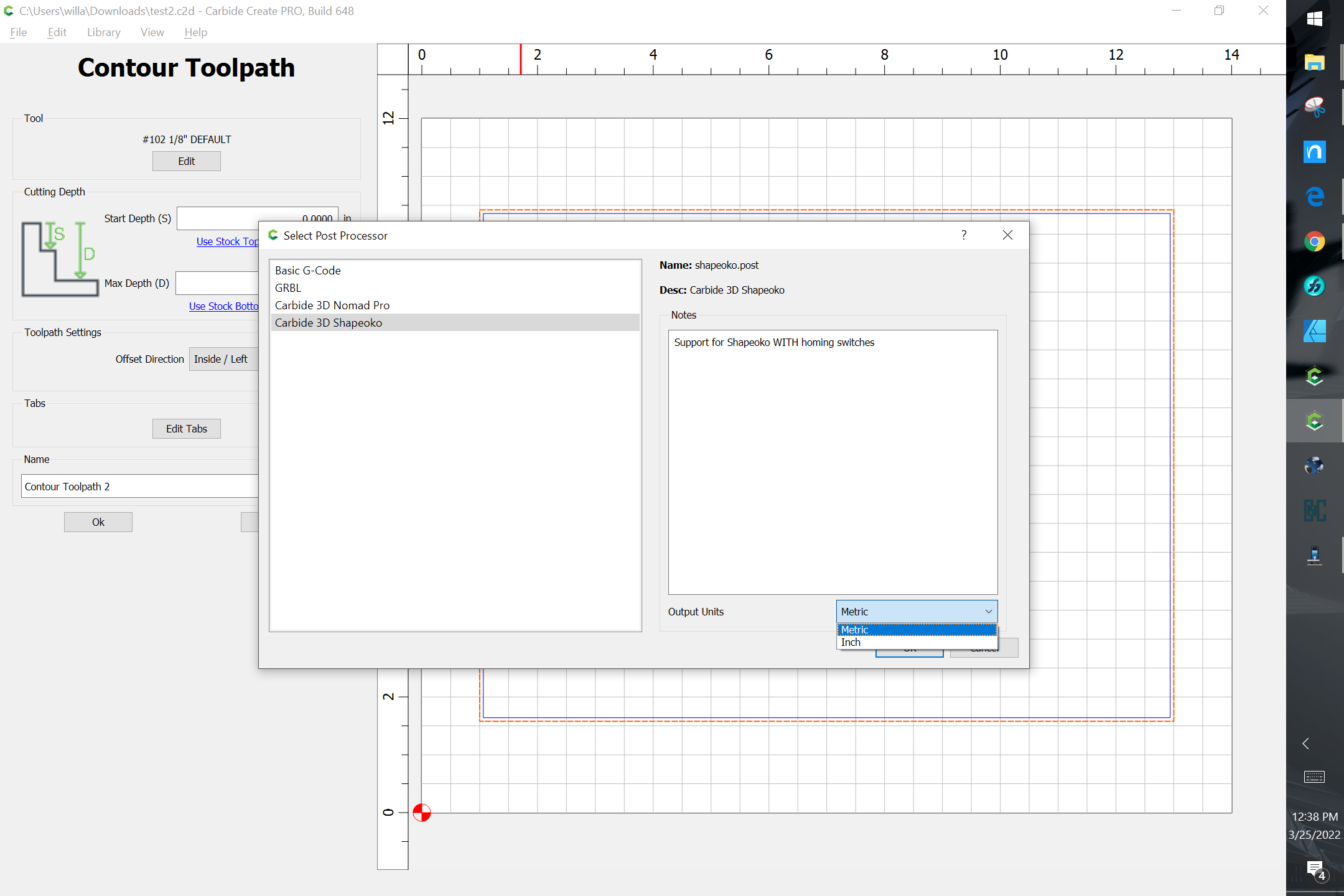

Does your controller accept the G20 command to switch to Imperial?
If it doesn’t change the output to metric under Edit | Select Post Processor:
(don’t change to Carbide 3D Shapeoko unless you have a C3D machine)
which would validate @Tod1d 's surmise.
The file should cut at:
328.61 − endmill diameter × 263.11 − endmill diameter
