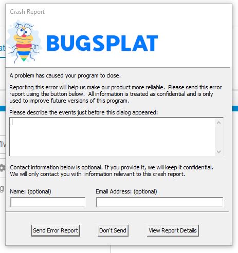

I have a problem creating a sign,
I want to make a sign of a Buddha, but when I select the contour, carbide create crashes and I see the bug screen.
I have added the SVG file to this message, can anyone give me some advice or see what I am doing wrong?
I am a beginner from Holland. :slight_smile:
This also happens on my PC and and 2e laptop (fresh install)
boeddha 1.c2d (448 KB)
bugsplat

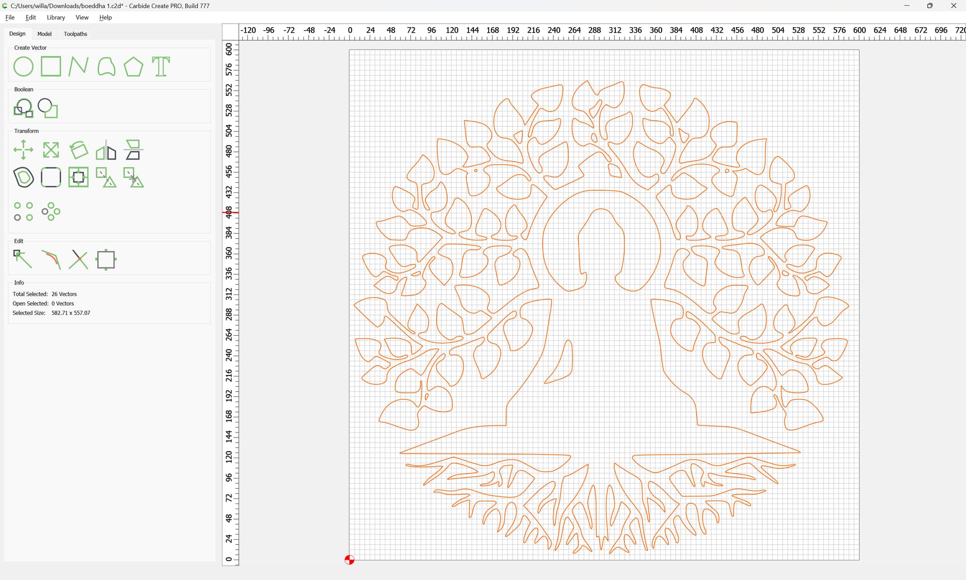

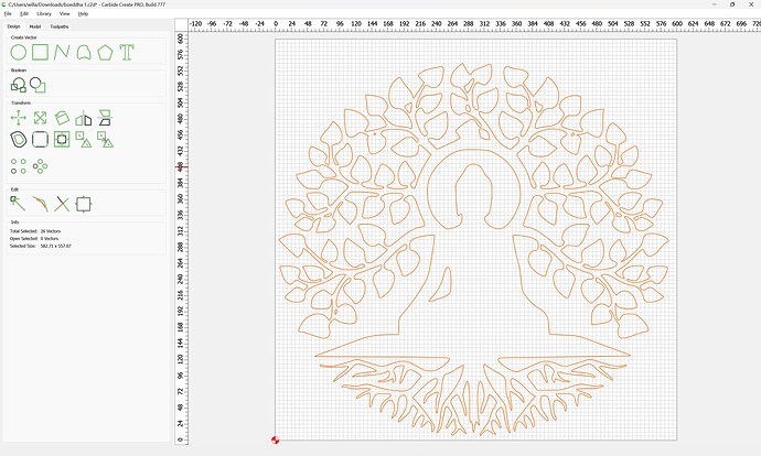

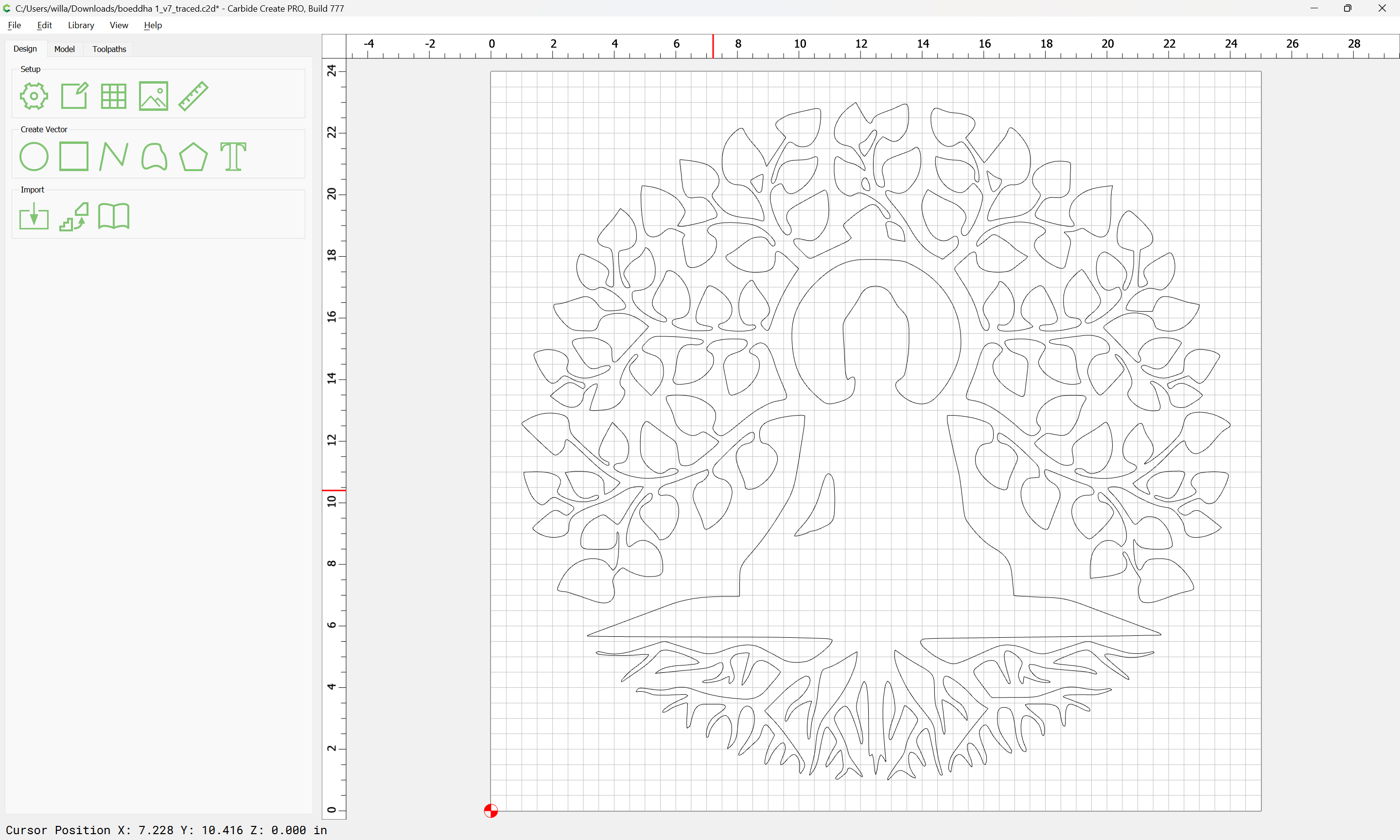

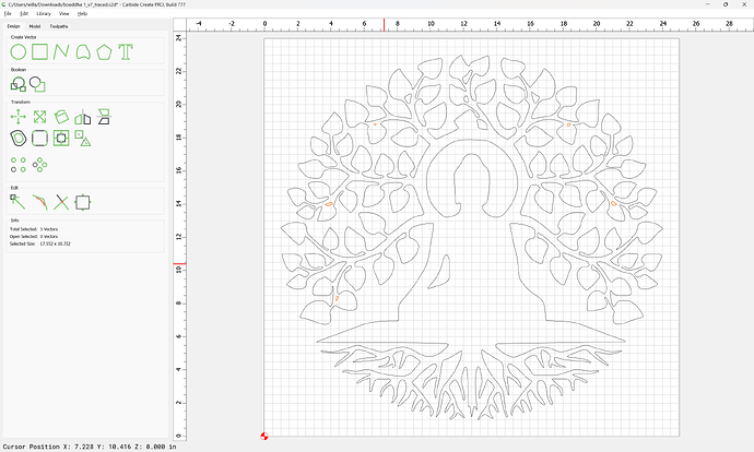

When everything is selected in this file there are 26 objects:
but when one clicks and selects objects individually there are only 13 objects:
If one deletes the duplicates, the problem remains.
Reviewing the file now.
Hello Ron,
thanks for checking, do you also know what goes wrong?
Hopefully someone knows.
I see that William also has replays with the solution,
Tomorrow I’m gonna try his advise
Thanks both :+1:

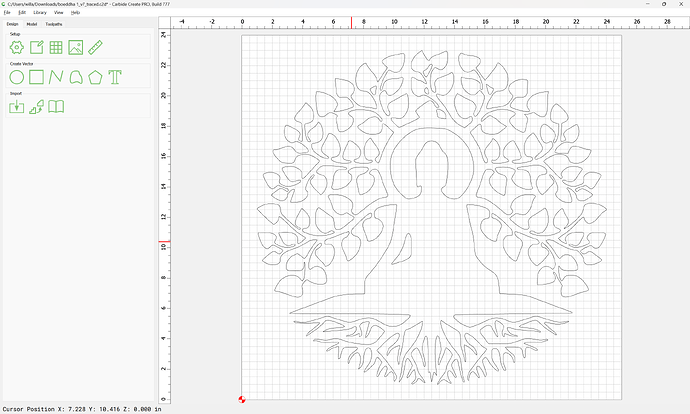

It still crashes when the duplicate geometry is removed, and even if the file is re-created by creating a pixel image and tracing to make new geometry.

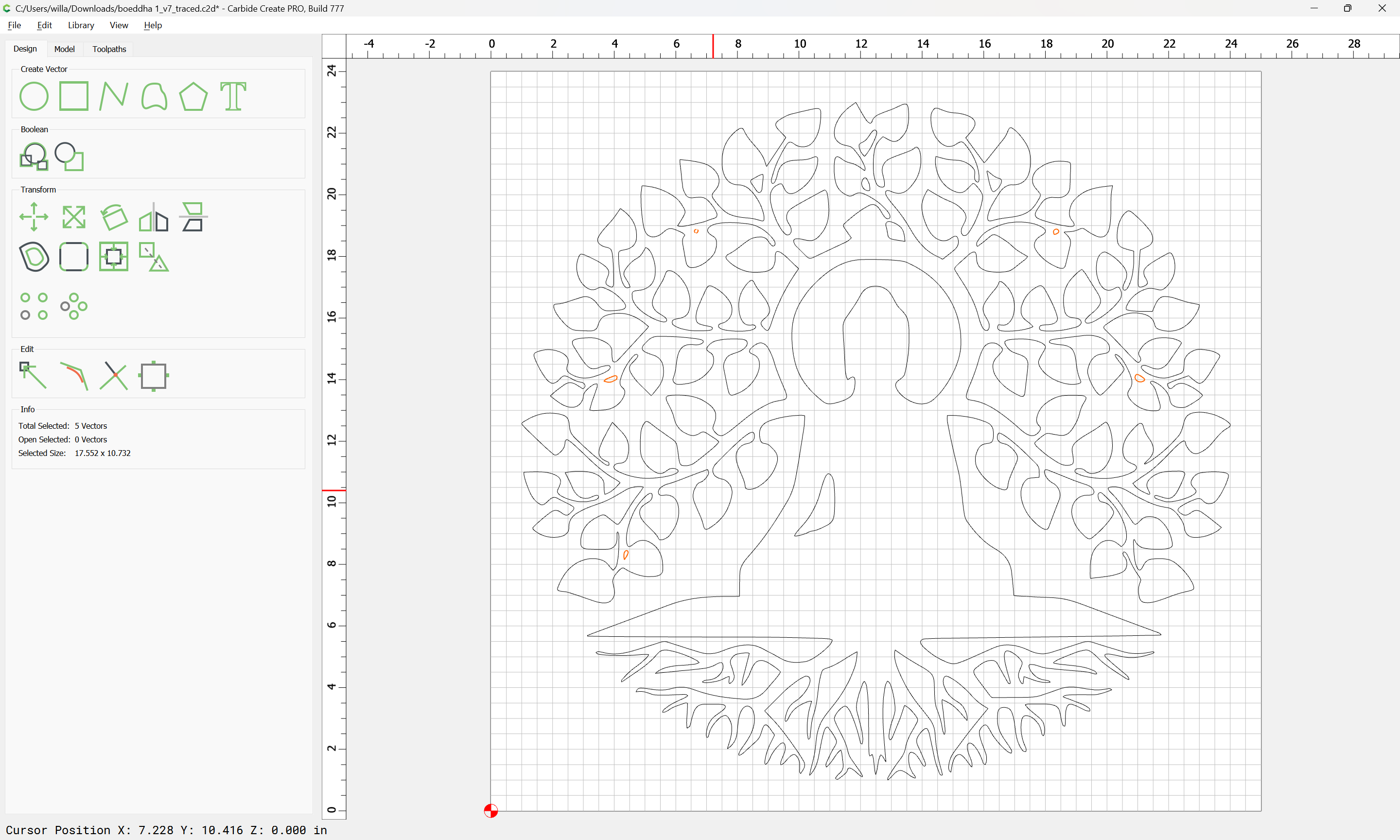

Try deleting some of the smaller geometry:
but it still crashes.

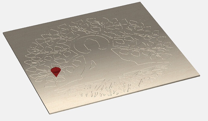

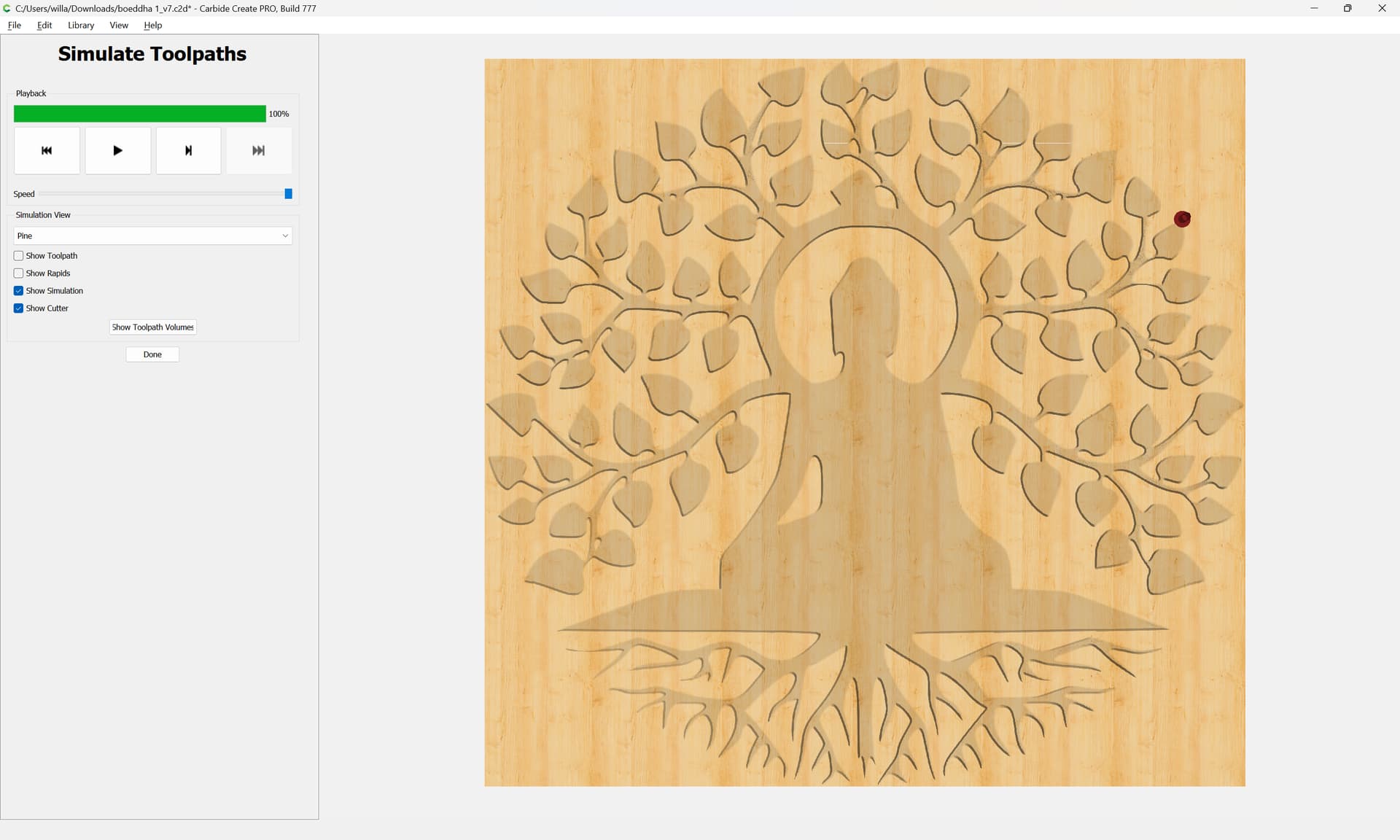

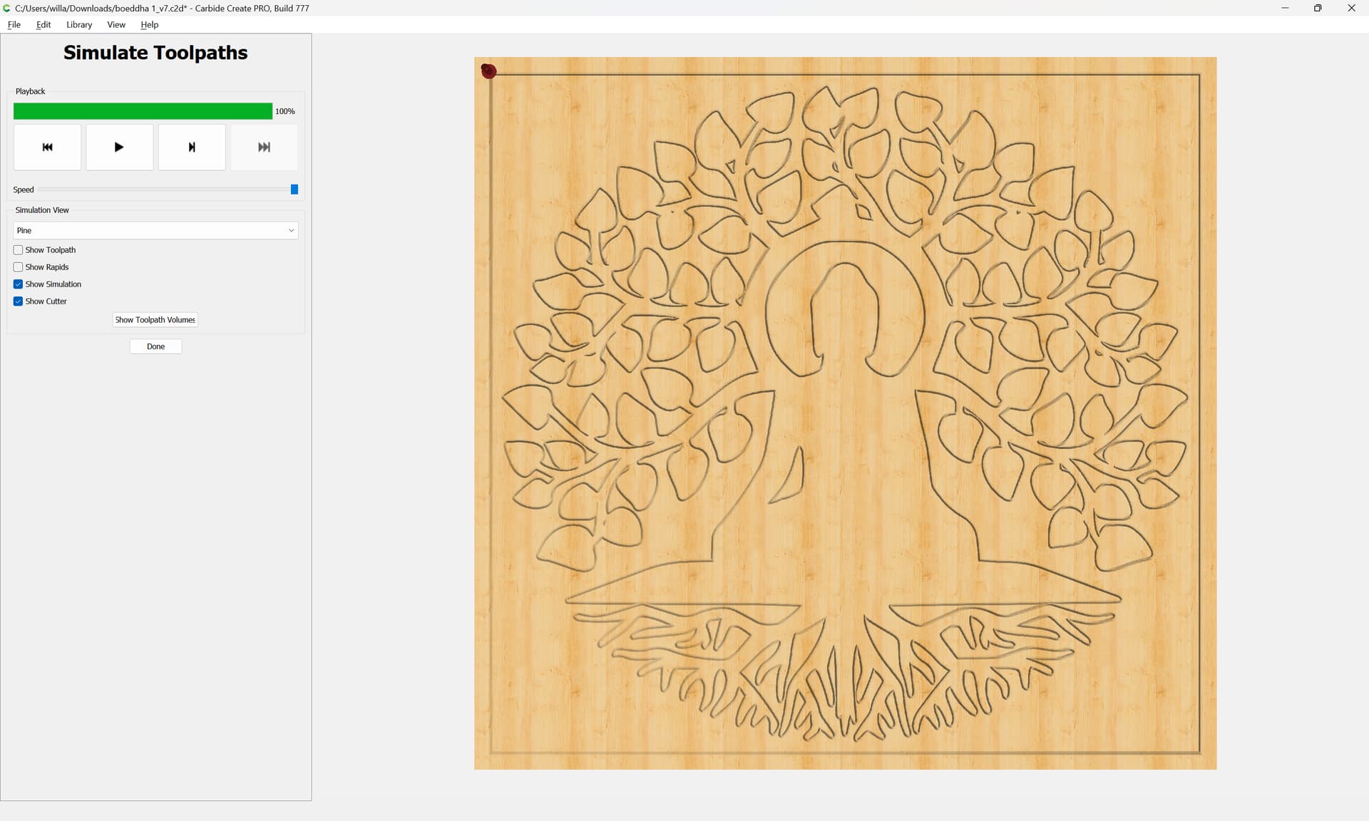

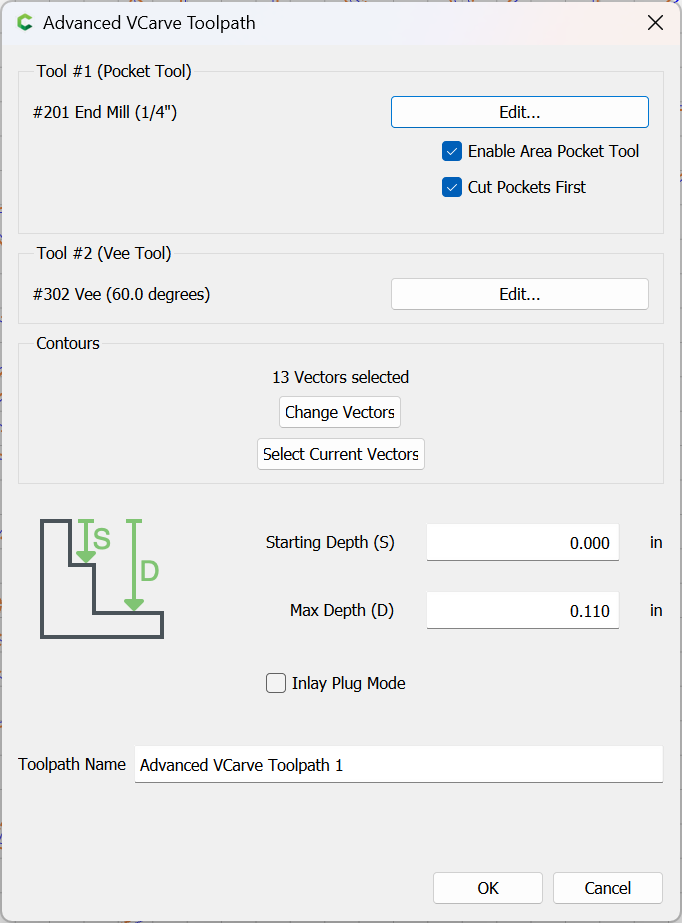

However, other toolpaths do not crash — would it be an option to use an Advanced V carving toolpath?
An Advanced V carving around the perimeter w/o Pocket clearing does give a contour effect:
Attached as a v7 file.
boeddha 1_v7.c2d (404 KB)

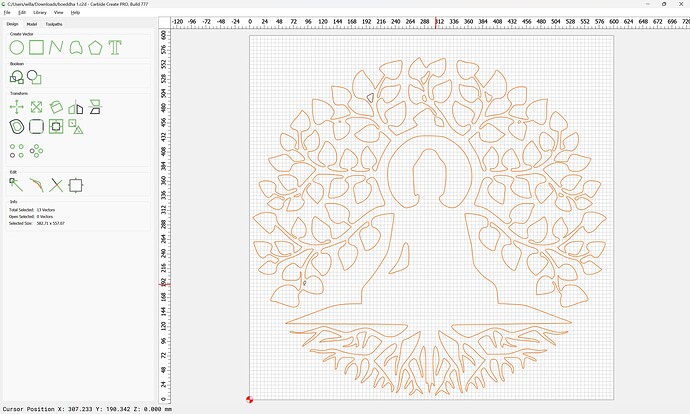

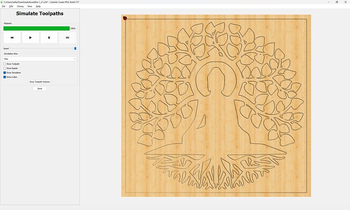

I selected each curve separately, dragged them to the side & deleted them.
With only 1 copy of the 13 curves, I can contour cut everything with no crash.
hello, I downloaded and installed the beta version 778, and this is what it looks like now, it works fine, carbite create does not crash now
