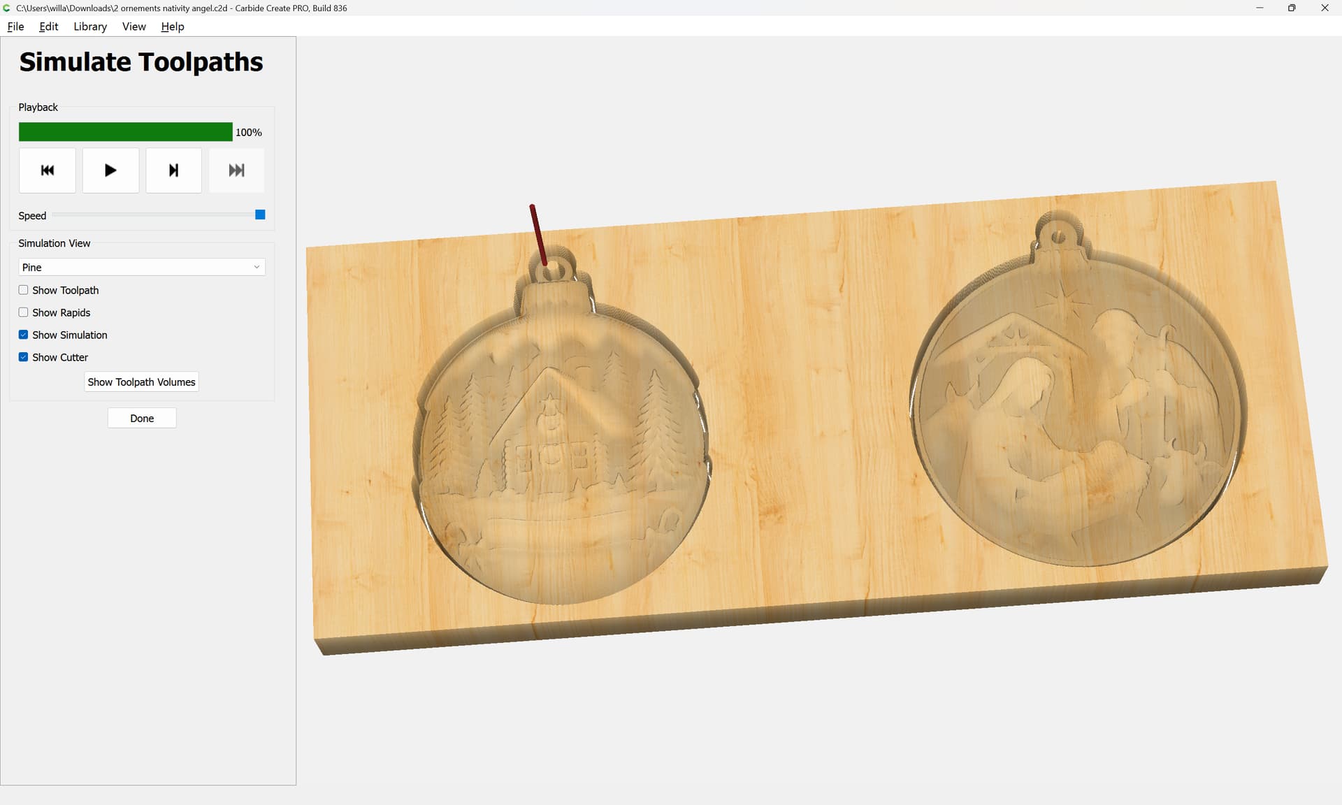

2 ornements nativity angel.c2d
Opens fine here:
My recommendation has always been to work from/with local storage and only copy to a network drive when done.
