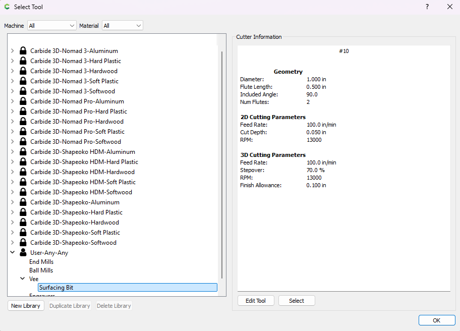

I am attempting to run a waste board surfacing file in v6(the file creator created it inversion six and recommended I downloaded and used version six for this) I added my servicing bit profile to my library and when I select it and go to hit OK and then view the estimate estimated time to complete the job it crashes immediately. When I try to run it in version eight the tool pads do not come up.

Post a screengrab of the tool definition and toolpath parameters which cause the crash?

Okay, so I saved it and opened it in v8 so it seems to be okay. However my surfacing file says it will take 1164 minutes, which is crazy. Attached are the bit parameters I have set up. What else can I do to speed this up? Is it a setting in Carbide Create that I am just not seeing?
