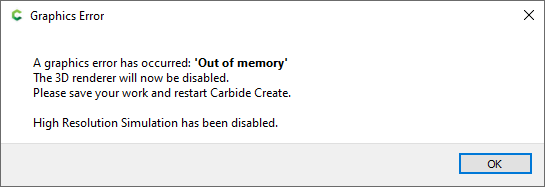

I have trouble with the 3D modeling on occasion, the more complicated the model, the higher chance I have at a crash. And sometimes I get this error…
snap237
… but it usually just GPF. I also have trouble (on rare occasions) moving from one Carbide Create design/file to another. If I am viewing file A, and ask to open file B (which closes file A). Carbide Create will sometimes crash when loading file B.
Only time I have “lost” design time is when I was working on an overly complicated 3D heightmap. I would have to open the file and just let it sit for awhile before I dared to touch the mouse.
That popup is due to the GPU not being able to allocate enough memory to show the 3D mesh that’s been calculated, both simulation and CC Pro heightmaps. In the last release we managed to track down where it happened and issue that popup. Catching the error and then reducing resolution eliminated all of the crashes due to the GPU that we were able to replicate. Before this change, the GPU running out of memory caused a hard crash.
