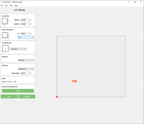

I am wanting to try my hand at CNC and I am learning towards the shapeoko but wanted to try out the software first. Carbide create, I installed on a windows 10 (pro version). The software appears to load and run fine BUT none of the dropdown menus work. There is a value on the drop down but when I select it to try and see the other selections nothing. Can’t go with the machine if the software does not work.

Could you send us a screen grab?

Ok when I created a new user account now it works. I sure would like to have it on my normal account
Apparently you’ve got something set in the one account to cause this — perhaps some accessibility option?
