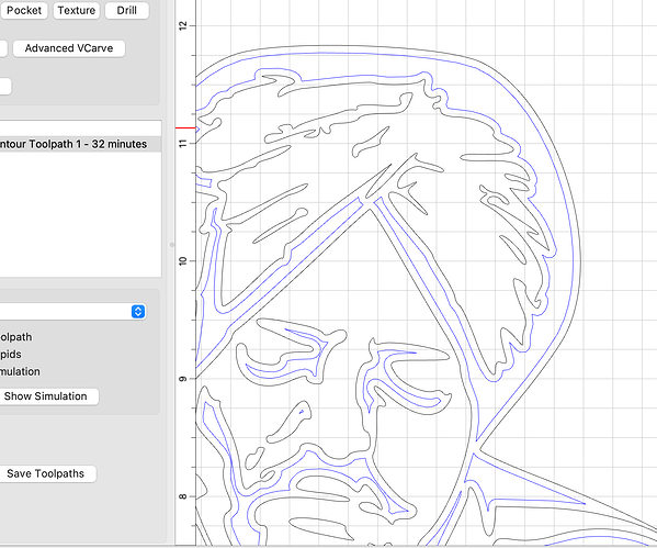

Carbide create not recognizing all lines in file
Hello, my project is not cutting out all the lines that are shown in carbide create, they are the ones that don’t have the blue line around them. Any idea on how to include them?
There are two ways you can select objects to cut. In your screen shot, if you wanted all to be selected, hold the left click button and draw a box around everything. Release and it is now selected.
Hold the Shift key and click on each object you would like to include in the tool path you are creating.
Does this answer your question?

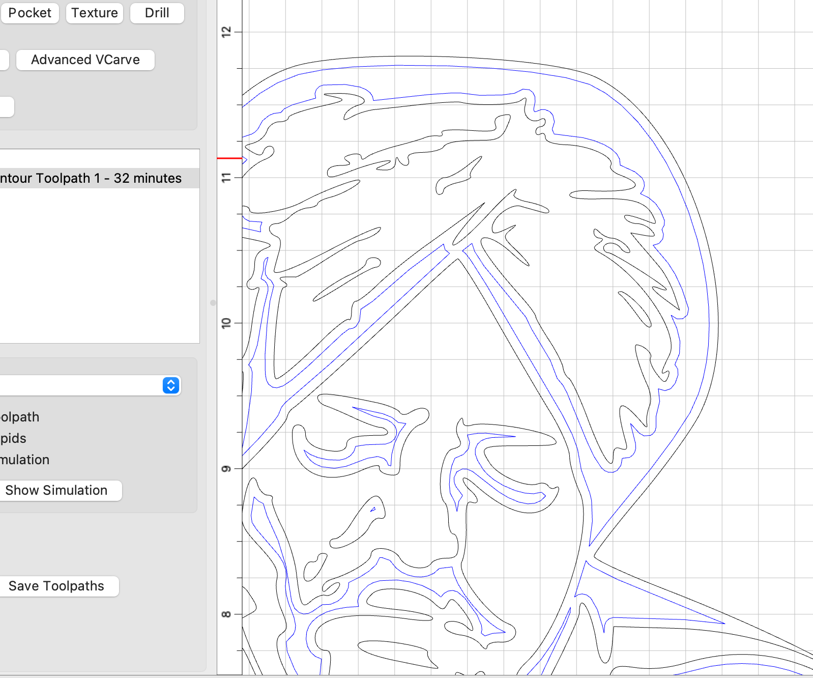

We need to see the design file for sure, but with an inside or outside contour, CC will not run the tool in areas narrower than the tool. Post the C2D file here so we can look at it.
For stuff with variable width like this you may be better using a VCarve or Advanced VCarve instead.
OR switch to a “No-offset” contour, so the tool follows the line instead of carving along the inside edge of it. A No Offset contour I think will follow the line no matter the width of the tool or the space between the lines.
