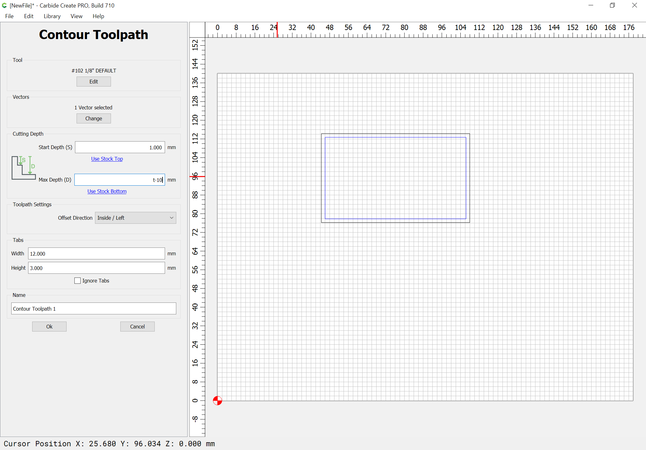

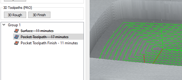

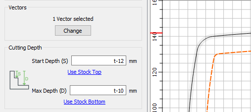

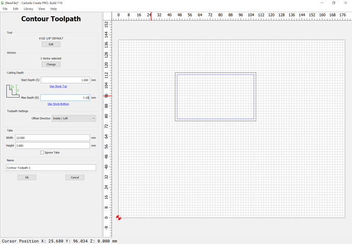

I don’t think 710 likes how I want to use the thickness value. Not sure if this has been covered yet
I was hoping to cut a nice tiny stepover finishing pass at the bottom of a pocket
but it keeps telling me my toolpath is empty

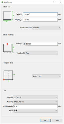

What’s the thickness of your board?
28mm
I was about to take back my thought…it doesn’t matter.

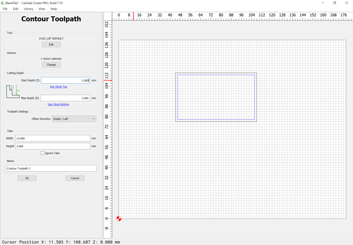

I’m not having the same issue. I can set start to t-.12 and max to t-.10 (I’m in inches) and it works fine.
I fiddled with the numbers to see the s < d error message and setting t-x where X > t to see that message, then when I set it back it did calculate
but still showed yellow. I saved and closed the file and the yellow is gone now. /shrug
I did considered that as a possibility while doing reverse head math. but there is an error dialog in place that will notify if you accidentally reverse them.

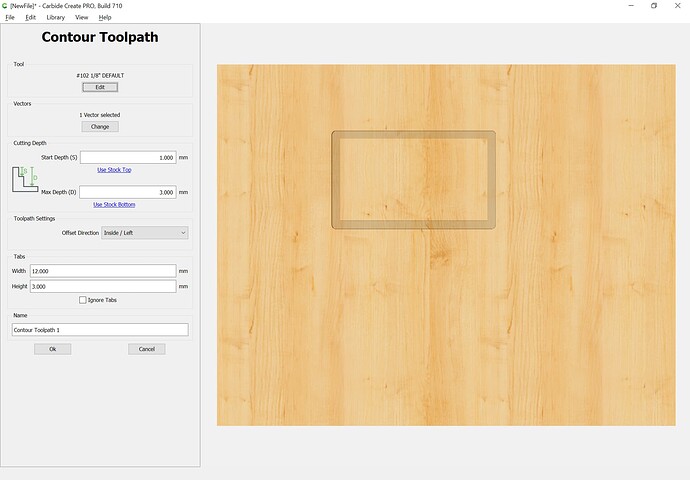

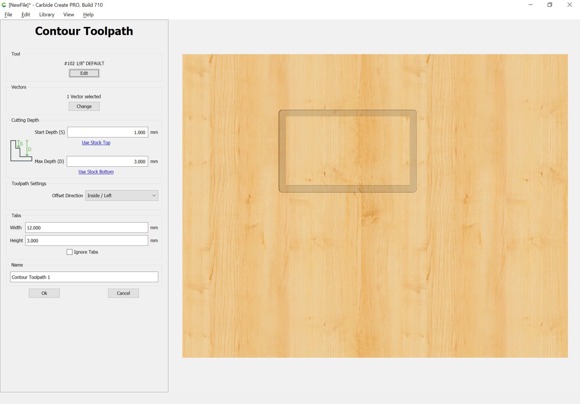

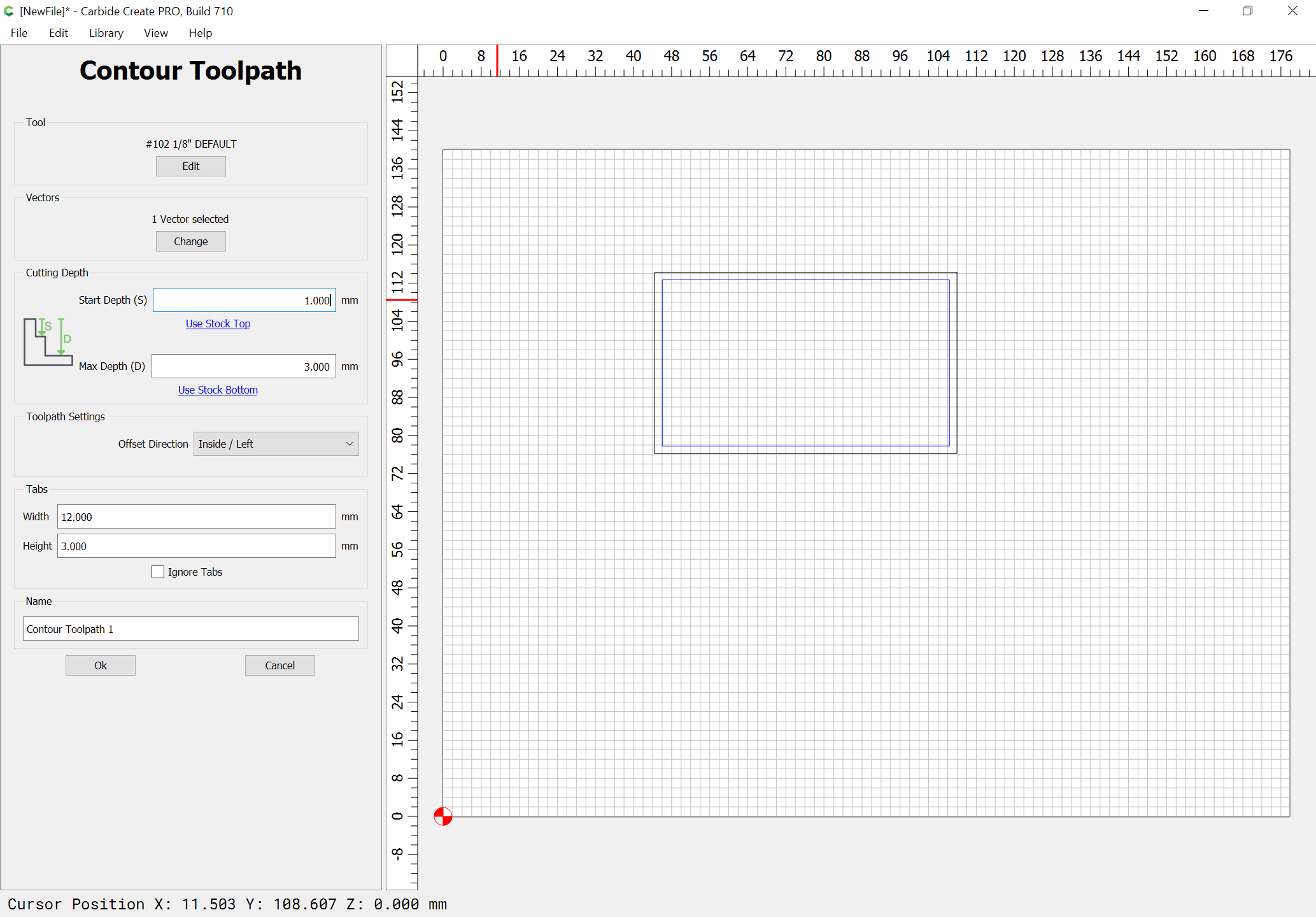

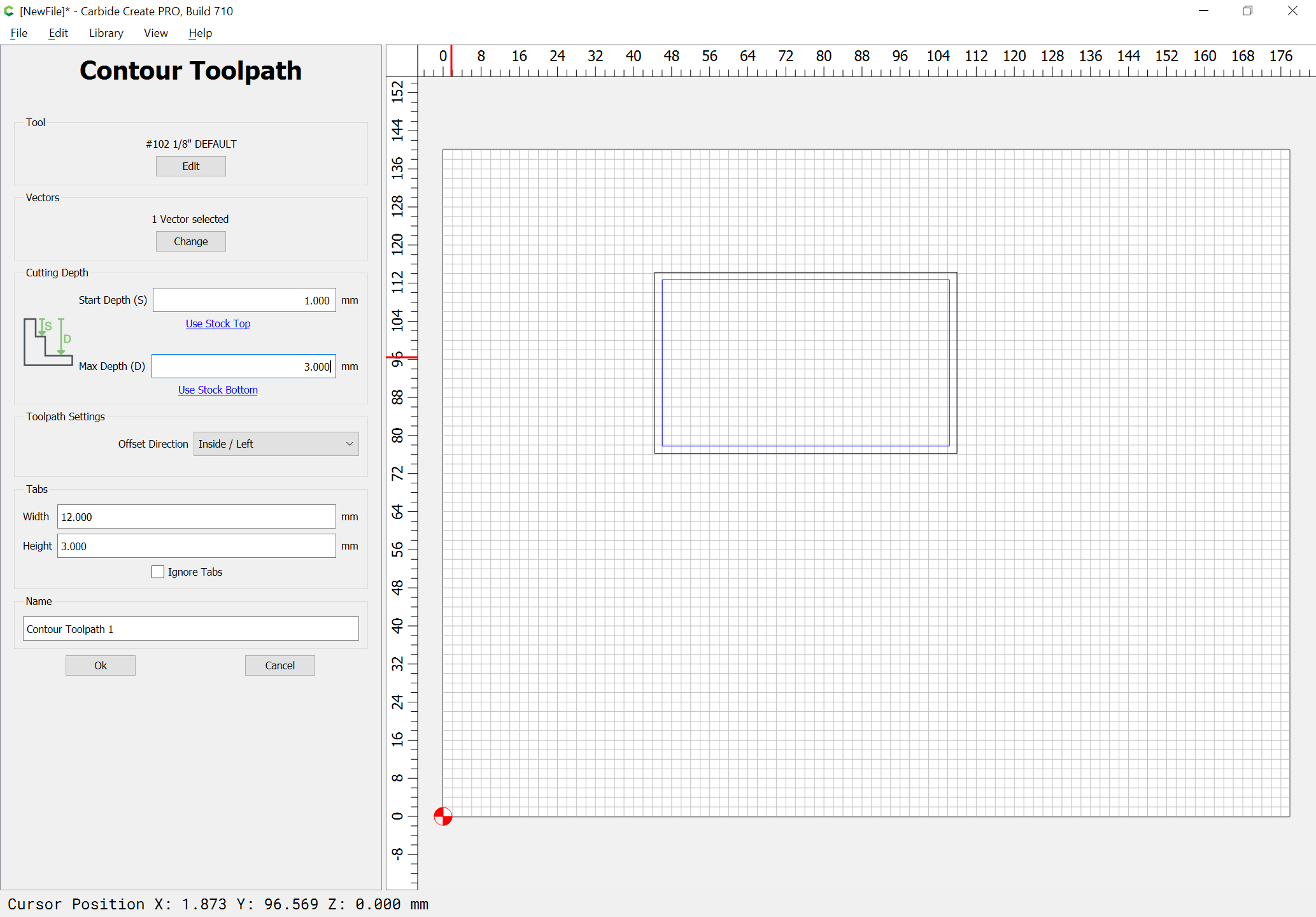

Okay, if you have a file which is in metric and has a total thickness of 13mm:
and you go to Contour and type
t - 12
into start depth and then tap = you get:
1mm
Then for max depth if you type:
t - 10
and tap =
you get 3mm and the file previews as expected:

Moving an object should trigger a recalculation, and saving the file should save the toolpath. If you save the file while it’s recalculating (and therefore the toolpath data is invalid) then you should get a popup warning you that the toolpath data could not be saved to the file. (I’m only saying “should” because it’s a beta right now and anything could be broken).
If you have a depth value that references T in a toolpath, then any change to the stock should trigger a toolpath recalculation and the logic above will apply.

If you look way back at Will’s post 187, using t in start and finish depths in contour toolpaths shows the calculated values, not t-12 and t-10 for start and max depths. This suggests that the thickness variable is used once and the calculated number replaces it. Might be a good idea to clarify which persists, the equation or it’s result, if (say) the material thickness is changed
