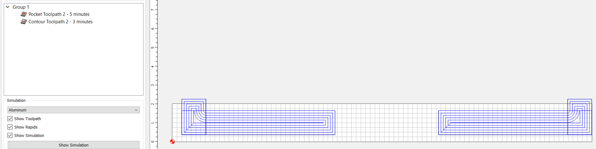

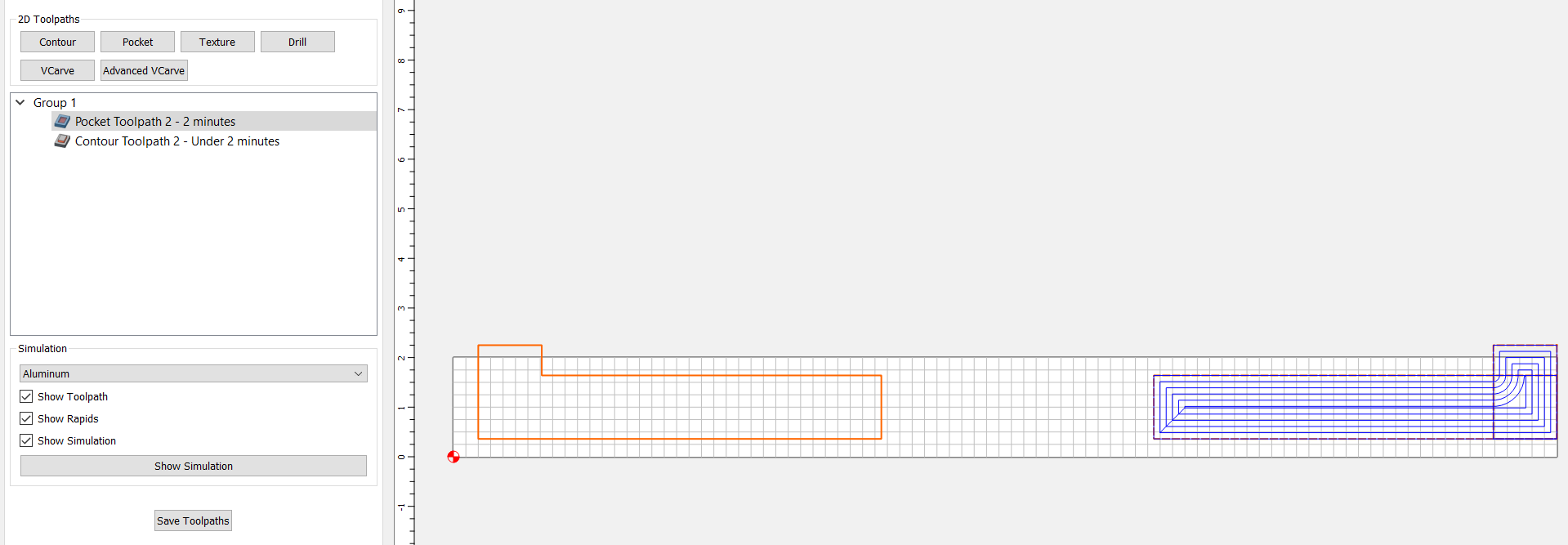

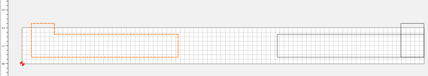

DEFECT [BETA 711]:
I am not seeing toolpaths regenerate after editing:

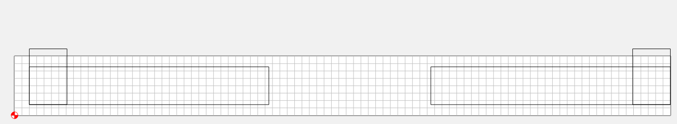

Started with this design:
And set up these toolpaths (by selected items)

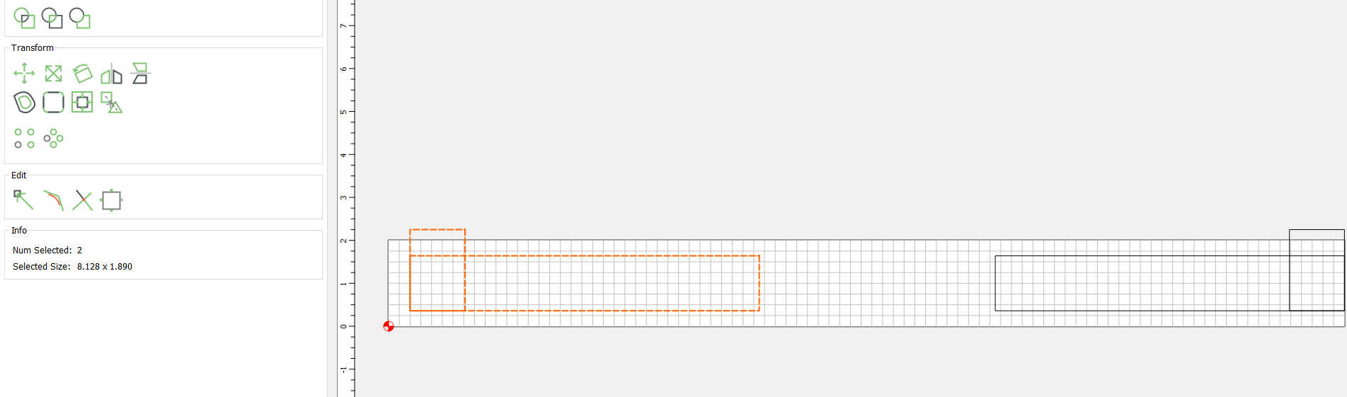

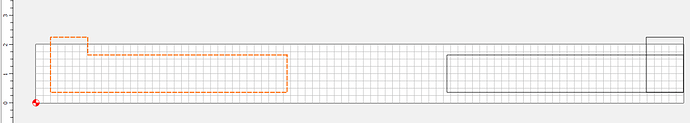

Then went into the Design and Unioned one of the pairs of shapes

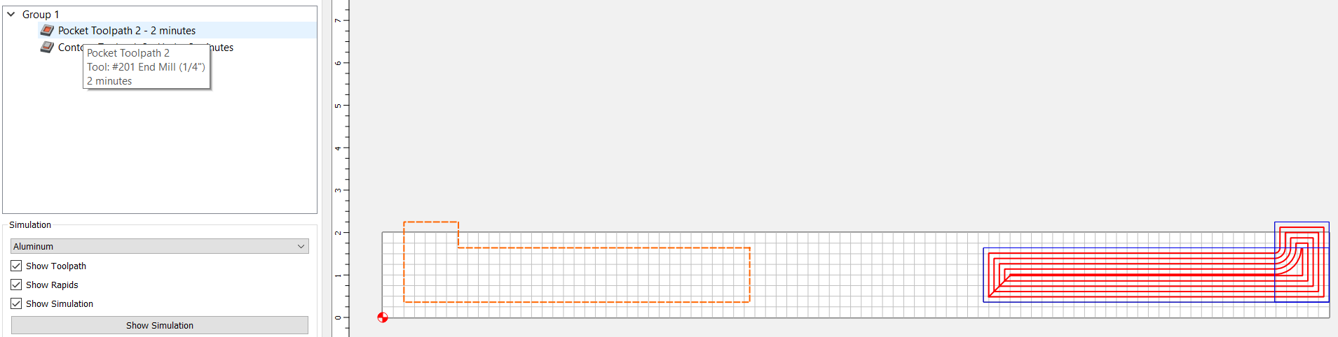

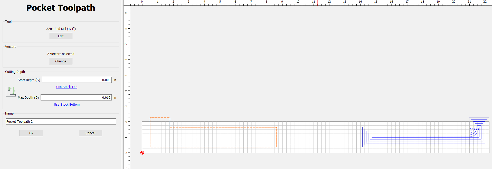

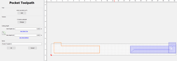

Then went to put the toolpath back for this item:

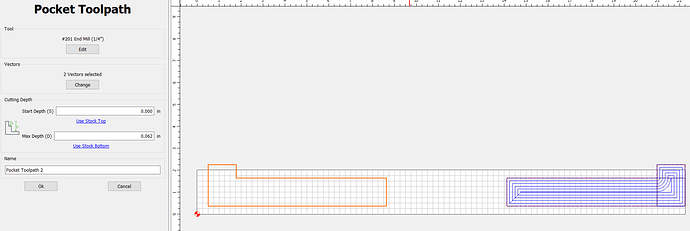

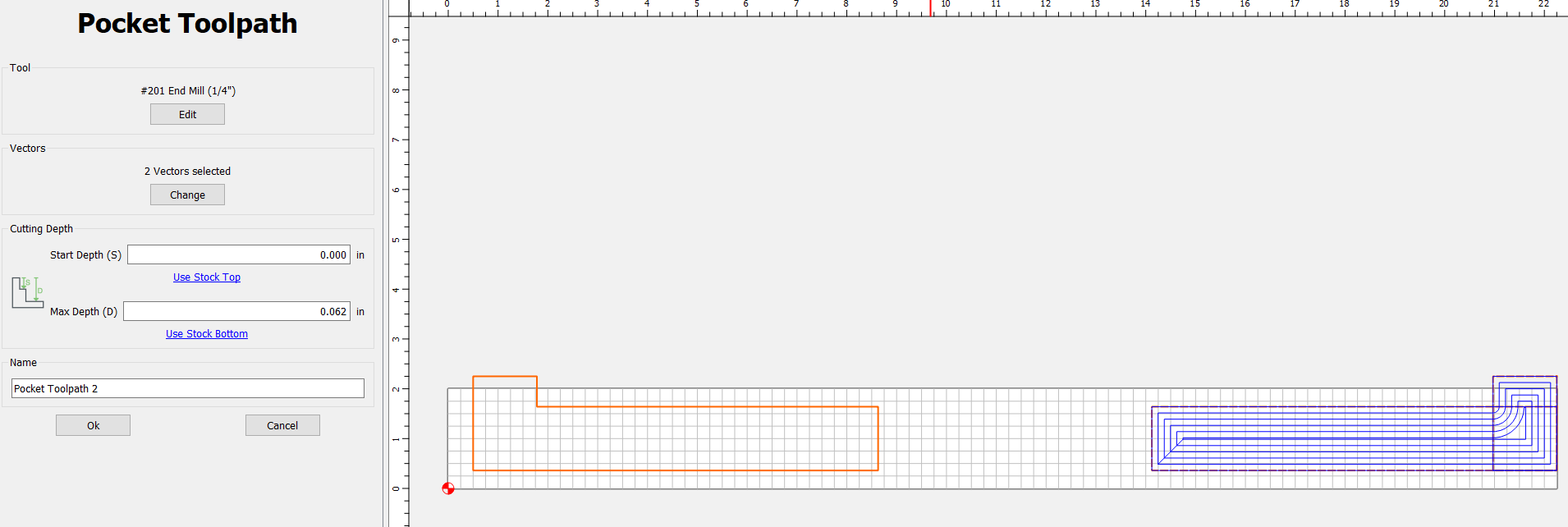

Double clicked on the existing toolpath (with the intent to add in the other object):
But as you can see, the old object is not selected with the pocket…and my new object is.

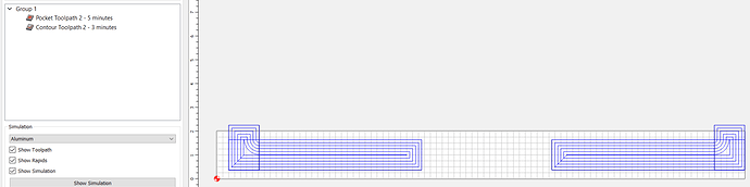

Selecting both objects at this point and pressing OK, does not add in the left object:
As you can see, the toolpath recalculated, but does not include the newly joined object.
NOTE: When you double click on a toolpath, it does NOT select the objects for that toolpath. This is definitely a change. Furthermore, when you add in new objects by selecting them with the toolpath dialog up, it does not add those objects.

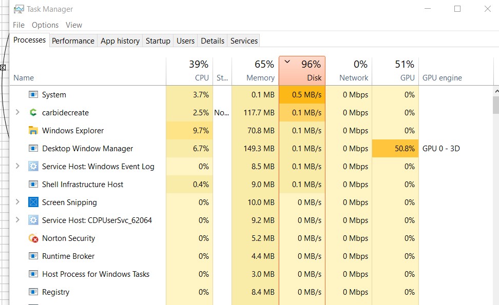

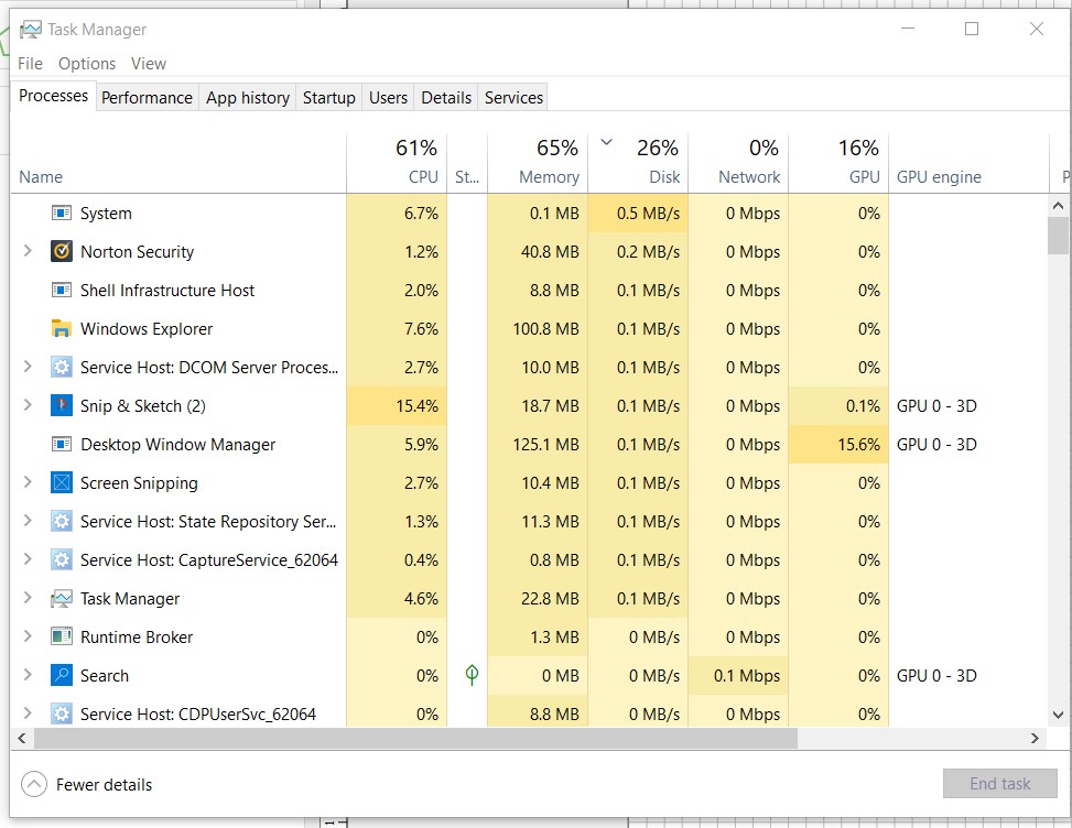

I upgraded to V710; now V711 beta. I have noticed when saving a CC file using V711 it starts to save 5-6 seconds then says “not responding” then after 10 seconds or so reconnects and is done saving? I did same process using V652 and no issue with saving file and communication? This is stand alone laptop used for Carbide 3D only. Any idea on what may be going on.
In V7, you need to click the “Change” button in the “Vectors” section to use the current selection.
[EDIT] This falls under those UI changes around vectors and layers, and how to handled them in V7 that we’ll look to solidify once we get more feedback.

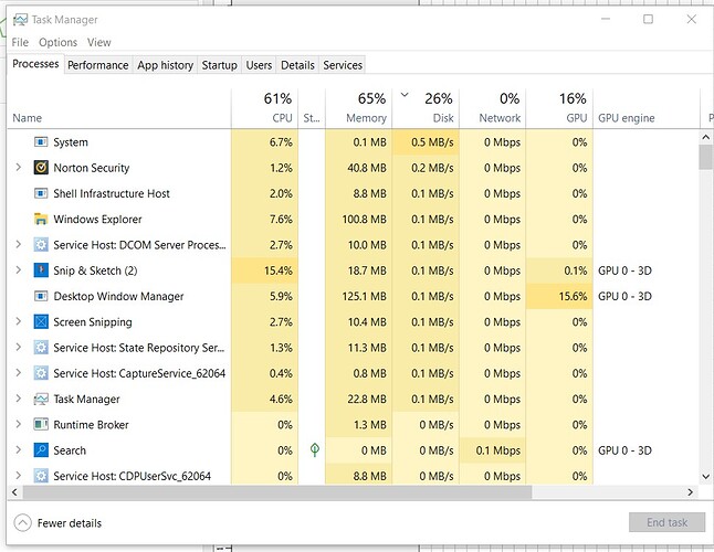

It seems to take a long time for V711 and previously 710 to save in Windows 10. I get the “Not Responding” message if I click on the application while it is grayed out. Here are two snapshots of my task manager before saving a c2d file and one while saving a c2d file.
You can see that I get a spike in disk activity. I would have thought that CPU usage would go up but this is a snapshot that as soon as I hit save I jumped over to Task Manager and then to the Snip and Sketch Windows tool to capture the task manager window.

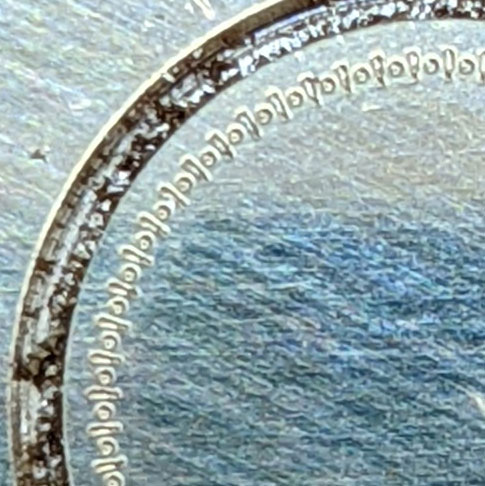

Pattern etching tool paths in the new CC are incomplete.
This is what it should be:
Screenshot 2022-07-08 at 15.18.37
This is what it’s creating:
Odd-etch
Single Test Issue New.c2d (160 KB)
There are some tolerance values built into CC that are used to reduce the toolpath density and other calculations. I suspect that since the circles are .3mm and then those are inset further by the tool radius, the toolpath points are collapsing onto each other. This is a good test case to evaluate changes but I’m not sure when/if we’d change those internal values.
EDIT- Also, always look at the toolpath simulation to see the real path. We have to further reduce the toolpath in the 2D view to keep the display from bogging down. This is purely a visual thing, it has no effect on the actual toolpath in the machine and the simulation toolpath is always correct. Your file looks much better in the toolpath simulation view.

So, looking into it, you have MC Etcher defined as .127 mm in diameter and the distance between the bottoms of the two adjacent squares is .126mm, so the cutter cannot fit and the shapes will be merged. You should probably change the offset from “Inside” to “No Offset” to get what you’re looking for.
I agree with WIll that the lack of concentricity is likely due to flexing somewhere, or play in the tip of the drag bit. You might find that repeating the toolpath twice but using a lower pressure will change the outcome.
Rob, thank you for pointing this out. I must have forgotten to set the Offset to “No Offset”.
This solves the etching issue.
