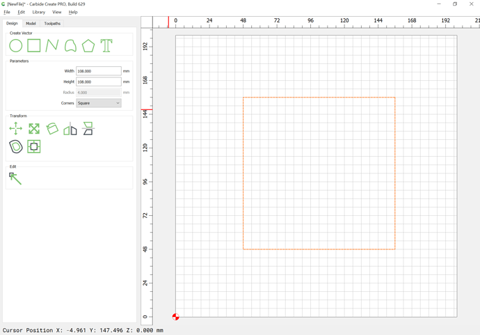

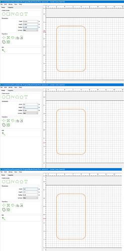

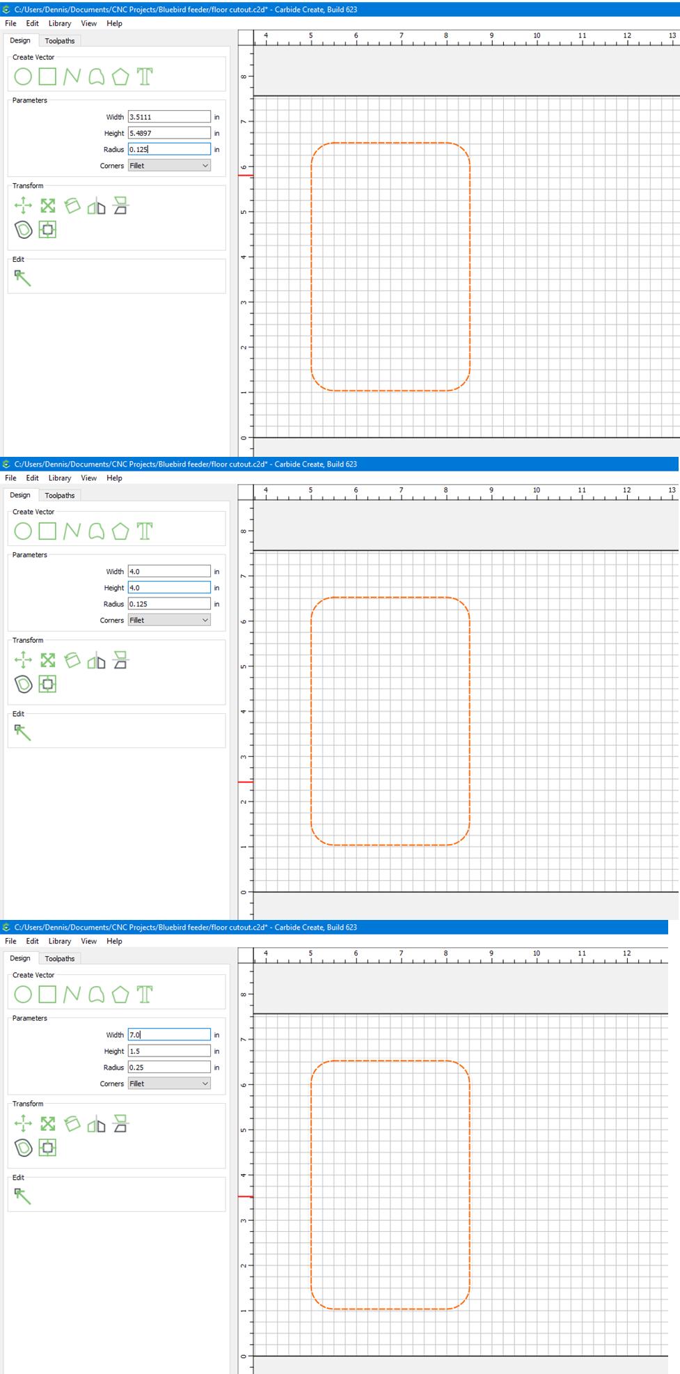

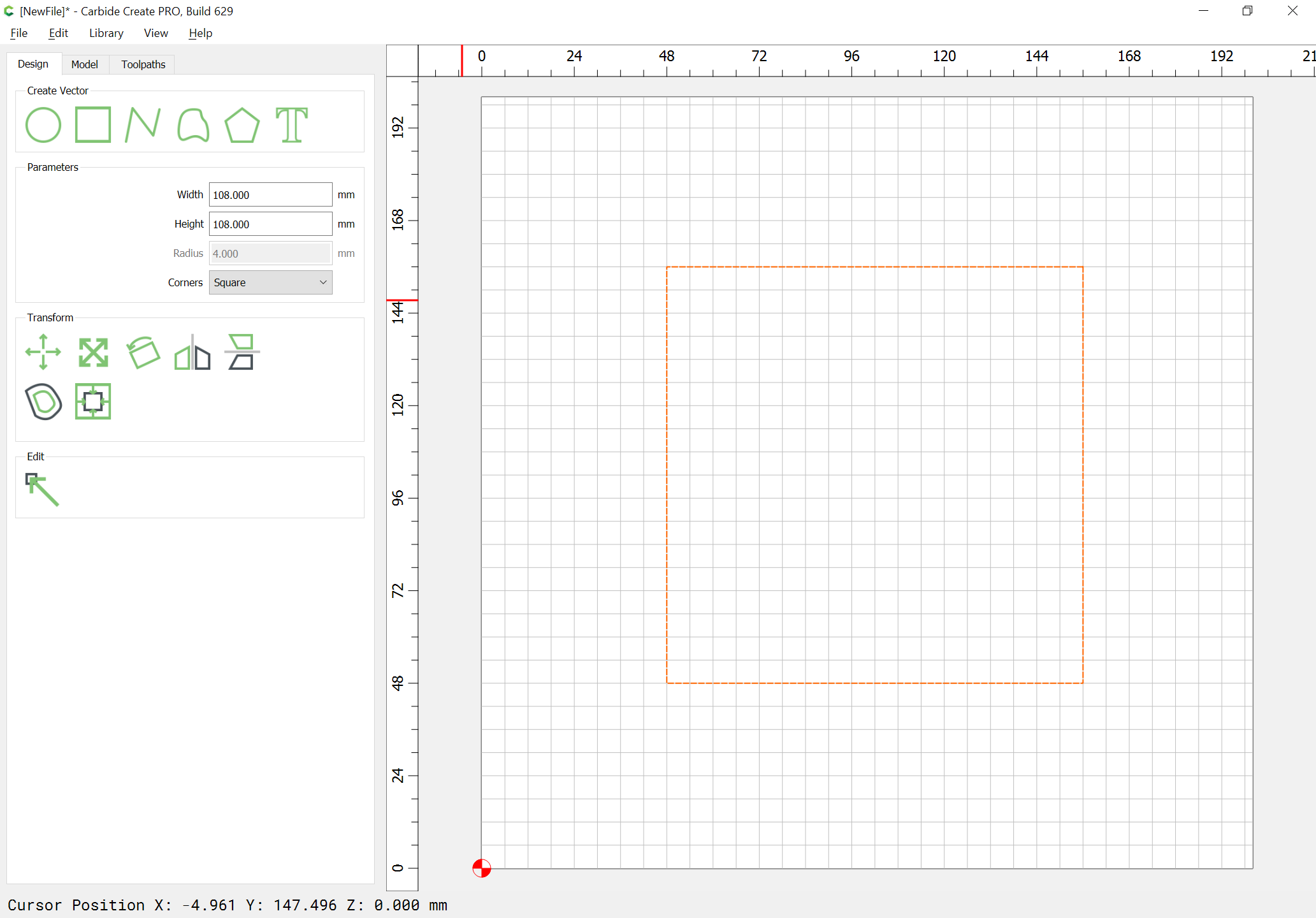

I can draw a rectangle. The rectangle box appears with the Height, Width, Radius and Corners appears. The height and width shows the size of the rectangle I just made. When I change those size numbers nothing happens to the rectangle. If I chose fillet the rectangle changes the corners to a .500 radius which is default, When I change that number to .250 radius nothing changes. I deleted the program and reinstalled it and still the same. I can change the size of the rectangle by using the scale feature but that locks the both measurements to a scale and changes both. I can drag each side of the rectangle to size but its hard to get it exact. There is no apply button so I change any parameter and the rectangle stays the same. I watched a few of the beginners videos and the rectangle changes as soon as the parameters are changed. What am I doing wrong or what is happening?

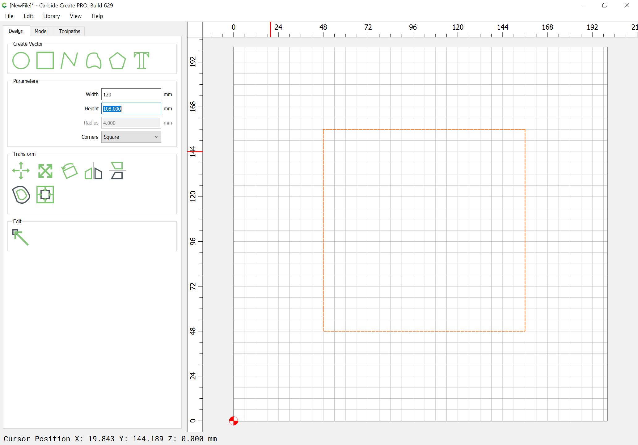

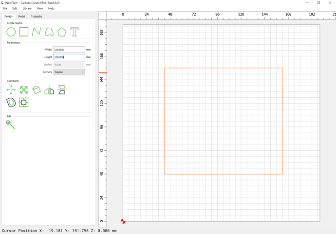

You have to tab on to a different field:

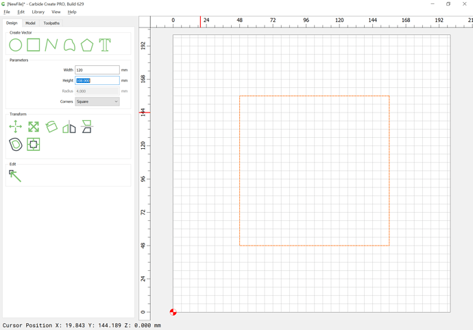

Type 120 and hit Tab:

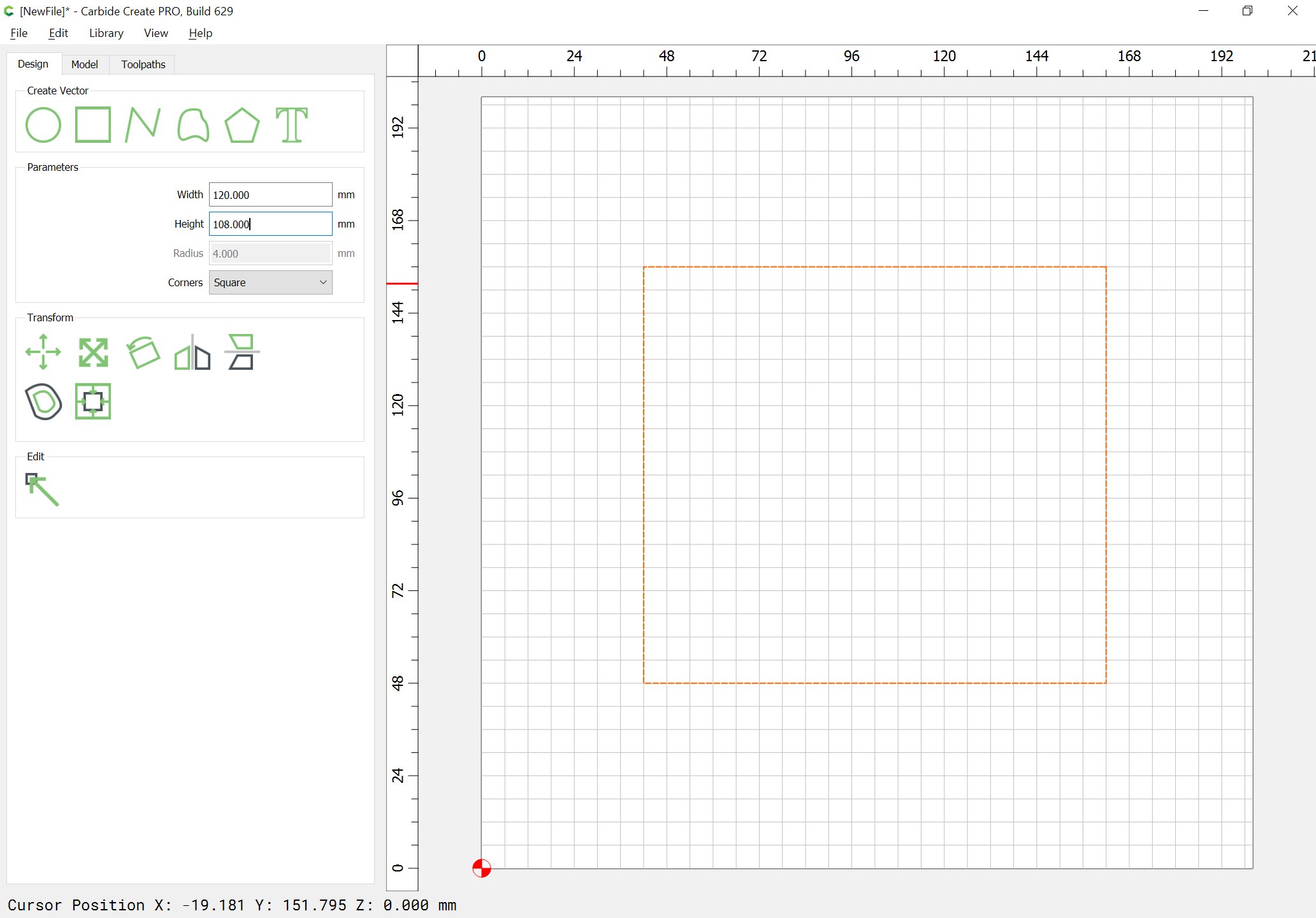

Tap Enter:

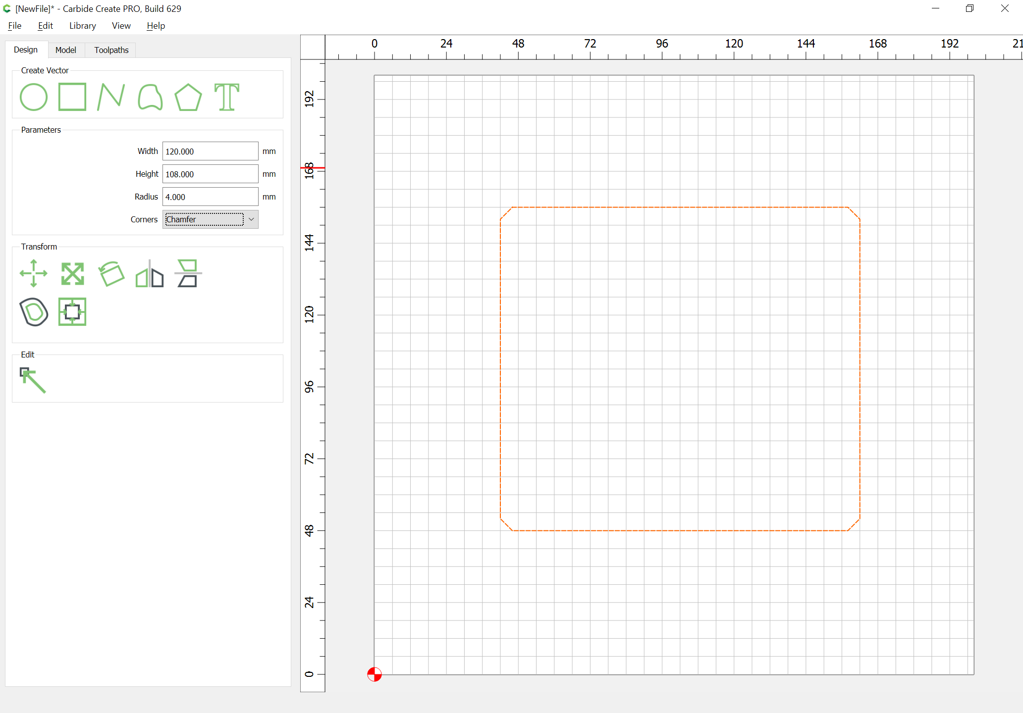

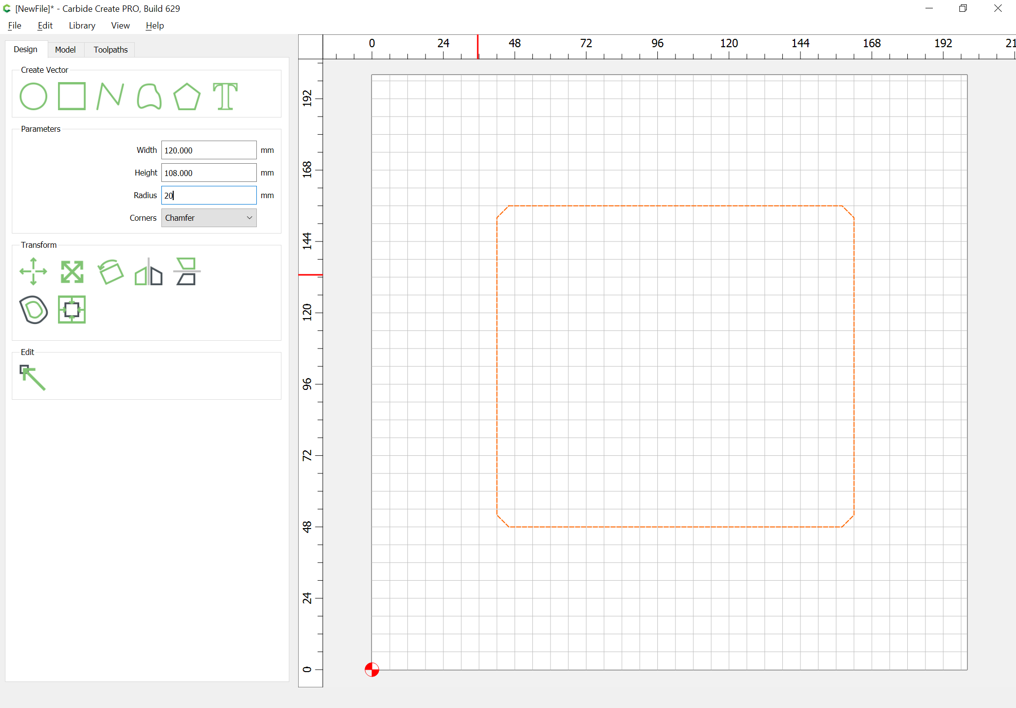

Select Chamfer:

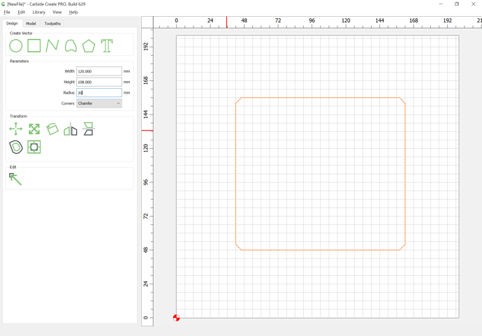

shift-tab and type 20:
shift-tab again and tap Enter:
Thanks William. Its as simple as hitting enter. I don’t know why they can’t put an APPLY button there like on other applications. Hitting the enter key never entered my mind. Tried it and it works perfectly. I had a feeling there was a simple solution. When I watched the videos I do not recall ever hearing anyone say hit enter when they changed the parameters.
Anyway, thanks for the help. Very much appreciated!
