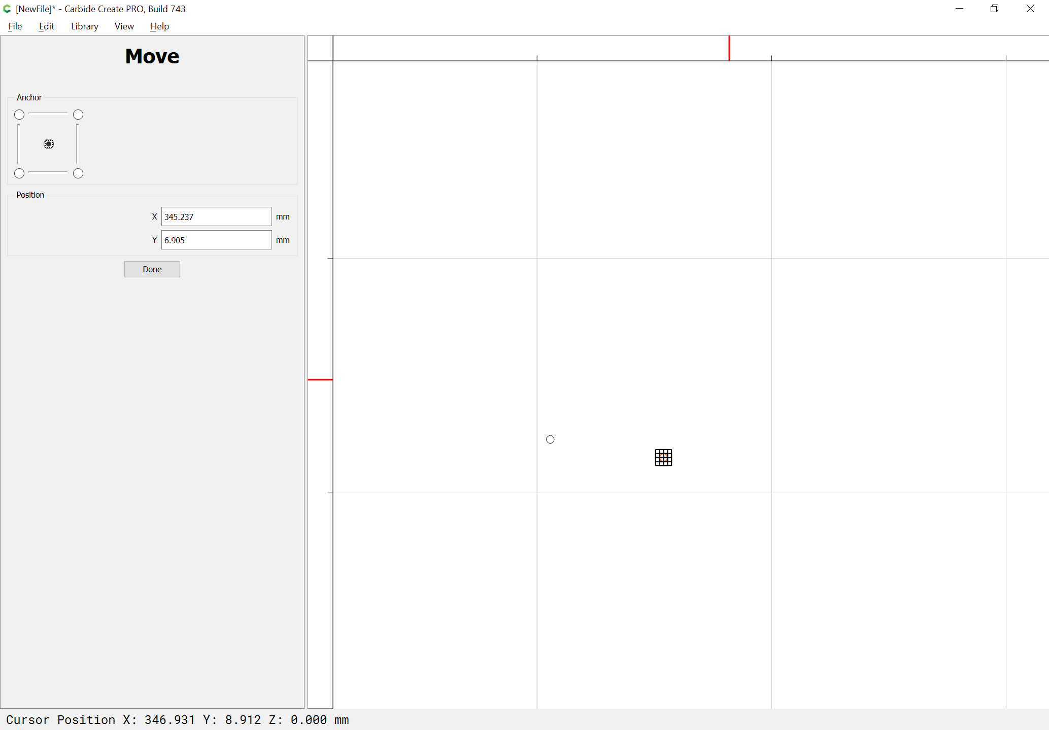

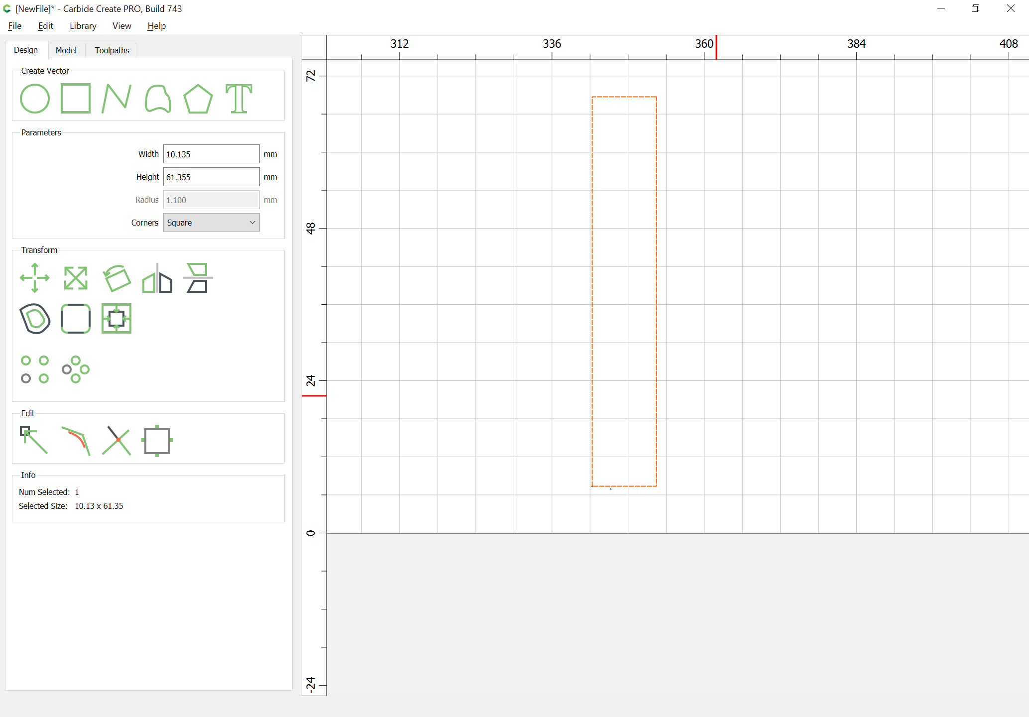

Which if we draw it up is:
So a circle drawn from the upper right corner should pass through the center of both circles:

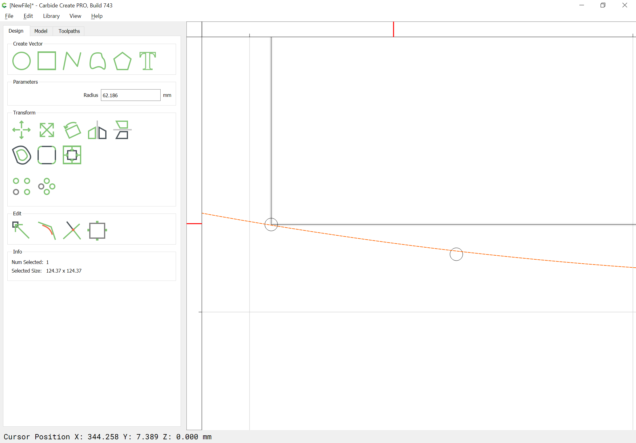

which when one zooms in:
does not, so the CAM tool in question misses by more then 0.05mm:
OK, thanks for the detailed explanation Will. I’ll contact the developer of devCad on this.
