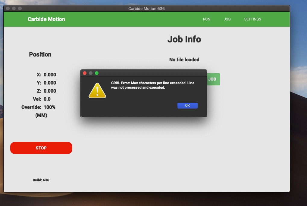

The first time I tried motion run without downloading the 3XL software and I received the following errors:
GRBL Error: Max characters per line exceeded. Line was not processed and executed.

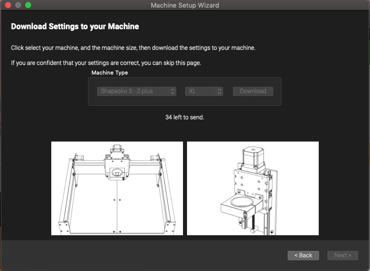

Now when I attempt to download the software It says theirs 33 steps and nothing happens.

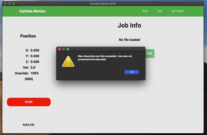

I had some more time today, I skipped the download step and was able to home the machine. However, I couldn’t get to the next screen.
I then restarted my computer and skipped the download screen and then was able to get through the whole process. I’m still getting those errors when I try to use motion. They keep popping up one after another.

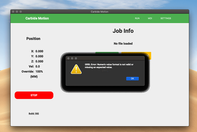

Found carbide motion build 582 and im getting a infinite amount of this error:
GRBL Error: G-code words consist of a letter and a value. Letter was not found

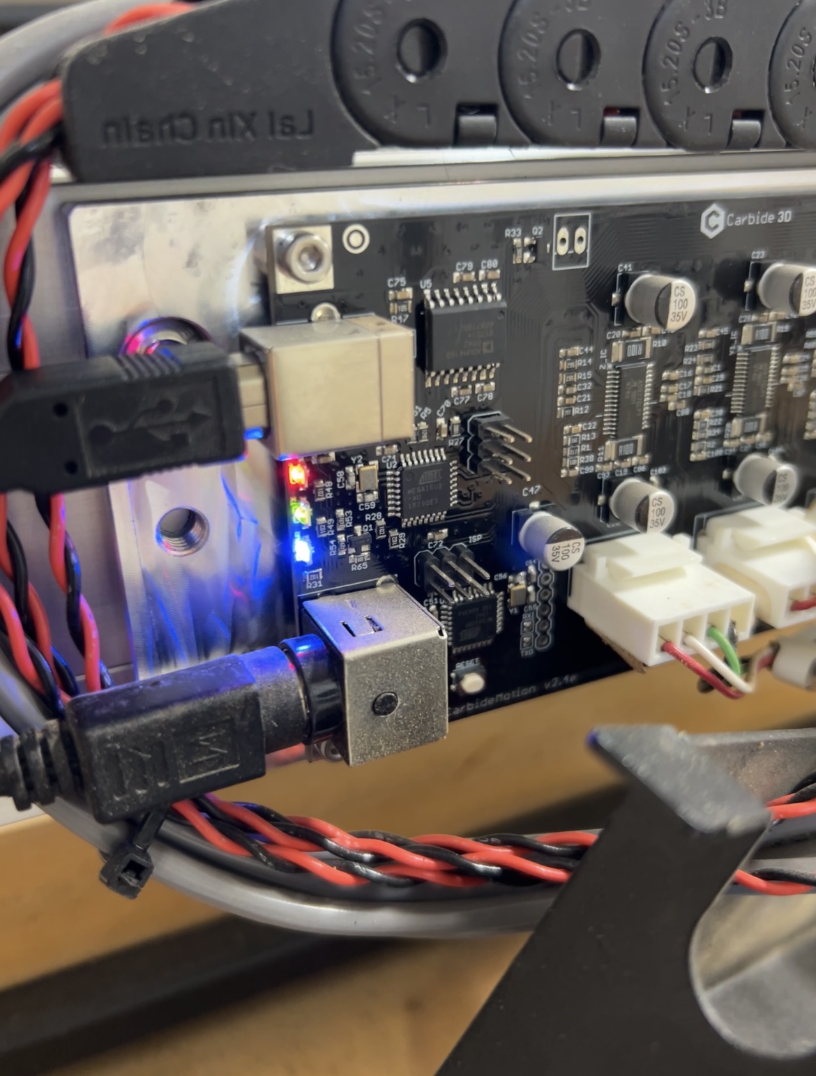

I redownloaded motion 6 and I’m going to leave the computer on the download step. I see the red and green lights on the board flickering at the same time.
Just doesn’t seem like it should take long to download the firmware. Says there 34 steps and no movement the past 5 minutes.
In the tutorial videos it takes seconds to do.
I also tried another usb cable and different ports and no change earlier.
