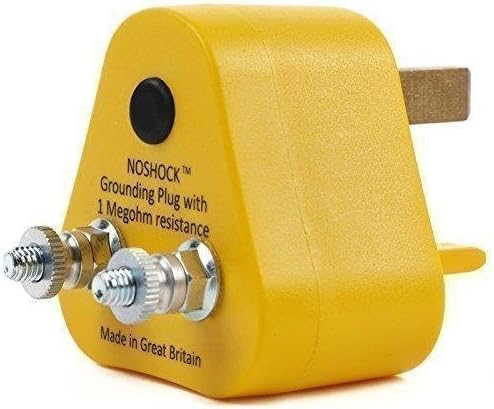

I peeled back a bit of it and put the crimp tags on. Not sure about the Z-Plus mountings - the Carbide 3D 80mm spindle mount (nice bit of kit) has a couple of bolt holes in the side for air assist or a laser mount. Any nearby spot that ends up conducting to ground at the controller box would be applicable. I run the ground at the controller box into one of these:
but that’s a UK-specific item.
