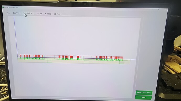

I am relatively new. I have no problems loading or running Motion but when I look at the FRONT VIEW it shows me lines in RED above a black line and then lines in green.
The Nomad cuts OK and the other views look correct and are what the result is.
I was wondering what the red lines represent.
SOMETIMES, it seems to be ‘cutting’ above the workpiece. In Carbide Create I am setting each toolpath to begin at 0.00 and am zeroing out all three (X,Y,Z) each time I run it.
What could I be doing wrong, if anything.
Red lines are rapid movements from one toolpath (or section of a toolpath) to another.
Thank you. then NO worry or concern.
