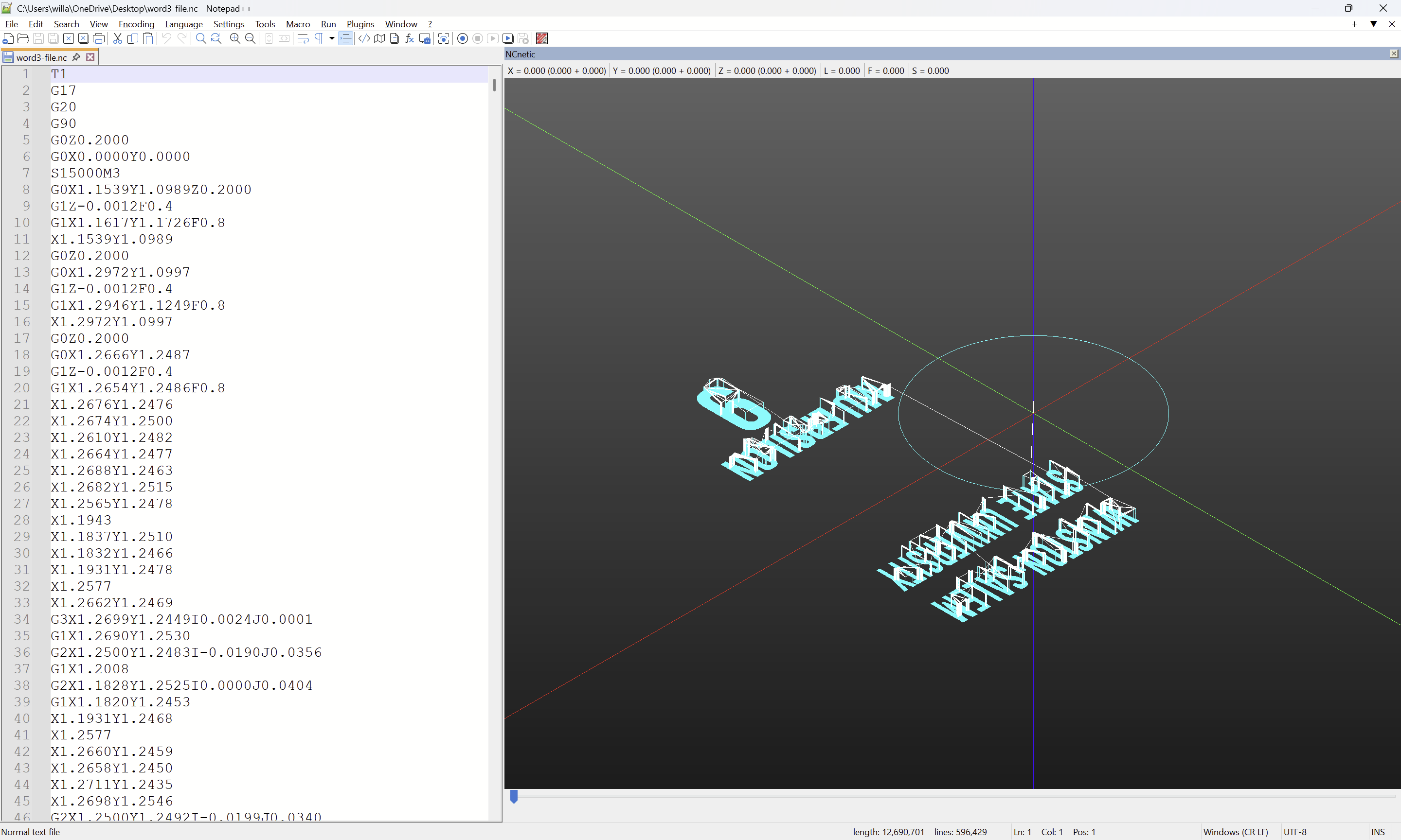

Hello,
Does anyone know or has experienced Carbide motion swapping Z and Y when importing software from Carveco Maker. It seems to only do this when trying to cut words pocketed cutouts appear to be fine.
Width (X): 4.06in
Depth (Y): 6.15in
Height (Z): 0.30in
Cutting depth below program zero -0.10in
Approximate Cutting Time: 1920 hours, 45 min
actually when i look at this z appears to be correct but I’m not sure why its stating the time and it being deeper than the cutting depth which its not

Attached you will find a sinnept of the file as the org file was to large to upload.
Basically, what is occuring is that the Carbide software believes that the cut is below the actual material. However, I literally used the same settings to cut a pocket out of a tray. So this is just like .06xx deeper which is more than enough as the material is .6 in deep.
I’ve adjusted this to a min cut depth like .0125 and I still get an error which leads me to believe that this is a software issue. This appears to only happen when trying to cut text. Cutting pockets and or cutting out the project overall appears to have no issues at all.
word3-file (3).zip (3.1 MB)

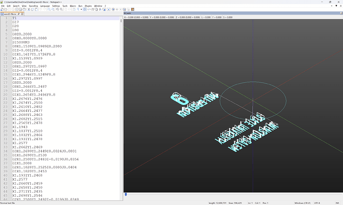

The file “looks” good in ncviewer
As noted, the G-code file seems fine:
