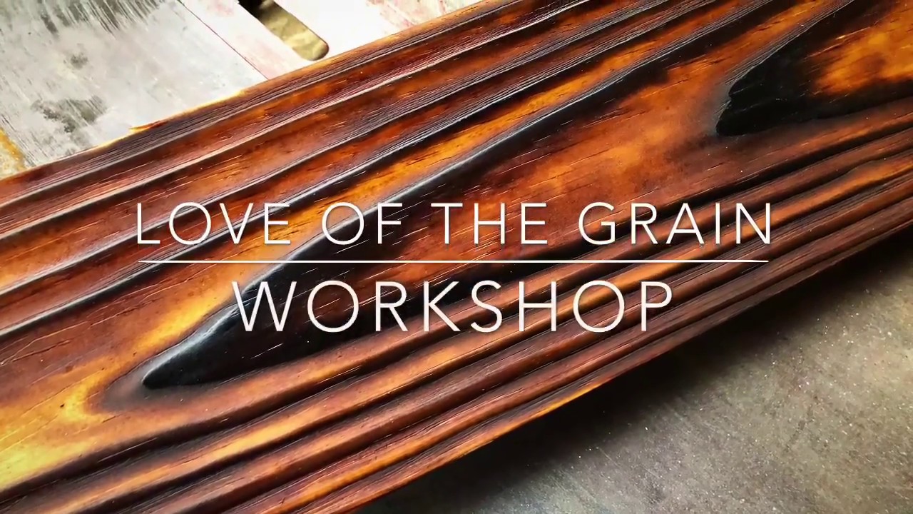

I guess I am looking more like an actual burned wood kind of like what Brew described. Like to torch it after carving. Is there any tips on doing that? I read today about some aluminum oxide added. Is this necessary or can I just carve using a ball nose and then touch it with a torch? Will that make do the trick? Maybe I am making to much out of this and it is really that easy.
I haven’t tried the aluminum oxide. I’ll have to look into that. I’ve always just made the cuts and used a small torch. The key is to not hold it too close for too long. It’s much better to go over it back and forth, kind of like not trying to burn the marshmallow of a s’more.
It’s pretty easy to torch pine. There are a million ways to do it. Here’s a good tutorial.
