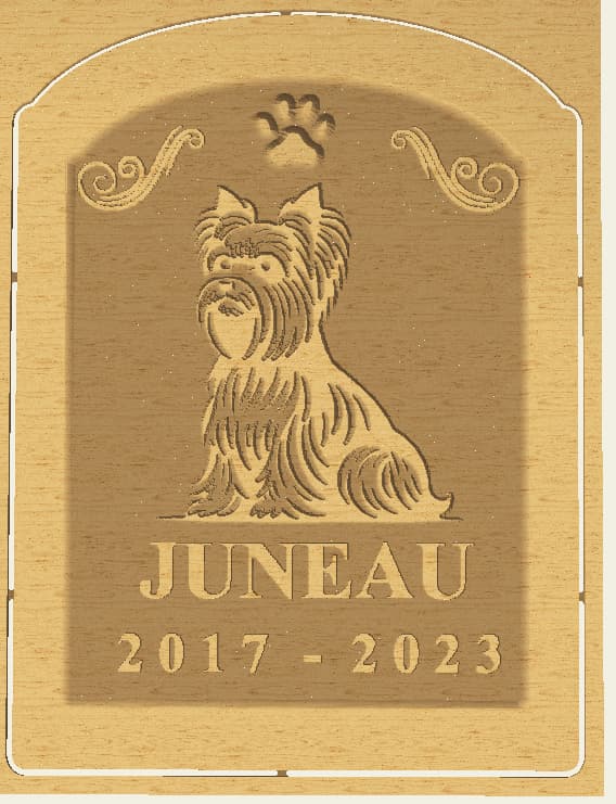

Created a new 3D carve file with a 3D rough and a 3D finish toolpath. When calculating the 3D finish toolpath, it consistently hangs at 50% and then just stops calculating and then hangs at 0%.
I can no longer use the software and have to close it and reopen it to recover.
3d Rough toolpath is a 278 1/4 inch and the 3D finish is a 101 1/8 inch ball mill. I will be cutting the image out of PVC plastic because it will be an outdoor project. However, I have observed this behavior with other materials and bits.
Is this a known bug in the software or do I need to increase my feeds and speeds for the 3d finish.
Juneau_HeadStone.c2d (472 KB)
On 764, it appears to hang on the finishing toolpath, but eventually does complete.
This is one of the cases we were trying to improve in a recent release- a very dense finishing toolpath that’s mostly one big pocket leads to appearant stalls, even though it’s still chugging along. It’s better in newer releases but it’s still a tough one to break down without deeper changes to the code. We’ll keep working on it.
You happen to have a very fine stepover, .007" for a .125" cutter. Why did you pick such a small value for the stepover?

I chose that based on the 10 - 15% recommended by Kevin Barnett in some of the tutorial videos for the 3D finishing tool path. Is that no longer recommended?

Unless you need something finer, that would mean that a stepover of .012 to .018" would be a good starting point.
