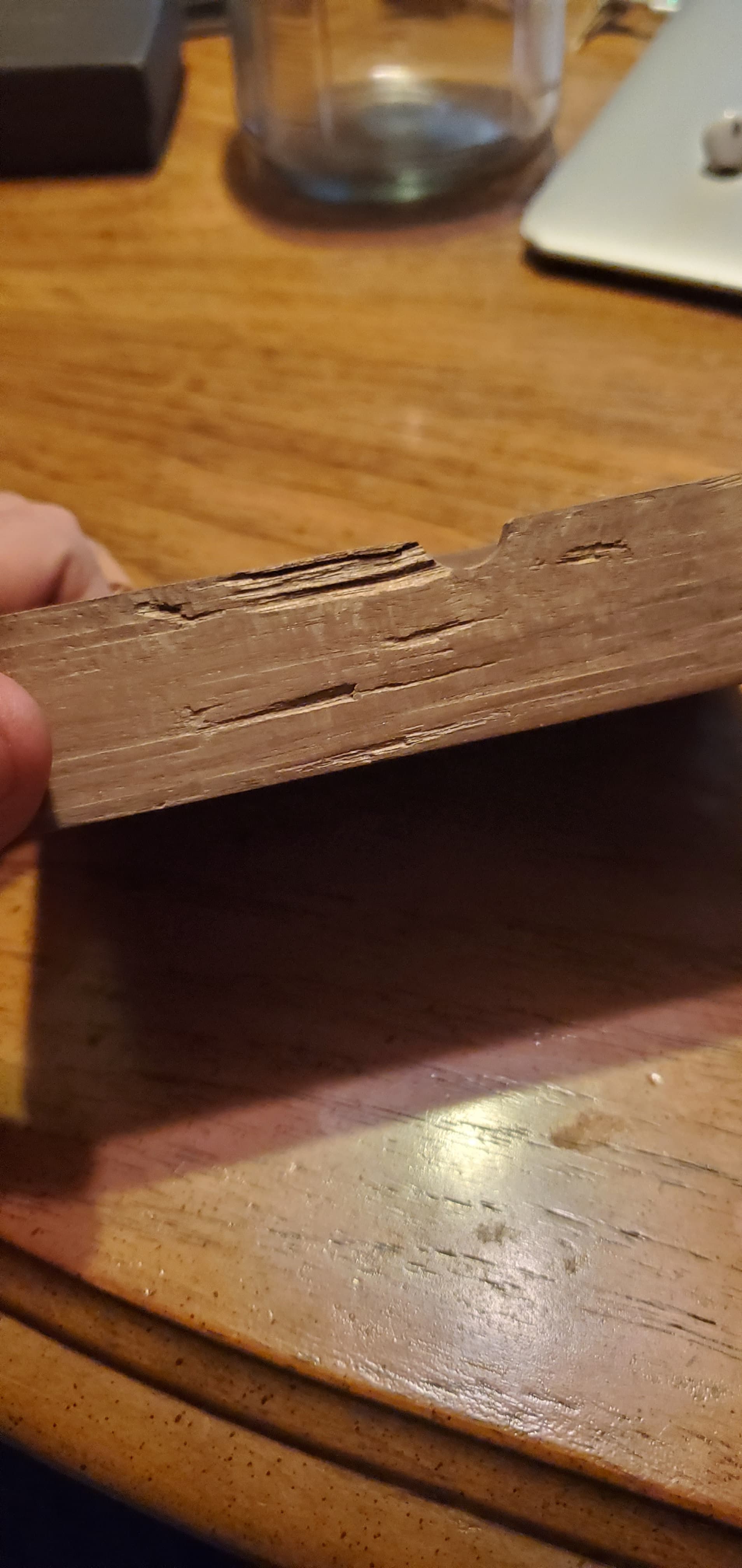

The reduction in cut depth and extra geometry worked to get the prototype i needed done today but im having trouble with the wood splintering rather than cutting at times. I wouldnt think the cutter is too dull because i havent had it long and its amana’s solid carbide 1/4in compression bit. Ive had it maybe a month with roughly 30hours cutting time. Mostly mdf if that matters. I just moved to real wood this week.
Try climb cutting instead of conventional. If you must use CC, Offset your profile outward by 0.250", and then again by another 0.050" (0.300" from part). Contour the 0.300 curve. It will conventional cut your line, but the opposite side of the bit near the part will climb cut and leave 0.050" for a finish cut. Then do the same with the 0.250" offset line to climb cut the finish cut.
Okay thats makes sense from what little i know about climb cuts but im a bit lost on how to get it done. Whats a good alternative to cc? Because I’m not sure i understand exactly what to do to get the climb cut.
Black is your outline you want to cut.
Offset that 0.250" (Green)
Offset that one (should still be selected) another 0.050" (Red)
Now contour/profile the red line (inside) using a DOC on the tool
Then contour the green line using a deeper DOC or Full depth.
The area between the green & red line is now gone, so you are only cutting with one side of the tool, and only removing 0.050. Climb cutting pushes the material into the part rather than pulling it away & chipping it out.
Okay. That makes sense, yeah. Still open to ideas beyond CC though. Im sure im going to out grow it eventually but you’ve been super helpful.
Also check the cutting length on the bit. You should have a bit that has a cutting length greater than the depth of your cut. When the cutting length is shorter than the depth of cut the chips can pack in the cut line and cause all kinds of problems. If you are not removing the chips completely when cutting this adds to the force needed to move the bit in the cut.
