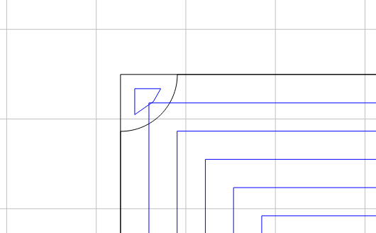

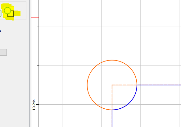

If you don’t have Rest Maching, you can do it manually.

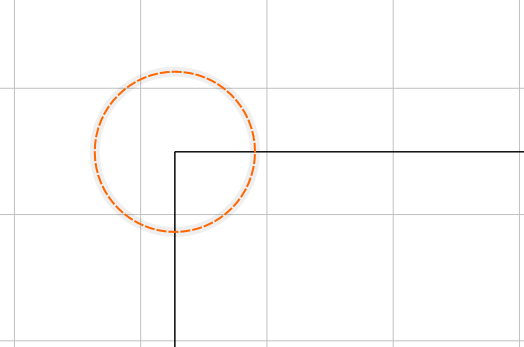

Copy the Vector, then center it onto the original. Draw a Circle .125 Diamete.r
Select the Circle’s center node and Align It with the Corner.

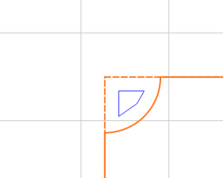

Next, Select the Circle and the Square Vectors. Circle First. Now do a Boolean subtraction.
Repeat for all Corners.
Next, go to toolpaths. Select the inner and outer Vectors, do a pocket toolpath with the .0625 tool, and your desired DOC.
Whammo.
Here’s the toolpaths with .125 for the main clearing and .0625 for the corners.
