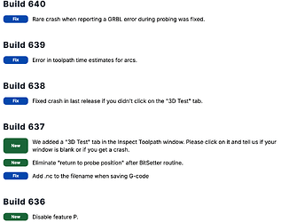

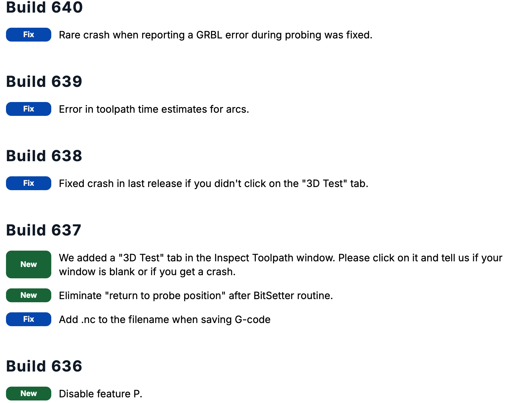

What features were added in the CM 640 build? I have gone back to 636 and while it seems to run my SO5Pro just fine, I’m wondering what features I might be missing.
I used 640 to cut a large 3D project and found that the machine would frequently hesitate for a half second or so during the cut. It behaves like the input buffer gets exhausted and the machine stops while it waits for more data. I don’t know if anyone else has had this experience. I went back to 636 and the issue disappeared.
There’s a list of features/fixes on the CM download page, here: Carbide Motion Downloads
